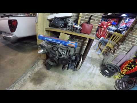

            What? I actually like the LS. It's not real pretty, but it is stout... you've seen this guy? He's motivational.

              Thanks! it's a cool project!
