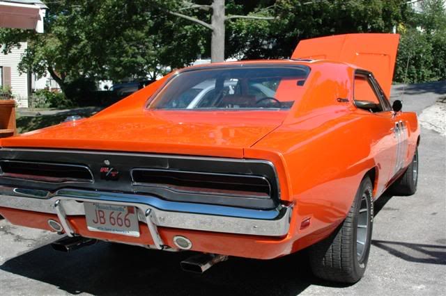

      Jon is indeed doing some amazing work. The car is beginning to look like a car again! I love going to his shop, because every time I walk in there he's accomplished 10 more things but discovered 20 more. No stone will be left unturned by the time this drives out of his shop!!!
      As for the rot hole in the front fender, painted over, there's a matching hole in the underside of the hood, so that's going to be turned into a Coke can, too.

          The only thing I wanted to clarify is that I'm not the guy who paid BK Auto to "build" this car. I am not the one with mega bucks into it (yet). I'm the guy that came in and bought it from Brian (the guy who paid BK Auto for this car) when he went broke. I got it for a fraction of what he had into it... but not cheap enough IMHO.
          I do want to thank you though, you are absolutely right about the push bar. I had told Jon it was crooked, but it would make it awfully tough to swap that grille out when I'm ready.

                  It'll be a General Lee again, this time with no decals. Jon's friend is doing all of the paint work, which is just as amazing as Jon's work. All graphics will be painted on and cleared over.
                  See, I've wanted a General since I was 10 years old.. I waited 28 years to buy one.. Then when I saw this one, my blinders were on and I snapped it up as quickly as I could. I ALMOST had it shipped up to me sight unseen.. Oh, wait.. How would that have been any different?
                  The funny part of this is, they were miracle workers with Bondo. This car LOOKED super straight...

                    Oh yeah, I'm pretty sure the word did not hit here that the "freshly rebuilt trans" was crap too. That had to be shipped off to the trans guy for a full rebuild.
                    Jon couldn't get the shifter into proper adjustment. He went down to the linkage on the side of the trans and there was 1/4 to 1/2 inch of complete slop before it started to actuate anything.
                    He then pulled the pan off and it was FULL of metal, clutch material, you name it.
                    The good news is that in moving from back to front, there's not much more left he can discover wrong!
