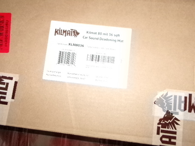

                    The stuff just got here today. I can already say it's real easy to work with. It's pliable and it's got enough glue on it to hang there but no so much that you can't move it around some before you mash on it. Warm it up with a heat gun and then work out on it with a seam roller and it's on there. I'll almost even say it's fun to work with but ask me in a few days when I'm good and sick and tired of putting it on there. And then whether or not it actually "works" will be another personal opinion further down the road. (Get it? Further down the road...hahaha)

                        It's a box full of sheets and you cut whatever shape you want. It's easy to cut to shape with household scissors or with a utility knife. There's 36 square feet in the box and the box weighs 18 pounds. It was $68 from Amazon. It took a week or so to get here.
