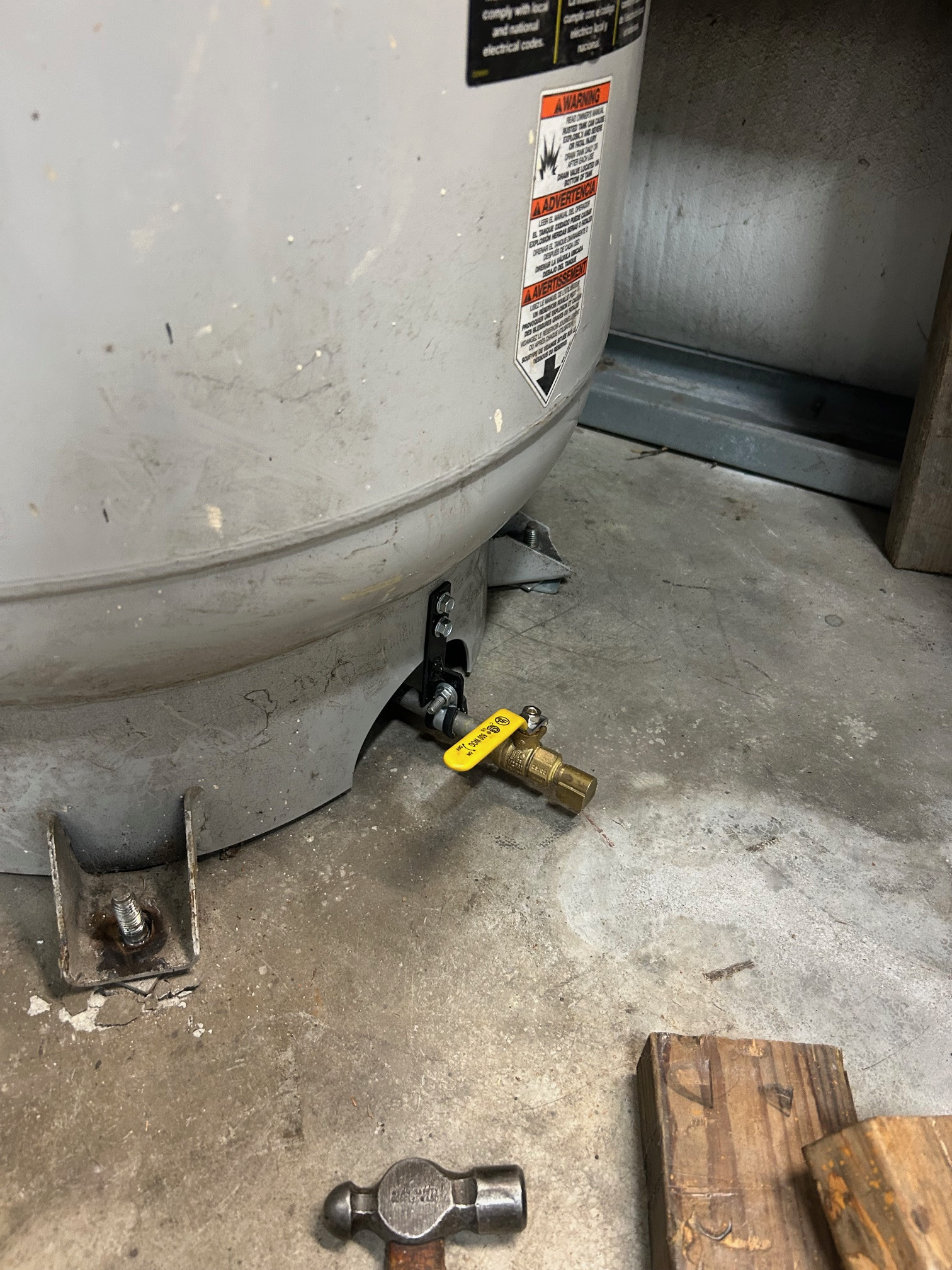

                  Anyhow, it's back on line and here's the current status:
                  The remote drain. MUCH easier to use and I know I'll be draining it out regularly now that it's easy. I also let the tank air pressure blow out the gunk which seems to work well. I'm still getting some rusty muck out of it but I assume that'll settle out as I continue to drain it. Note the support for the drain. I used SS pipe along with brass fittings - I didn't want brass pipe as it tends to be brittle and there will be vibration. Also note the nifty support for the pipe. A little steel scrap and an Adel clamp and things are supported.
