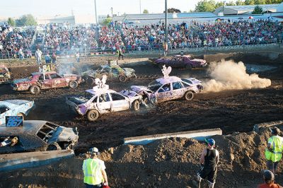

    From my week in exile, got so much great mail. A few from DB on HIS subject, demolition derby. He readies the cars, they travel to the event, and the kids drive 'em. And they win.
    Here's one where they had to square off against each other at the end. Pink chickens:

    The last two cars running in Saturday's Yamhill County Fair demolition derby were teammates -- and siblings -- Bob Martin and Susan Flemming. After eliminating the rest of the competition, they had no choice but to go at each other until Martin was crowned champion.
    From the text of DB's email, with his blessings, of course:
    Caption reads: last 2 cars standing were teammates and siblings, Bob Martin (Morton!) and Susan Flemming (Fleming)
    It was weird seeing the kids go at each other.. I always say one has to shut off cuz the cars last... She shut off cuz she had WOT and almost hit an official so she said (in her words) #### it.. It's enough..Bobby won!
    DB Rules.

    The 2 pink Caprices with the Cock and Beaver are my kids..
    Took 1-2!
    Proud of them!
