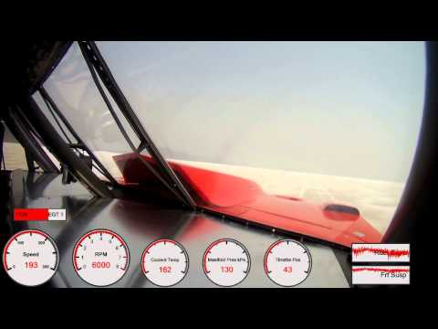

    Been slowly working through all the video footage that Randal captured (he ran our 3 video cameras at Bonneville last week, I am SO thankful to have him there because I was overloaded with debugging electronics issues).
    I haven't finished the Masterpiece yet but figured some of you might like to watch the front-view camera with the Megasquirt data overlay.
    I know there are going to be questions about the data. Fire away!

    I was noticing the throttle position, which never got over maybe 62% or so. Mine would read 110% (Keds thru the floor) if I had a way to record it. But I'm not worried about swapping ends at speed - not enough speed to make that happen.

        Guys, here are some data points for you:
        Because I know very accurately how much fuel the engine is consuming and the resulting air fuel ratio, I have a relatively accurate flywheel horsepower number. To do that ~275mph number Lee applied 985hp at the flywheel. This is not corrected for sea level, and God bless turbochargers and intercoolers that allow us to "bring our own atmosphere"
        The car is slicker than our guys estimated.
        As the tuner, and working with the builders (seriously, the Barton family are simply The Best), we feel that we can do 1900-2100hp continuous before running into other issues.
        I have no clue what the limit is for traction. The good news is, that's the job of Ryan Fain who is an expert chassis tuner (think 2400hp street cars that dead-hook in the rain)... I have faith that he can put down whatever he says he can.
        The other thing I'd like to point out is all the LSR Experts seem focused on Frontal Area and Coefficient of Drag. My own personal opinion is that Traction and Horsepower can overcome both of those numbers (we were told by many Experts that this car woudl hit the brick wall at 260mph or less).
        What's most importantto me is YAW STABILITY. Ever notice how many fast cars spin at speed on the salt? that's a lack of Yaw Stability and it doesn't matter how much power or traction you think you have, if your car isn't set up to be stable at speed - no matter how many wind tunnel trips you took - you're going to be spinning instead of winning.

              Freaking awesome. What are the suspension graphs? x xdot or x double dot? Is engine temp going to be an issue with more oats dialed in? It seemed to climb a bit as the hemi topped 7K rpm. Ive watched it 3 times so far...

                  I thought gears were more towards kugels video versus the many shiftings in the daytona. Is this just for now as 300 will need something to bring it off of the 212F 8k rpm.

                            BKB the suspension graphs are Linear Travel in inches, but the fronts are NOT linear (I forget the scale). The rear are indeed linear (travel sensor moves an inch means the axle moved an inch).
                            The suspension data when applied to the coil spring rates in the front show the same thing the Chrysler engineers documented so well in an SAE paper (that we downloaded for $37, instead of spending thousands on a wind tunnel test). We have well over 1000 lbs of downforce on the front, and that's a bit of a problem as it's all right on the leading edge of the car's nose, a relatively wimpy fiberglass piece. Thinking about this, it changes the balance of the car at speed (good thing! we are more rear weight biased thatn we'd hoped), but the bad news is that it's quickly exceeding the weight rating of the front tires. We are making changes to the car's attitude as the Chrysler engineers did in 1970 on the Speedway version of this body. Lower the rear dramatically reduces downforce on the fronts, so they say - I have no reason to doubt them at this point, as our own data matches theirs almost to the T.
                            The suspension travel also showed us how much travel you need at Bonneville. It's more than most people think. It makes me more impressed at the guys with NO suspension that are still going fast...!
