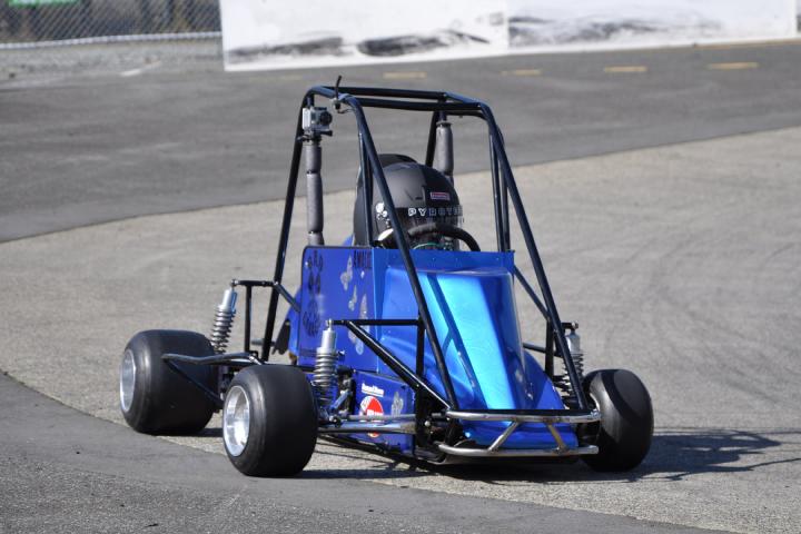

    If it is the same as duplicolor, that is what my daughter's race car was painted with. First time I have ever used a spray gun, don't think it turned out too bad (granted it is easier to spray a tiny car than a full sized one)
