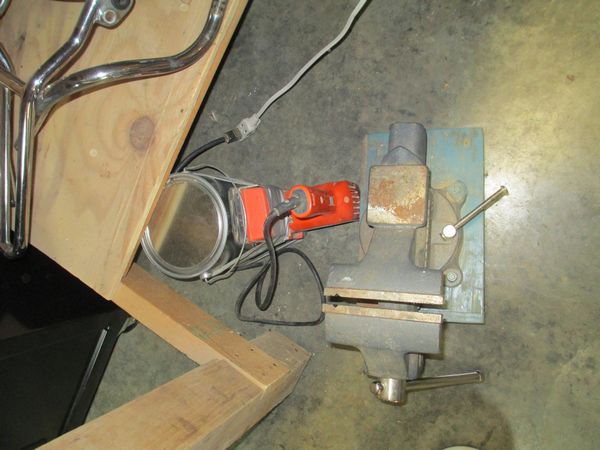

                  Dad and I had to clean a motorcycle carb. He used an old sander taped to paint can. Used Simple Green for a solvent, made lots of noise but worked ok.

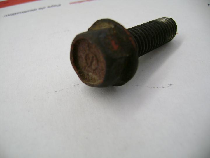

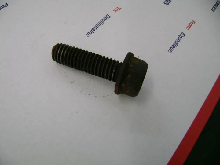

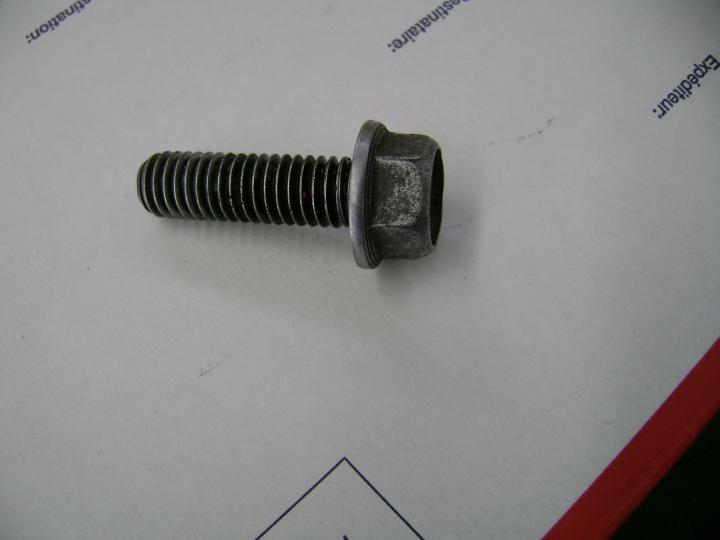

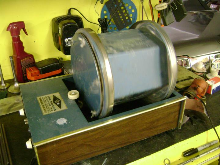

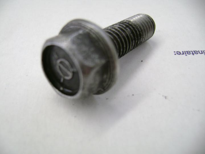

                          So, here's what we got. $15 media (w/25% coupon) from HF and some water with dish washing soap over night (maybe 16 hrs). I'll try during the day next time to see if I coulda saved some wear of the machine by checking sooner. I'm happy! Thoughts?
                          STUGOTS
                            • 28520
                            Looks like it worked pretty well. I like Lon's system, too and I have the raw materials.
