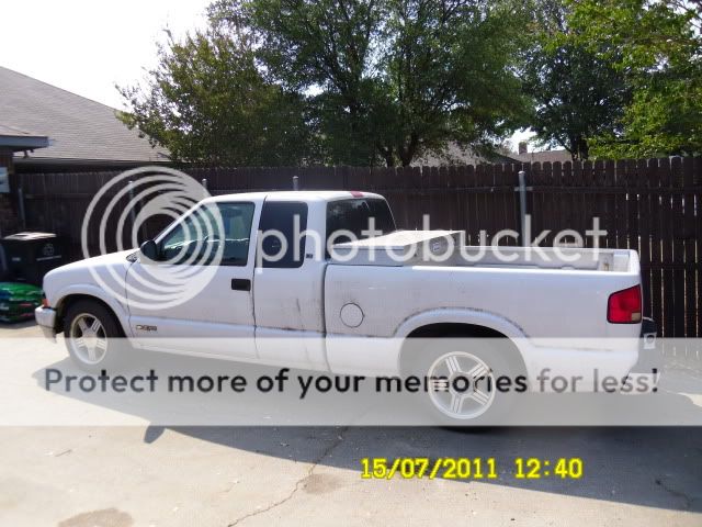

                      s-10 z09(iirc) wheels are 16" alum.. and are basicly 91-92 Camaro front wheels.. I' can look around the 4 yards near me. but shipping would kill it.. I'd hit your local yard.. should not ne hard to find2) 3rd gen f bodyFRONT wheels..
                        truck is filthy, but these are pretty easy to spot and are stock 16's...
