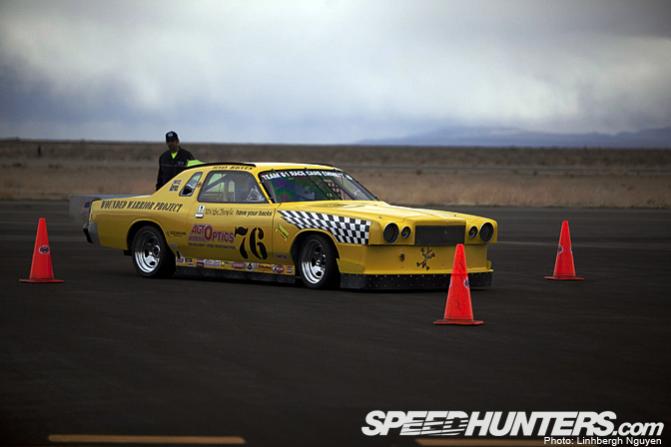

                    If you have any sort of frontal downforce, it'll compress the front suspension at the top end, AND allow for bumps at speed.
                    At Mojave in '10 I scraped off 1/2 inch just from downforce, no bumps.

                      Yella Brick, what was you height with the car at rest?
                      • YELLA BRICK
                        • Dec 2008
                        • 170
                        2.0 inches
