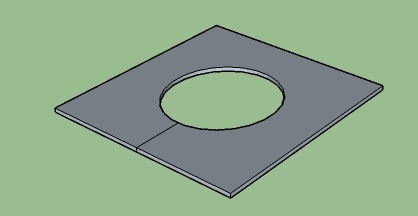

  • The bar is already installed, the main hoop is on plates. I am just trying to seal the floor.
    • ah, sorry. I'm an idiot.
      Are you saying seal it up around the bar? Like a cover plate? Cope with me for a minute, but I'm having a mental block with the thought of a butt joint of thin sheet metal being joined well to the bar.
      Maybe a cardboard template to get the angle/shape of the bar right and then a cut a sheetmetal cover with split fuel line around the edge to seal it? Click image for larger version

      • Maybe something like that. I more or less want to know if get the floor boards close to the bar then caulk it with fire proof caulk will it be good enough?
        • I think a small gap and fireproof caulk should be OK - but I'd send Keith an Email just to be sure. Vic would know, too. I'd say Jerry but I don't know how to get a hold of him. The ones in the Camaro and Mutt have plates welded to the bars at that point so mine are a bit different.
