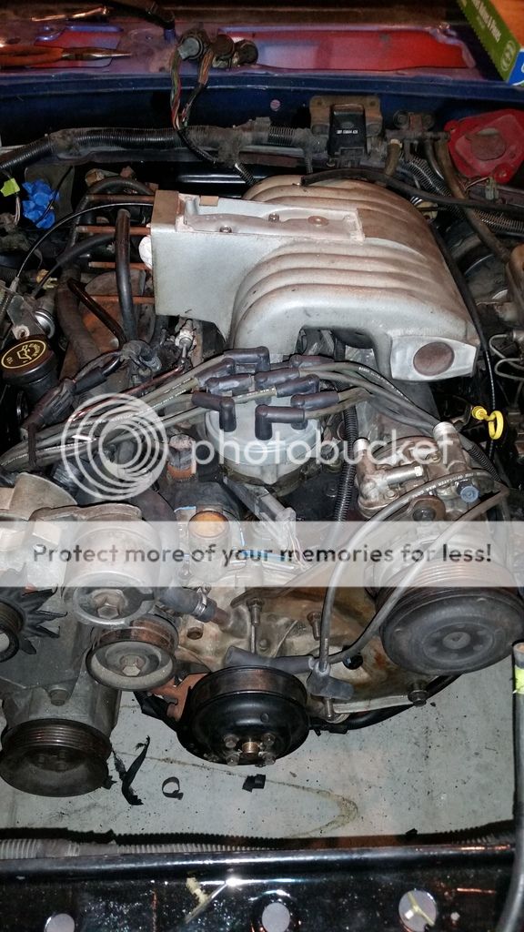

  • I have not felt like working on the suspension so tonight I did engine stuff, installed ground wire, O2 harness, low oil sender, thermostat, upper intake, and heater hoses, and charcoal evacuation line. For the last week I have not been able to find the starter bolts. As I was about to give up looking for the night I remember I hid a bunch of stuff in the closet the other day before I had guest over. Sure enough they were in the box with the headers. Got to love bagging and labeling bolts then can't find the bag!
    While I was getting my long lost bolts I looked at the dash I pulled out of the 87 and the answer to the missing plug was right there. Quick Google search, coolent fan relay.

            • Saturday I was out of town, Sunday I didn't do anything. Got a few things done today. Starter is on, EGR and TB, I think it looks like a 5.0 now
              • This car has a manual rack, so I was going to delete the power steering. The pulley belt combo that I have that deletes PS uses a very small race pulley. I wonder how bad that will effect my AC
