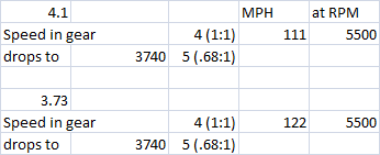

                  The RPM drop is going to be the same, instead of going 1:1 , you're going .68:1 Click image for larger version
                  those are 28" tire numbers. I'd bet it will pull 5th with the 4.10's better than the 3.73's and definitely outdo 4th.

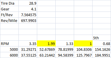

                      perfect world math on a 275 60 15 is damn near 29" ... so there is the real world fitment!
                      about 4875 rpm in 5th to go 150 with that setup.
