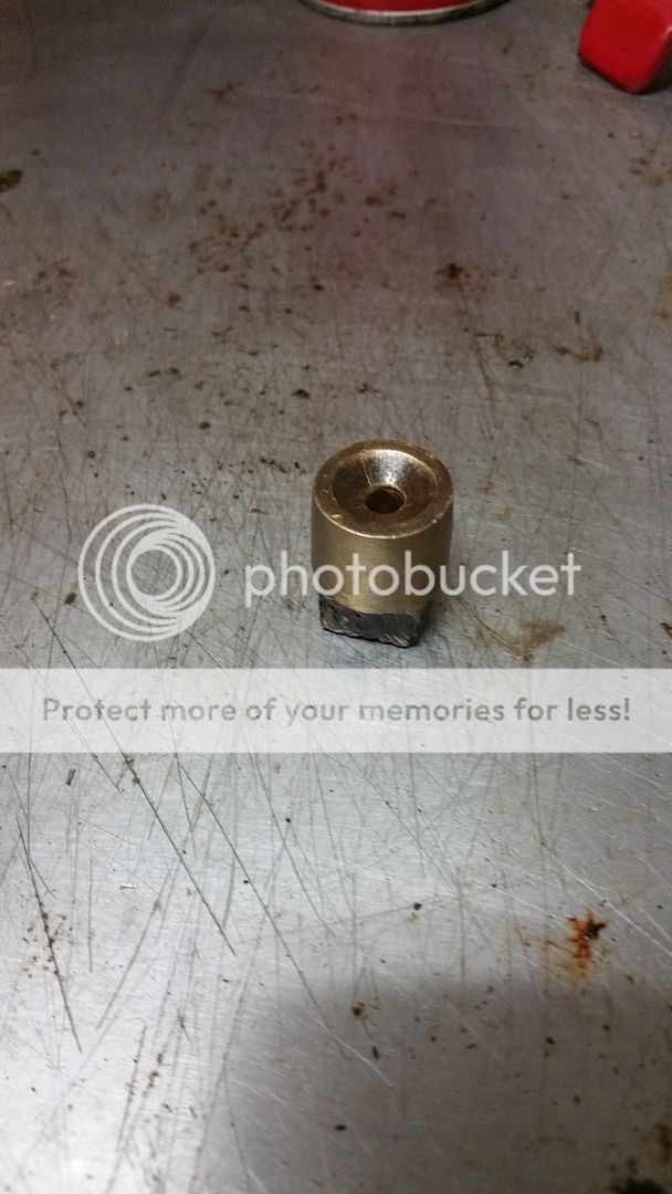

    From what I have read on the Internet you have to use a ford heater core ($83 from rock auto) and a flow restrictor I made one from an old brass plug.
