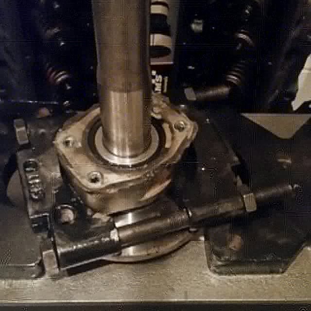

I need to rebuild or replace a Moser c-clip eliminator tried to press it off seems like my cheap bearing separator is bending instead of separating. Do I have it set up right? Tips, tricks? Heat? Cold?
I did get it to move a little in the press. I put the whole deal in the deep freezer. Then hit the bearing with the propane torch. And it started to move. Then the axle flange hit the press frame. I couldn't find a good set of blocks to lift the arbor plats so I just cut it off. If the press was wide enough for the axle flange to pass through I think it would have worked. Summit is sending a new one.

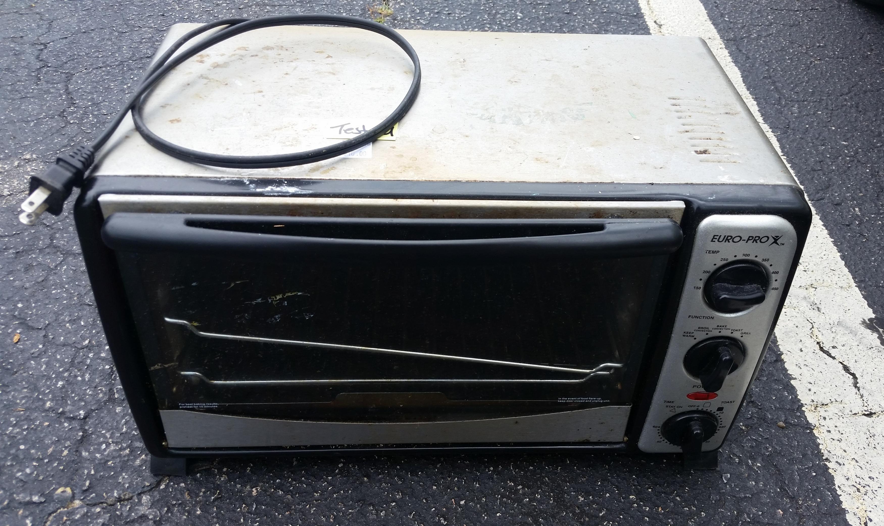

I went to the habitat store and picked up a bearing oven. Axle has been in the freezer for a couple
days. I think I will bake it @ 200* for an hour. Don't want tomelt the plastic inside

Made a list and been chipping away at it. Cut off the old c-clip eliminator and pressed a new one on last night I froze the axle and baked the eliminator @ 200* for 90 mins. Went ttogether pretty smooth, fingers crossed it's correct.

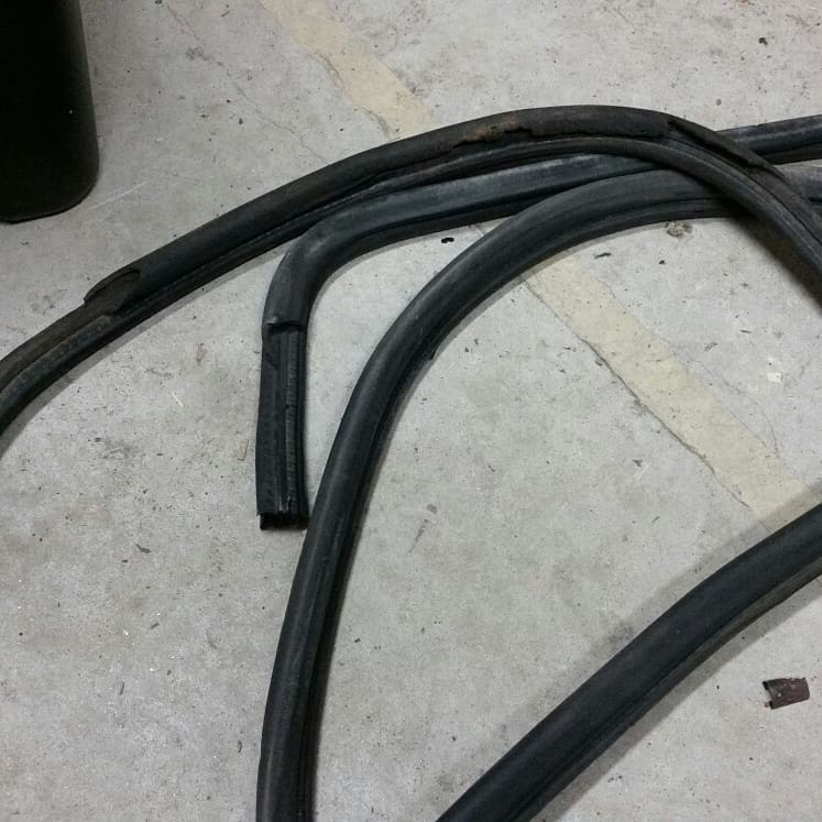

Originally posted by SuperBuickGuy View Postit's never a good idea to rush a repair.
rubber needs to age properly to get a good seal
notice you didn't bother with the passenger side
Tonight I decided to wash the car it really needed it it have been putting it off. But it's not on the 17 day critical path to DW, so ADD might be involved. The other excuse was see if it leaks. Answer much less. Rear quarter window leaks alittle and the corner of the door glass leaks some.
