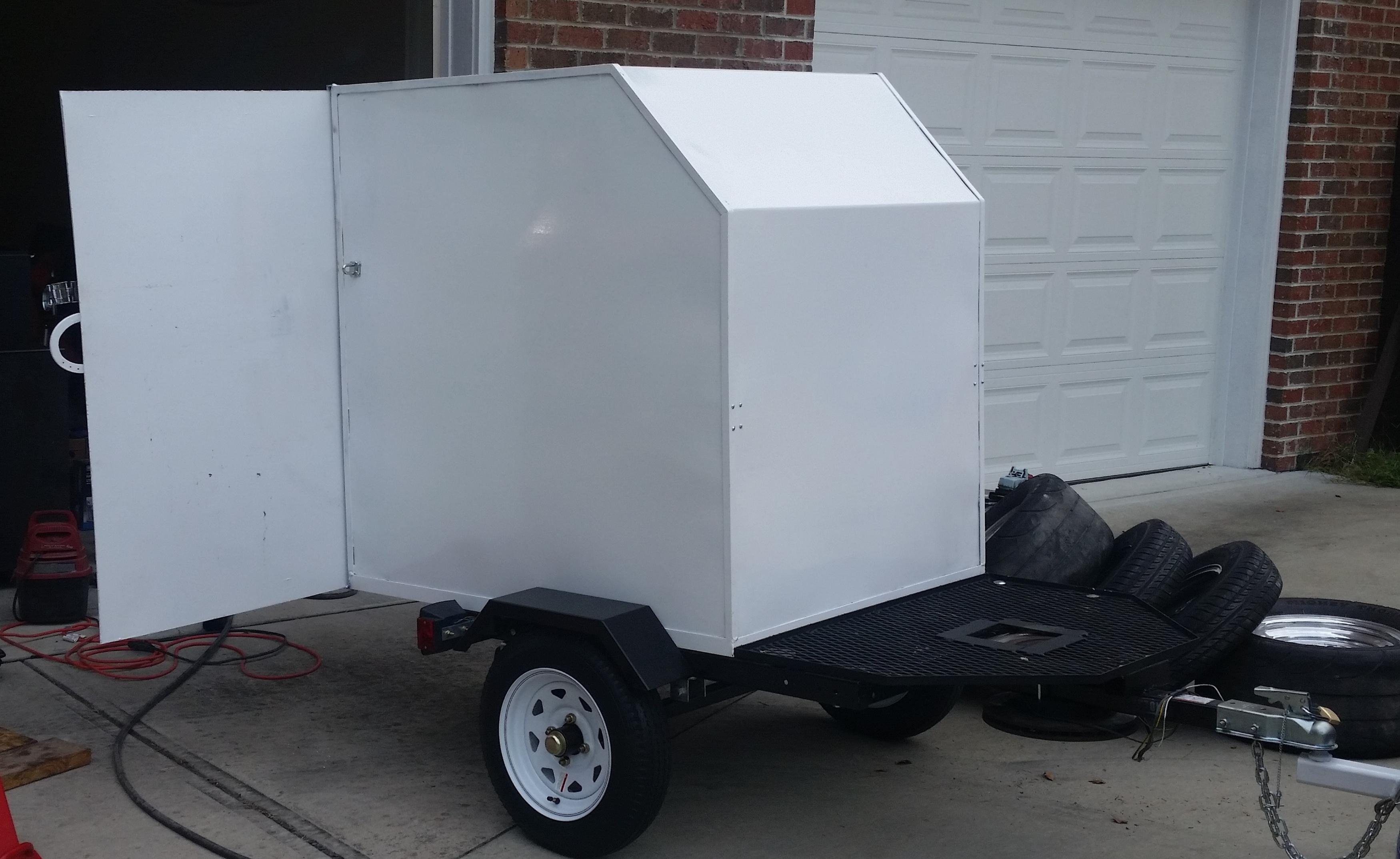

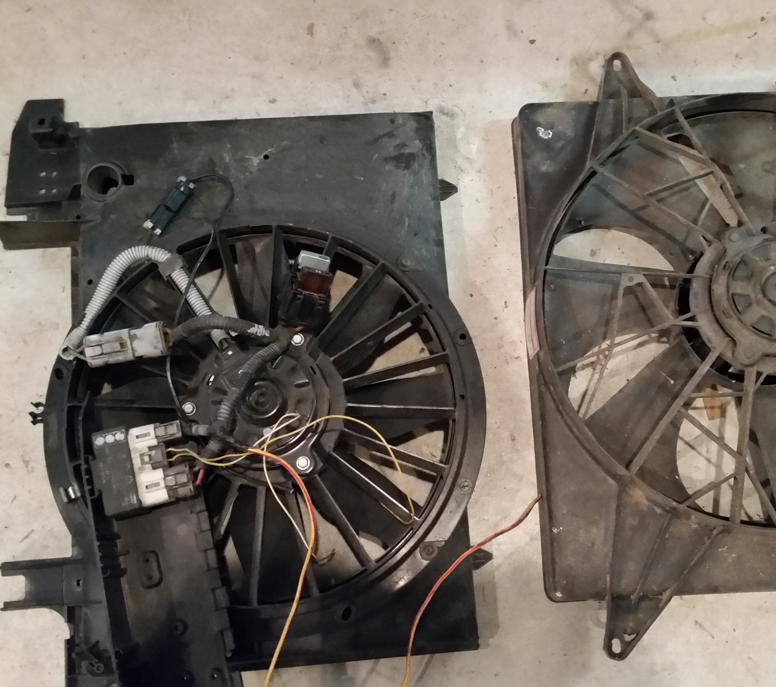

      Been working on the trailer mostly the last few days. The electric fan is not critical path so it's install will probably be post (during?) dw.
      Wanted to ask the electrical guys like silver_bullet about hooking up a Volvo fan with two speed relay and fuses on the left, 4.6 tbird fan on the right for size comparison. The volvo fan has 30a fuse low and 35 am high between control relay and motor. Does the relay input need to be (fused) sized correctly or would I be ok hooking it up the the alternator side of the 175a mega fuse.
      Do you all think it will keep a stock 5.0 cool? Click image for larger version

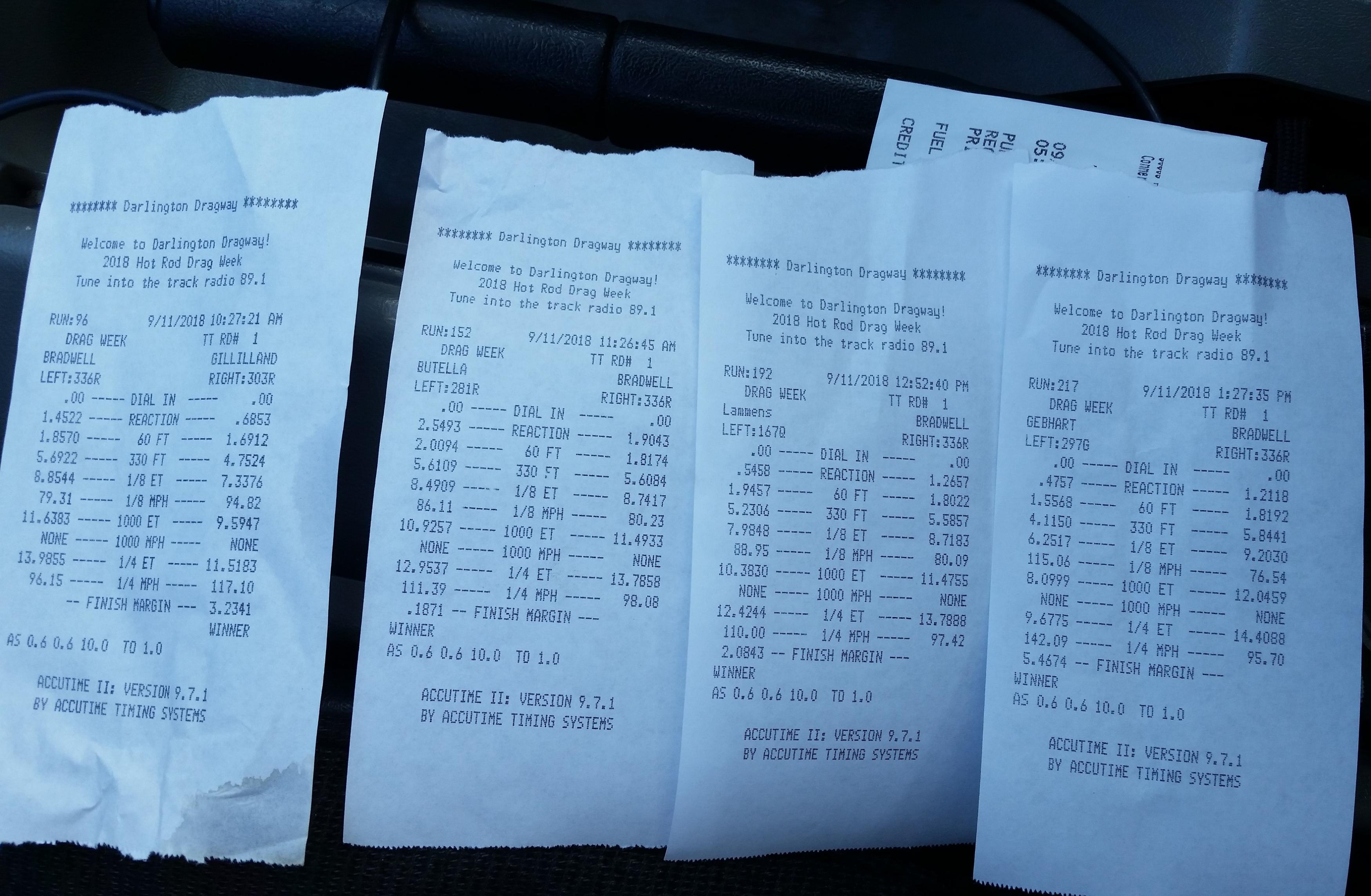

          Dragweek! Got rained out on Monday. In Atlanta. The drive to Darlington was not too bad. Missed a few turns on the route but got turned around and made it. Made 4 passes at Darlington track was hooking (they all were all week) 13.78 @ 98.08!

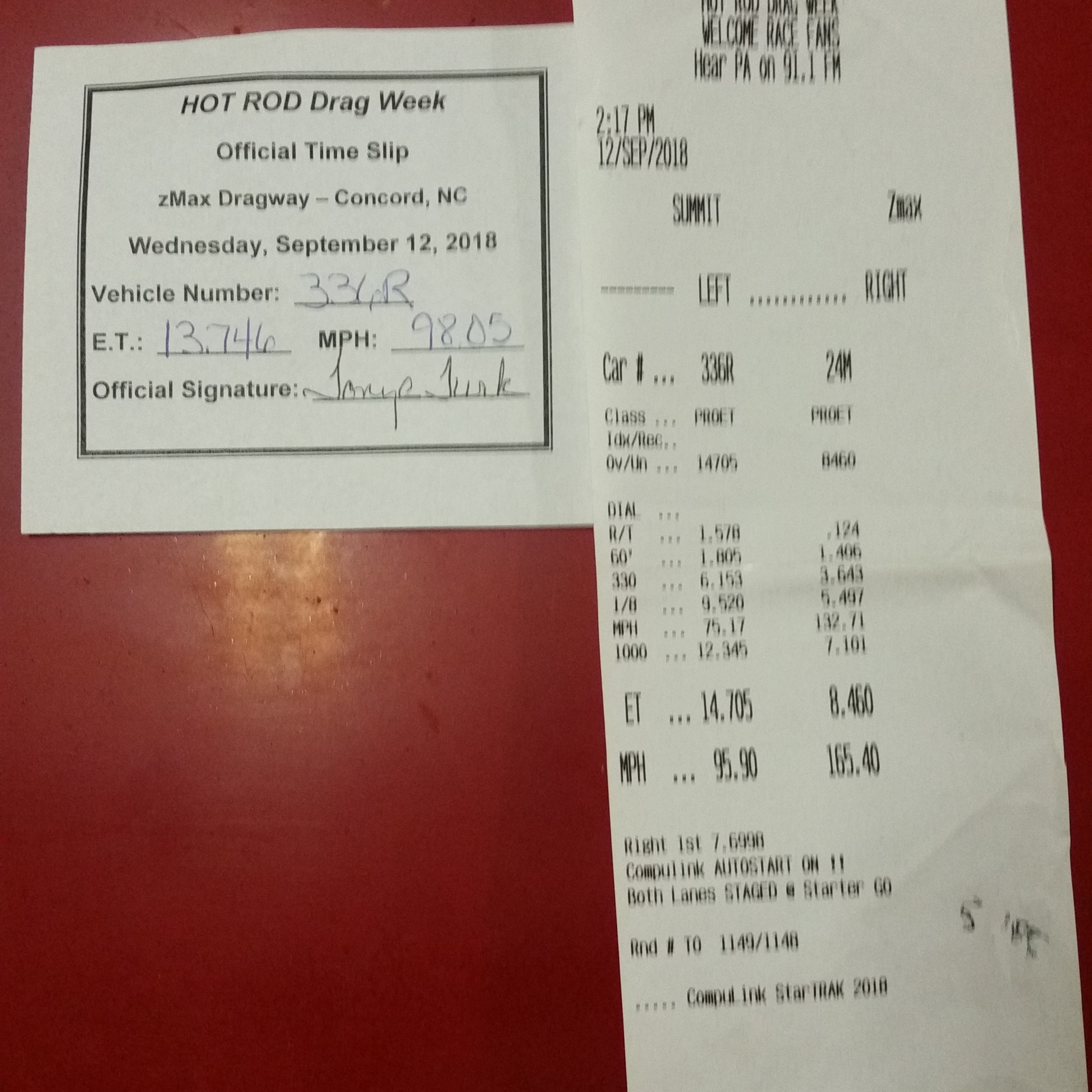

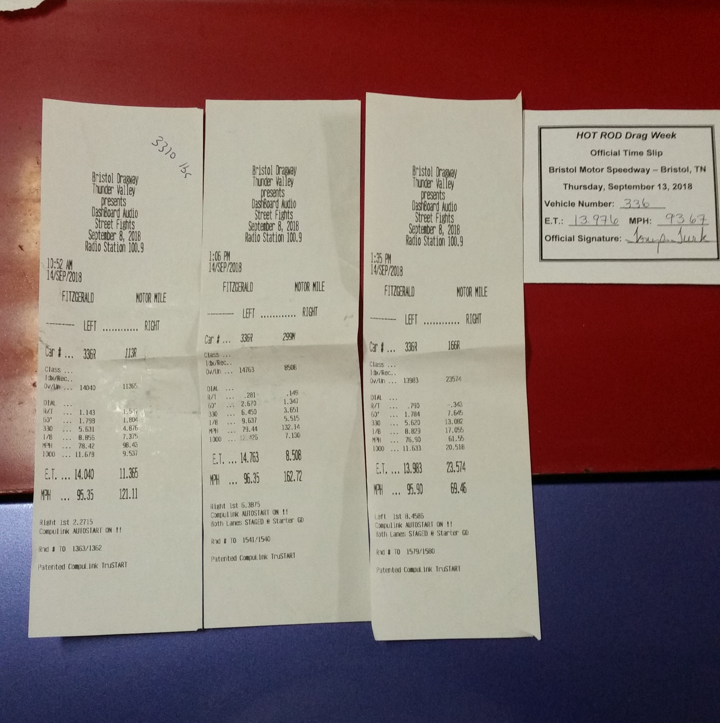

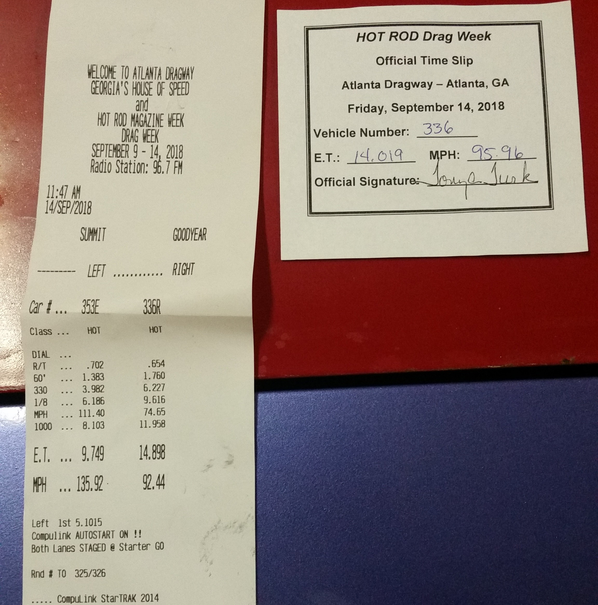

          WE got to take any way we wanted to get to zMAX. The route went towards the storm. Only made 2 passes. First was a tick better than the day before 13.74 @ 98.05 2nd I missed third. Packed it up headed to Bristol, this was a find you own way day car did fine in the hills. Car was slower I blamed it on the elevation. Pulled spare tire jack and fan (100 lbs) and was able to get it in the 13's (.97) @93.67. The route back to Atlanta was almost the direct route so i didn't get lost which was nice. My first time down the Atlanta 2nd gear was a no show pulled around got back in line and got all the gears and got a 14.01 @ 95.96 I really wanted a 13 but I was hot the cat was hot so I turned in my slip and packed up.

                    My favorite part is making passes, very nice tracks, well prepared. I enjoy seeing the cars, talking to the people. I enjoy the drives between, wish their were less turns easier to find and I would be fine if it was 500 to 1000 miles for the week. Seeing Pat Musi shop was cool. Things I didn't enjoy were changing tires, unloading loading the trailer, trying to make u-turns in a car with a spool pulling a trailer that doesn't back well.

                      Finished up the electric fan install. I cut down the shroud and added some tabs to bolt it in the stock location, and mounted the over flow tank near the stock location on a volvo fan. I kept the stock relay and fuses. It was pretty easy to wire. Power, ground and switched ground to turn it on. When I replaced the head light switch I got one with fog lights. I don't have fog lights so I used it to turn on the fan. The extra load did seem to pull on the alternator so I swapped the race crank pulley for the stock one and put the race crank back on the shelf.
