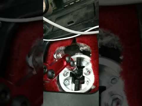

    • I have heard of automatics coming out of the case. Didn't know it was a thing with manuals?
      • I was kidding.. sort of... You've heard 3rd gear rattling in a T5? Sounds like it's going to come through the floor at you.
        • Originally posted by Beagle View Post
          Nope, still rocking the same T5 sense 2004 ish? When it was in the 89 I took it to get the front end aligned. The guy test drove it and said "I couldn't get it in gear". My Dad's response was "my son races that thing" I say "your not riping it hard enough". It's been on borrowed time for over a decade.
          I have a spare on the bench (was the one I had in the Capri) but second gear synchro
          ​is pretty chewed up. I was playing with it last year when I put the top cover on I don't think I got the forks correct it's locked up now need to open it back up and try again.
          • Is that the moment where you tell him "That's because you were granny shifting instead of double clutching like you should" and then try and keep a straight face?
            • Lovely T5 noises!.
