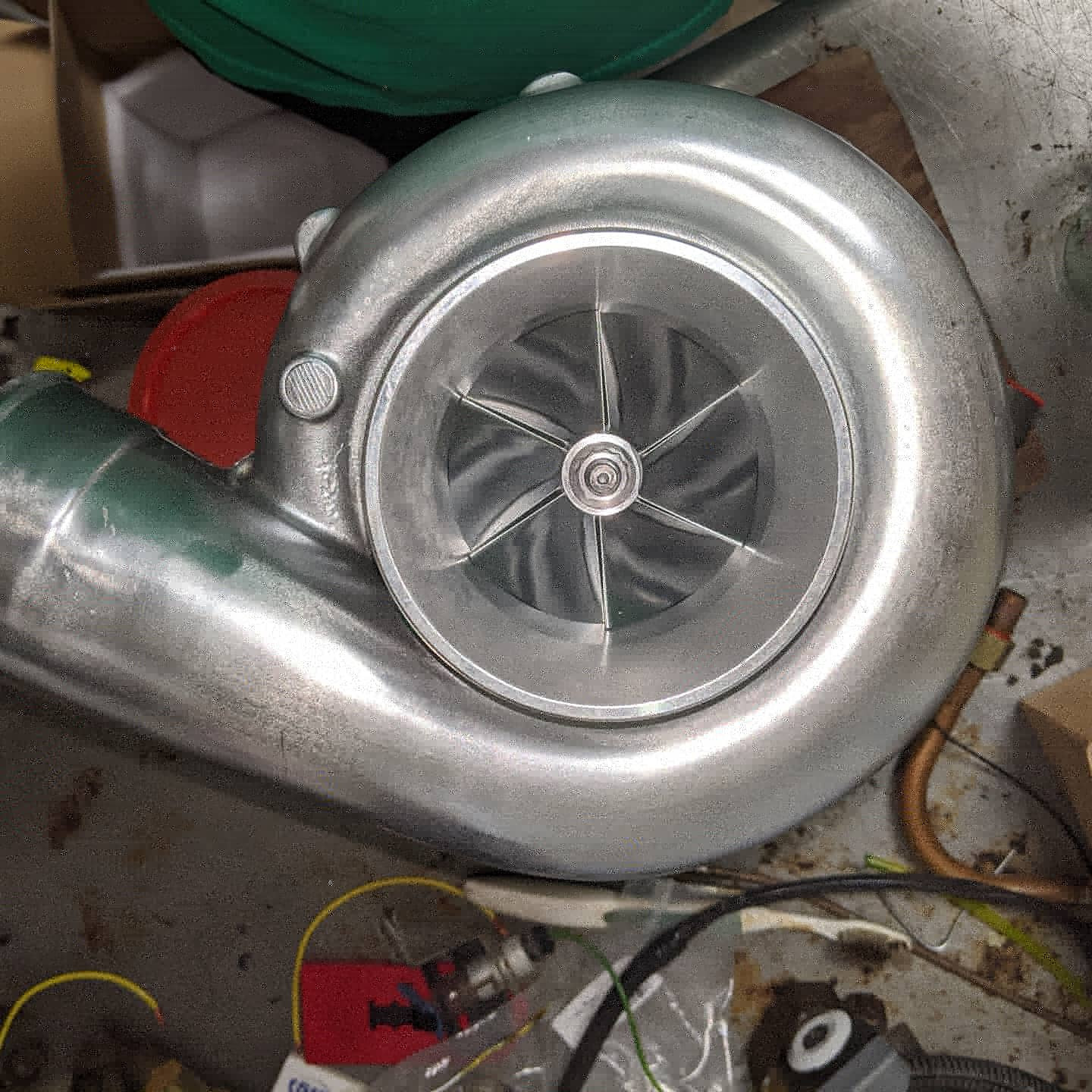

    I was looking under the hood. From what it looks like the GT45 will be a tight fit. Is there another smaller sized turbo that will work well for a little more money but be easier to fit?

          • I am still in buying parts mode. Turbo showed up yesterday. If you have 8 mins of you life that you don't want to ever get back: https://youtu.be/2A9NW2bnrvM

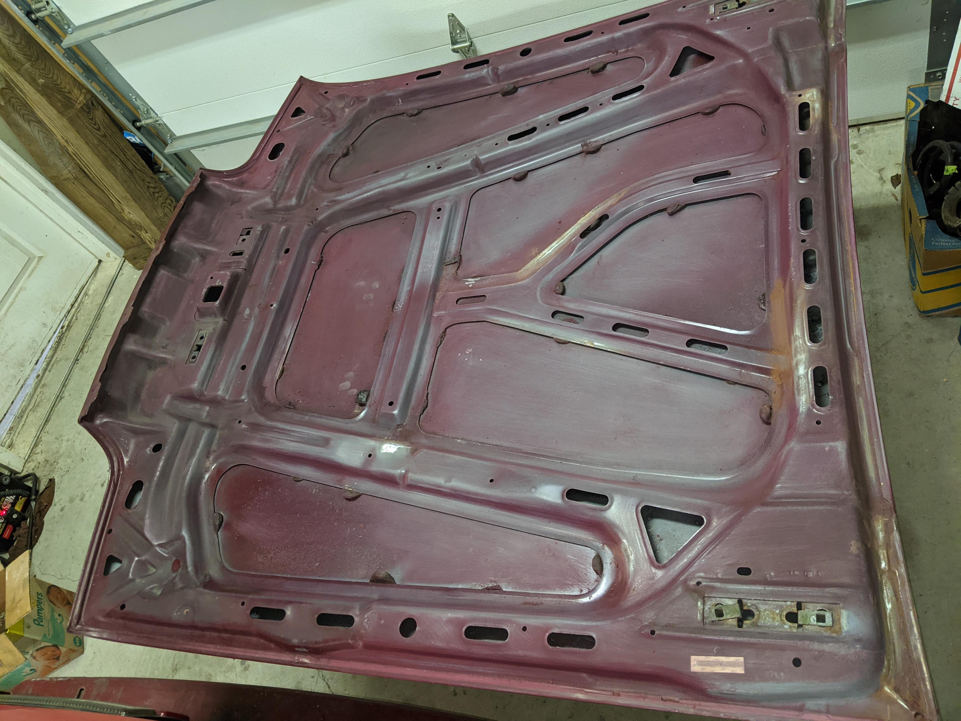

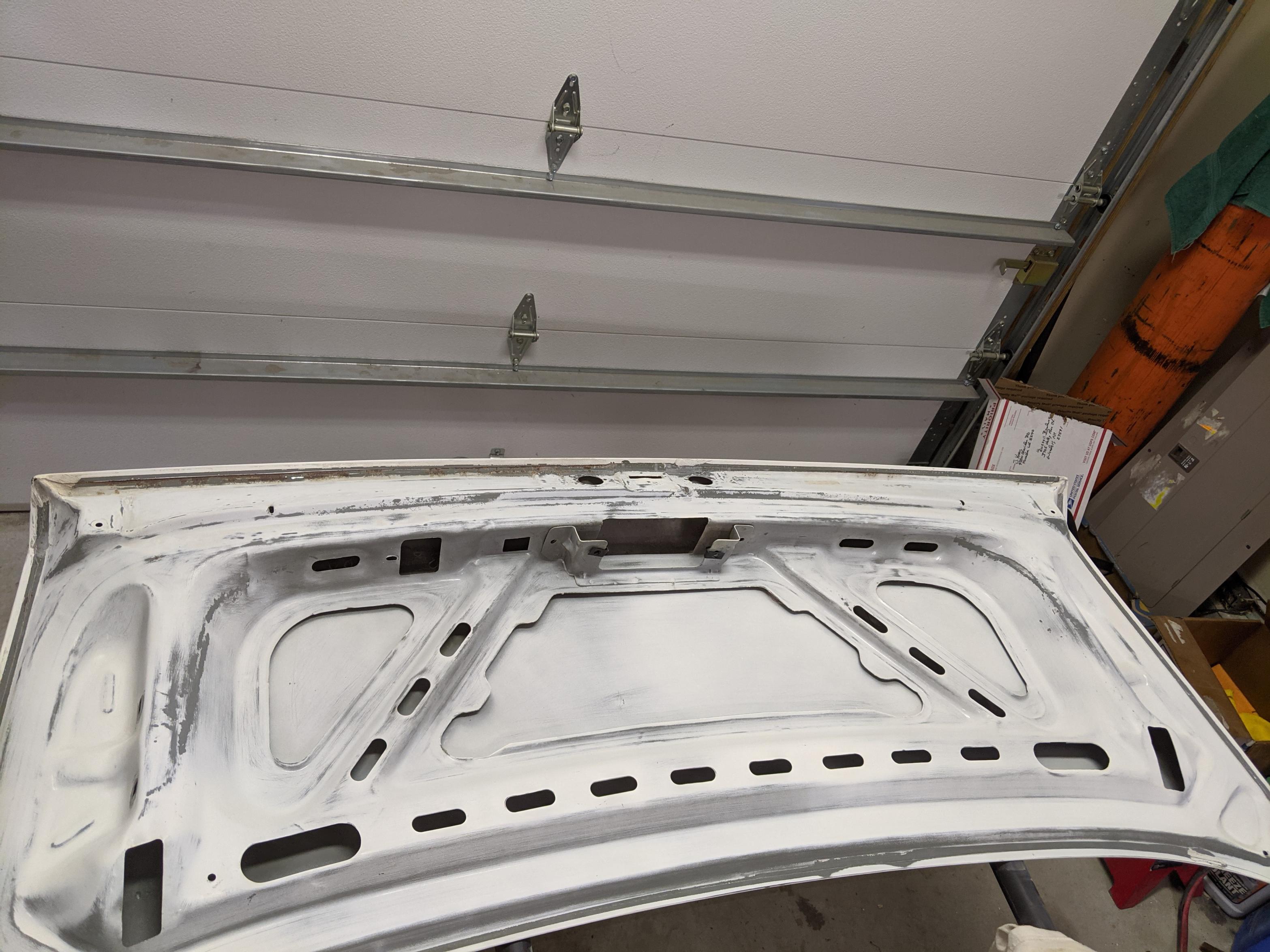

                      • I have been doing some sanding and scuffing on the hood and trunk lid. There is a little rust I was thinking about using some rust converter.
                        ​​​​​​ 1) Is rust converter all the same or is there a preferred brand?
                        2) will be time to buy primer soon, I might look into paint guns or I might try the $10 one I got from HF.
                        • 1) phosphorous zinc is rust converter.... brand name means little. With that said, some come in a more gel-like substance and that can be useful in certain situations
                          2) HF $10 guns are made for primer.... I keep a half dozen as back stock ...
                          • I'm with SBG - self-etching primer (zinc and acid based) is the best first coat. Not fond of "encapsulating" rust - just sand out as much as possible and let the self-etching eat into it for a primary substrate.
                            • They don't have a lot of rust I think it's all on the underside, I got the 1/4" air grinder out with. Red disc. Man I like the 2 stage compressor! It eats the rust pretty good I think I can get it out I mio not have to treat it. But the seams are the worst.
