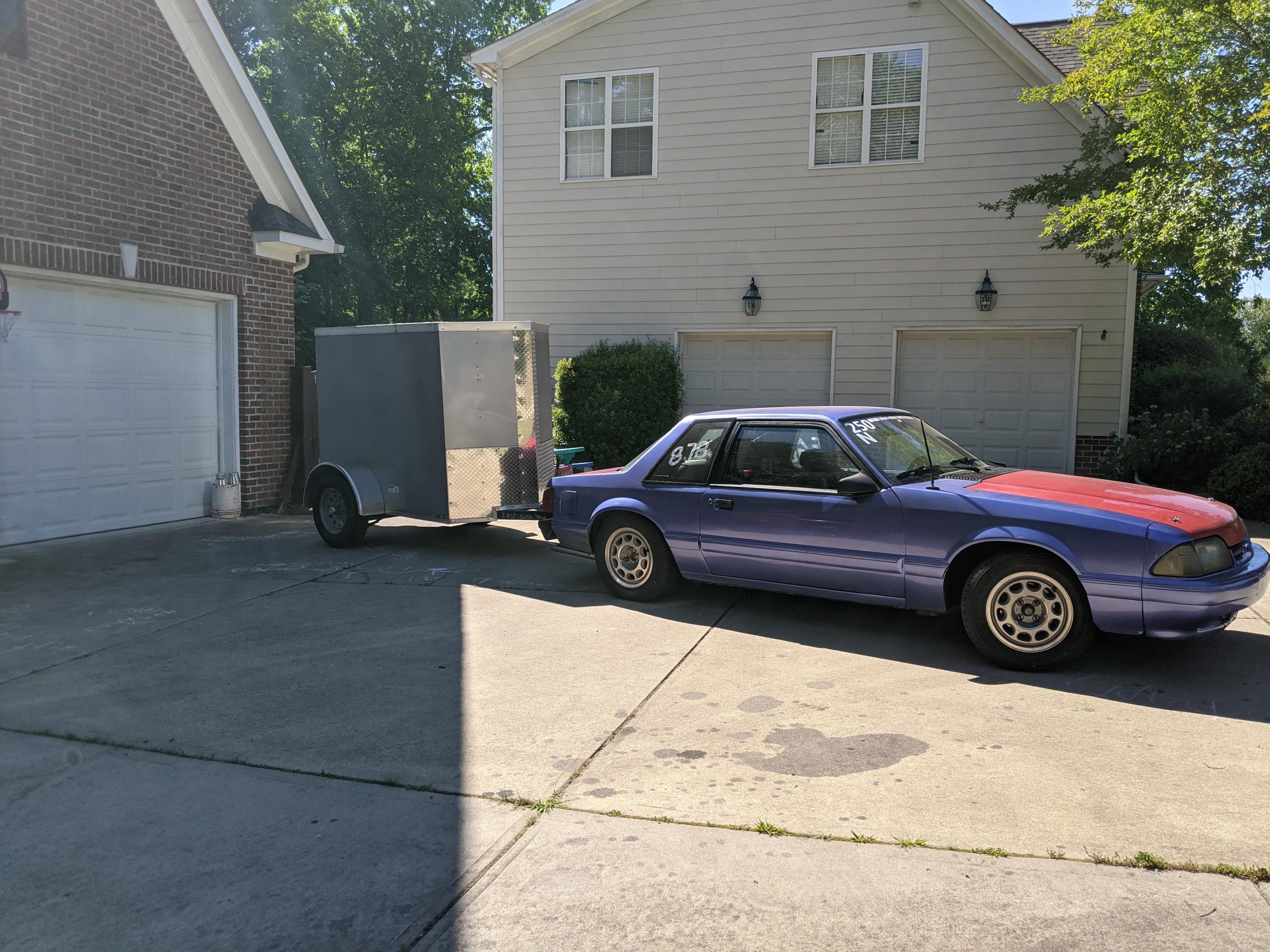

                                I loaded up the trailer and mad it to the track Friday night first pass was the best (1.70, 8.66) of the night. But I was happy the car ran what i expected it. I entered the bracket race won the first round on a red light and lost the second by the same. Time to pull the exhaust and start on the hot side!
