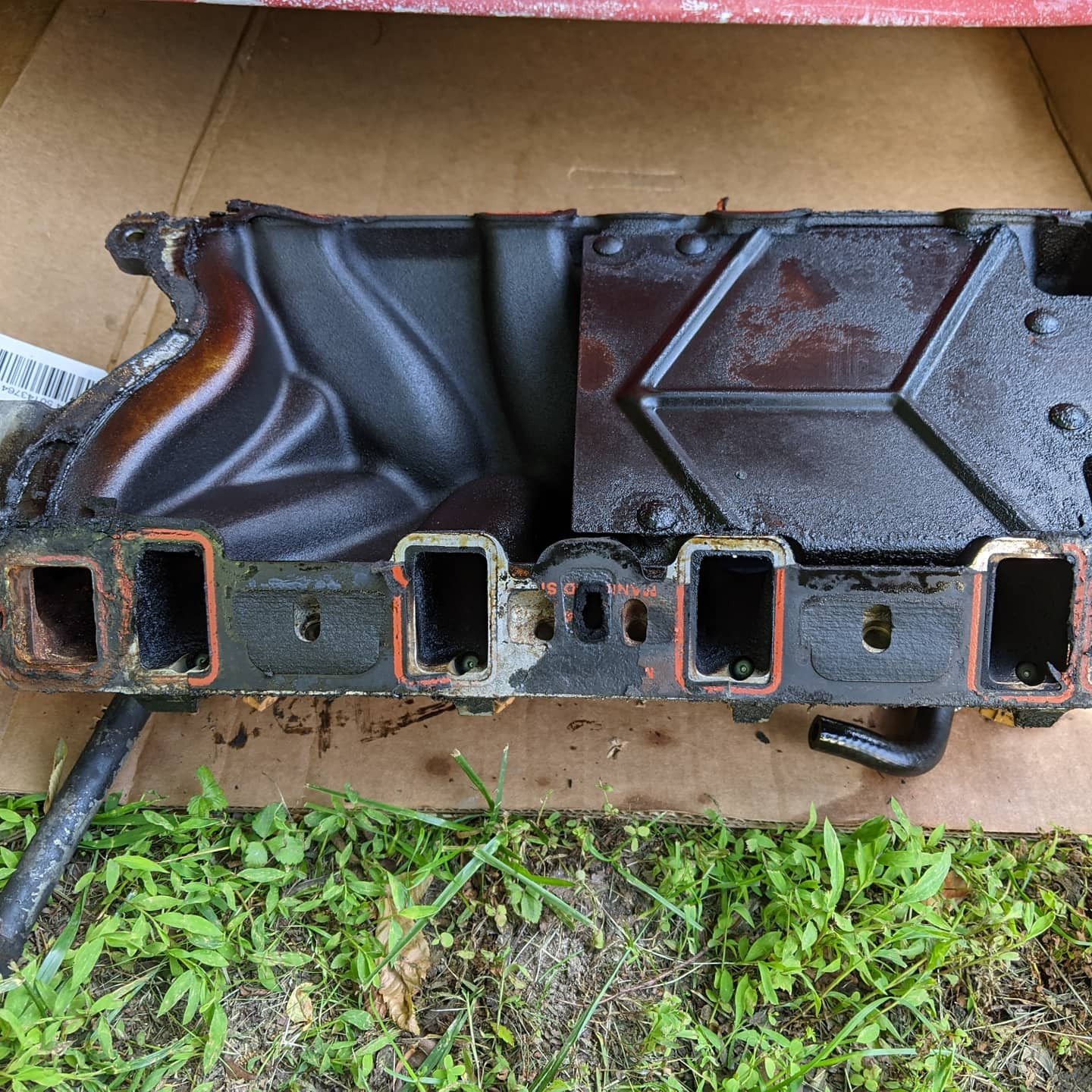

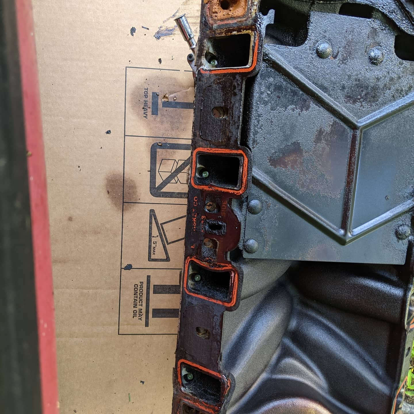

        what am I looking at here ?
        • Originally posted by langleylad View Post
          The underside of a 5.8L GT40 intake manifold with bad gaskets....
            The text was about the truck in general. I swept the bed of the truck, and started cleaning the cab.
            Ok , I thought it might be but I thought you hadn’t started opening it up. I’ve never seen anything quite like it before.

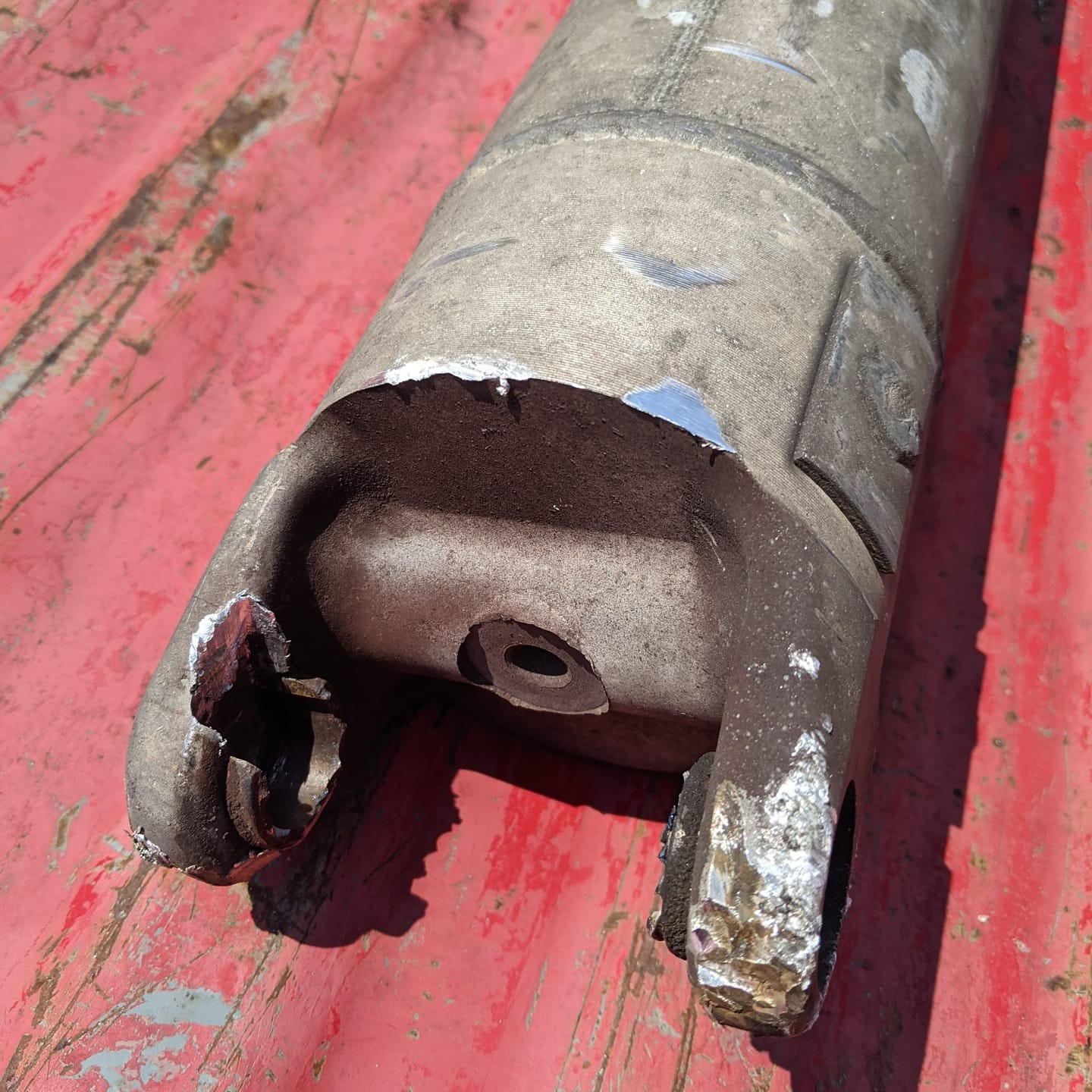

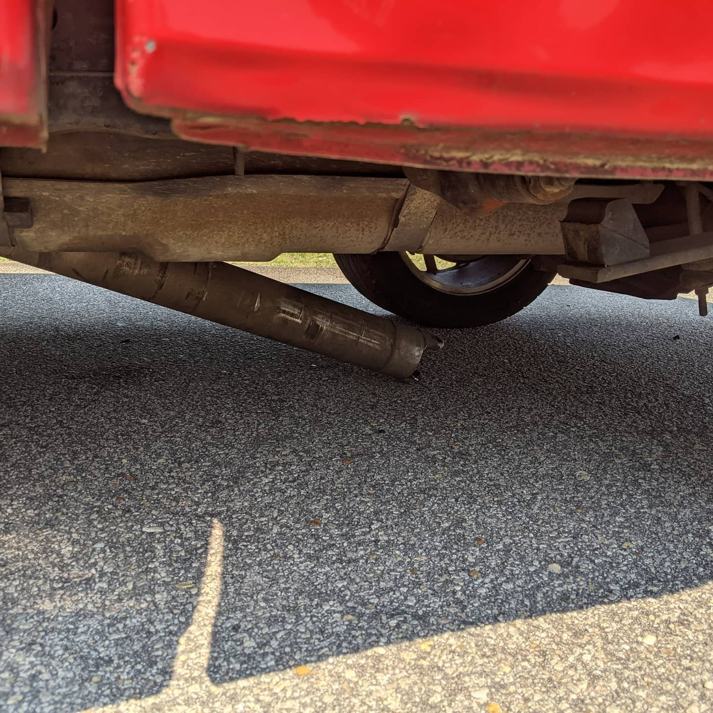

                • I think I found that noise
                  • oh shit - that's a high dollar shaft last time I looked ... aluminum, and I bet they don't sell them any more. Might be worth taking to a driveshaft shop.
                    • I went and picked up a steel F150 driveshaft to get the truck back on the move. So far so good. The brakes are spongy so in need to figure that out. I need to get back on my diy turbo install on Foxbody. I want to fix all the little things clean it up and enjoy it but there are a lot of little things. If anyone wants a project I might let it go it's very distracting, running, sitting there saying work on me while the mustang is in jackstand jail.

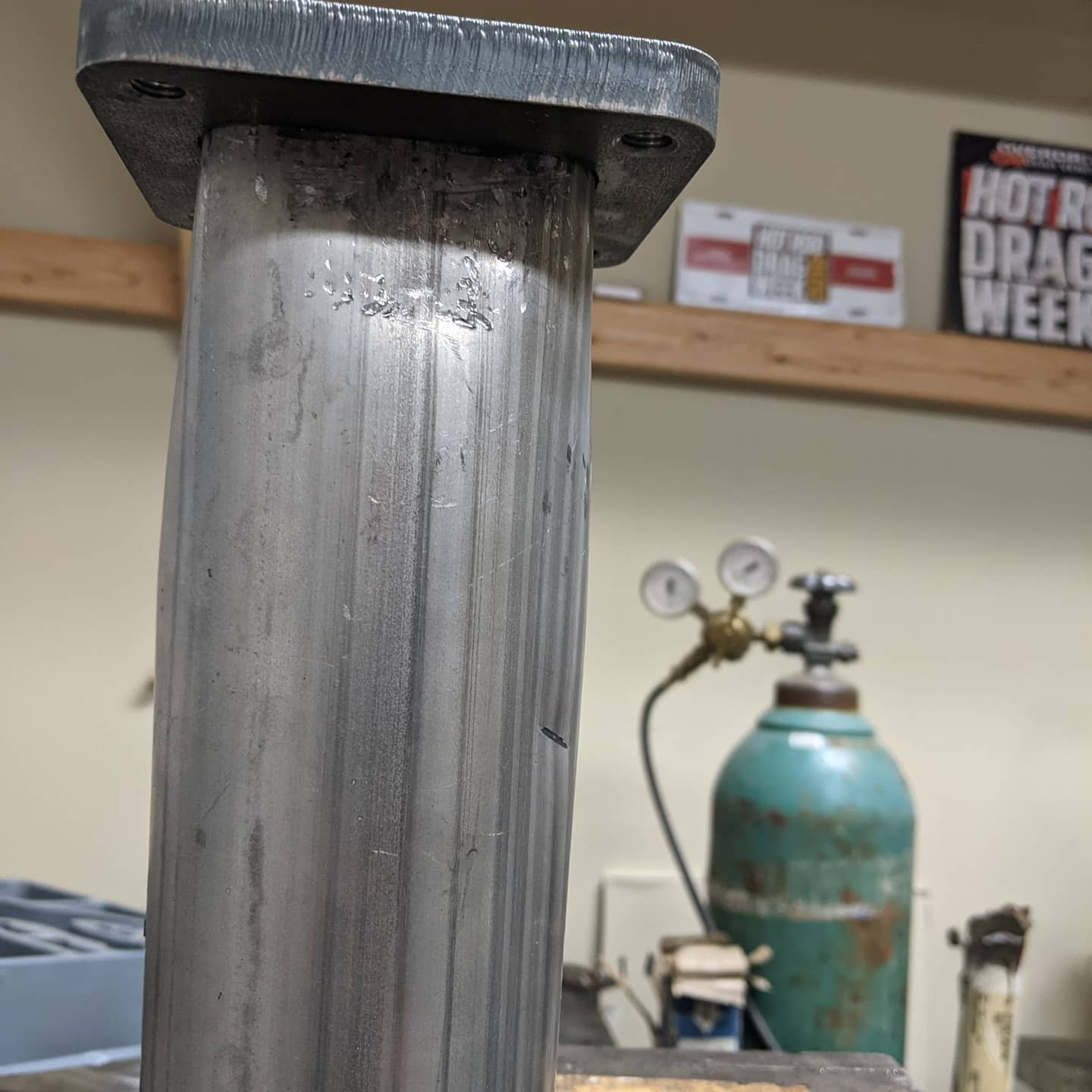

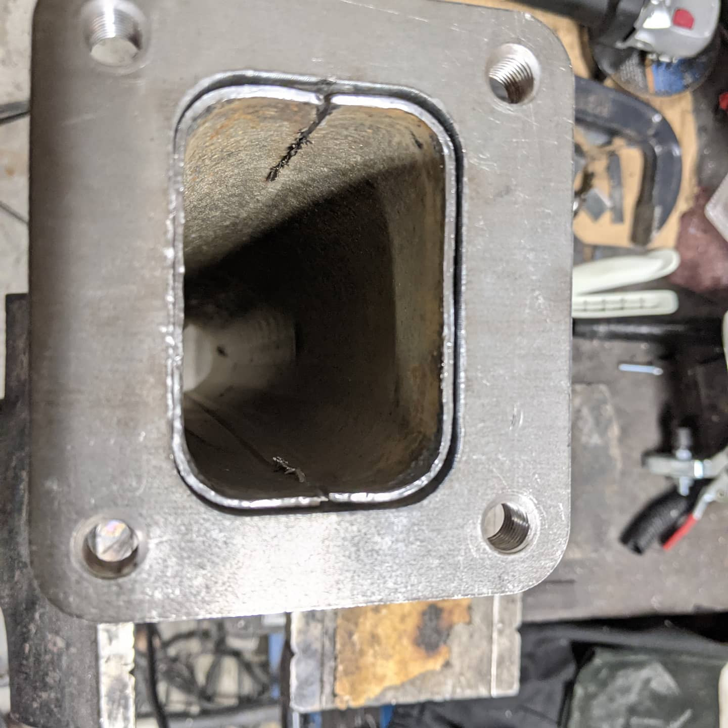

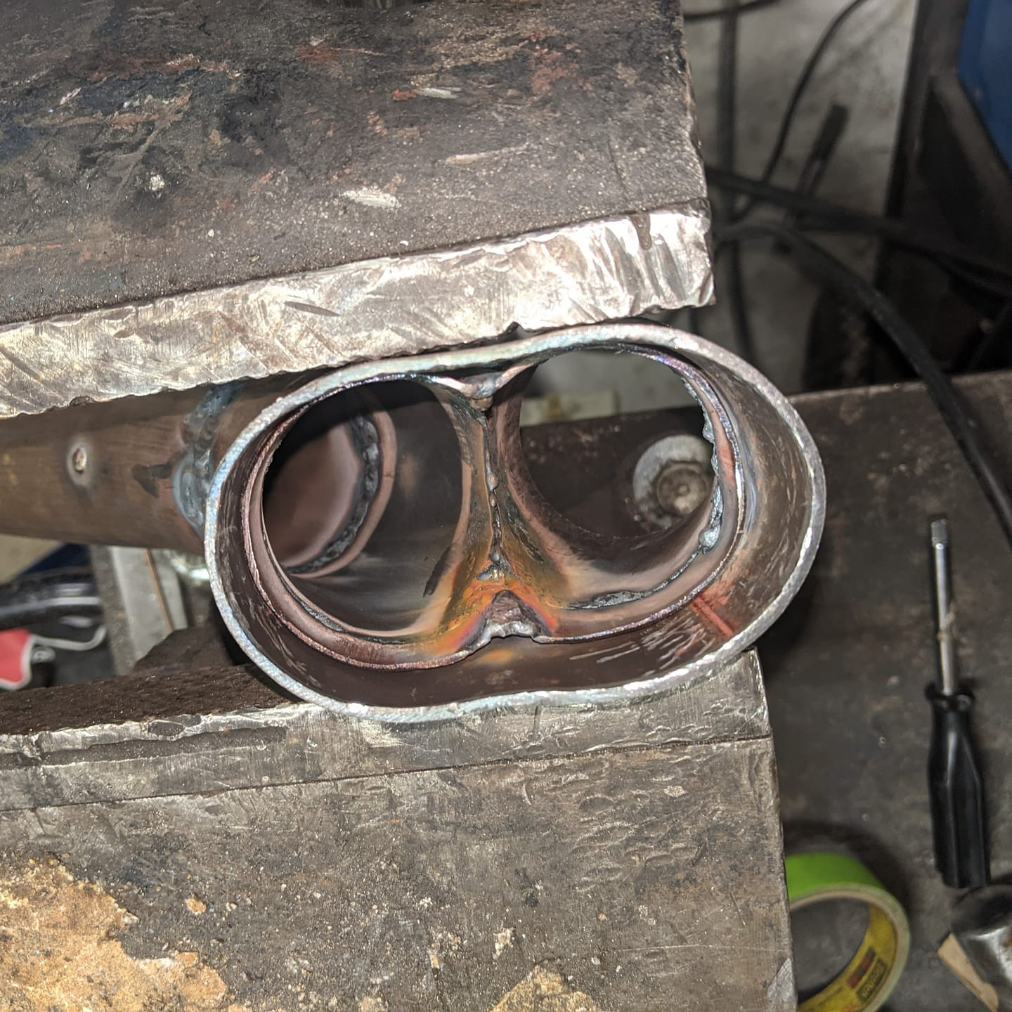

                              • I finished tacking the hot side (up-pipe) together last night. What do you think? I need to figure out the waste gate placement. I was going to put it in the side just below the flange. I was told that is not the best. I might be able to put it in the kink between the merge and straight section below the flange. But I am afraid it will be harder to get to there.
                                I took pictures but I am getting a file extension error?
