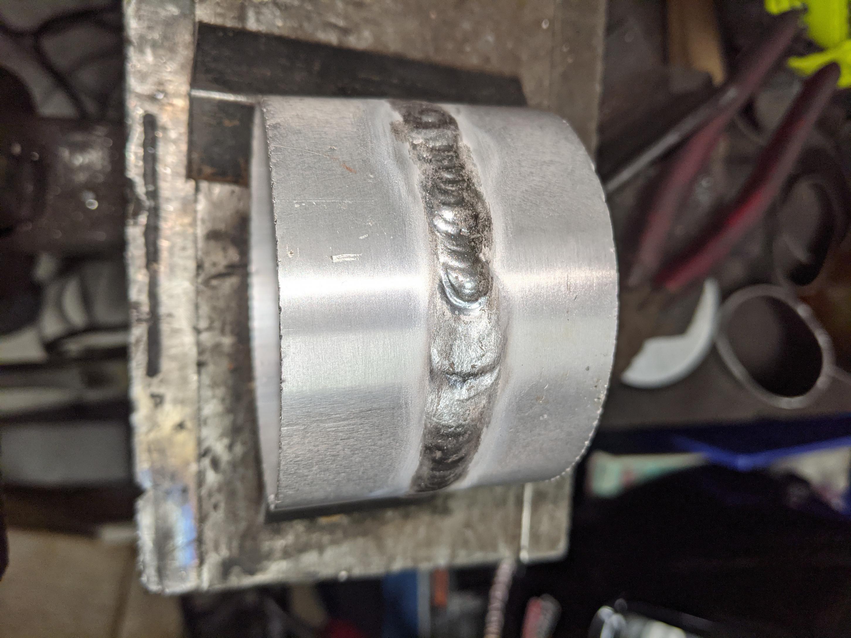

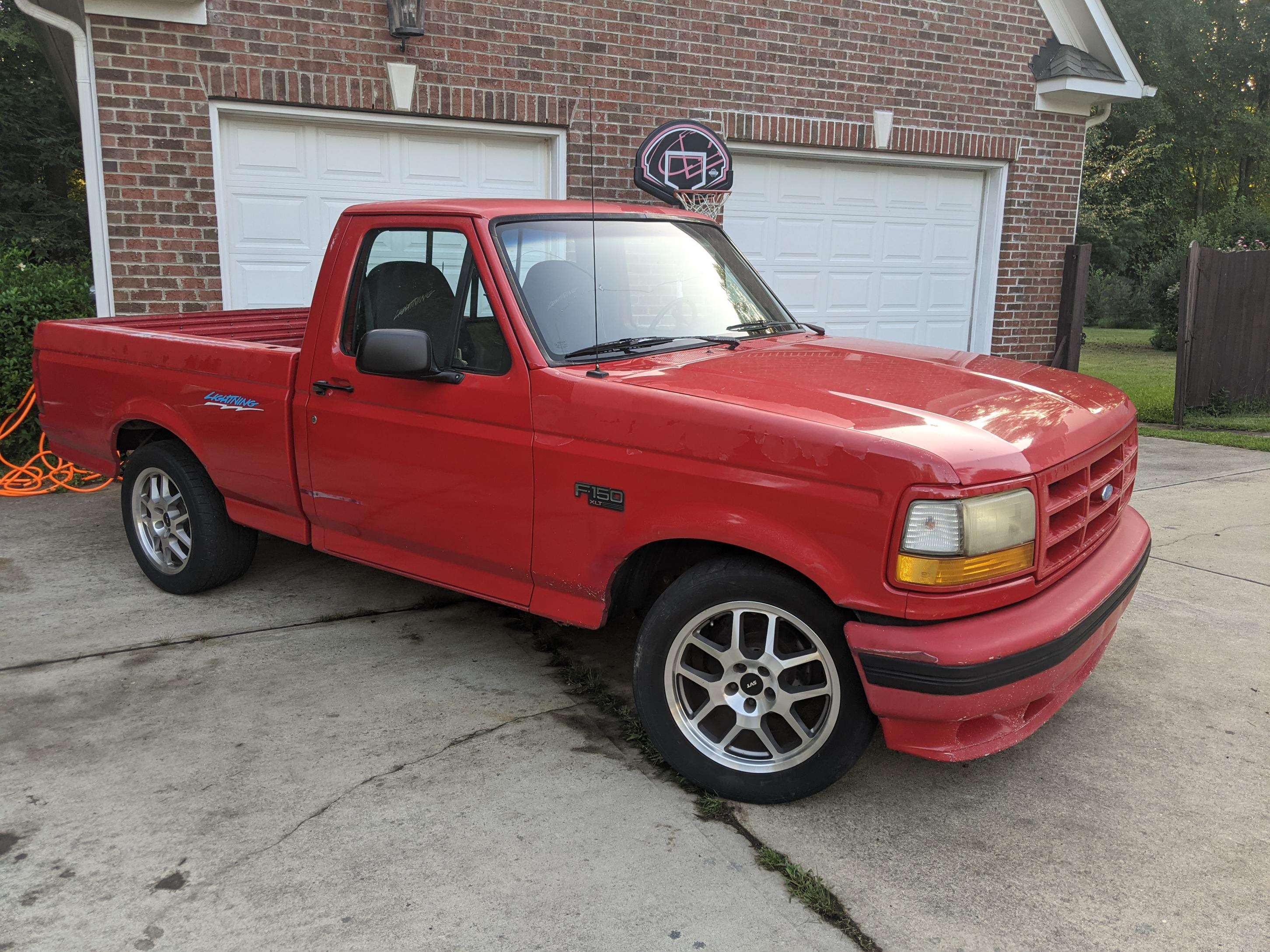

  • I have been slack when it comes to working on the car but I have really been slack with the updates! After tacking the down pipe I found out the DP was too close to the AC compressor. Cut some out of the up pipe. Started laying out the cold side and practice TIG welding. Been working alittle on the punch list for the lightning, got tags on it. Have only driven it once to the dump. Hope to drive it to work tomorrow. It seems to run pretty good, jury is still out on handling. But it is a 28 year old twin I-beam truck with 240k miles

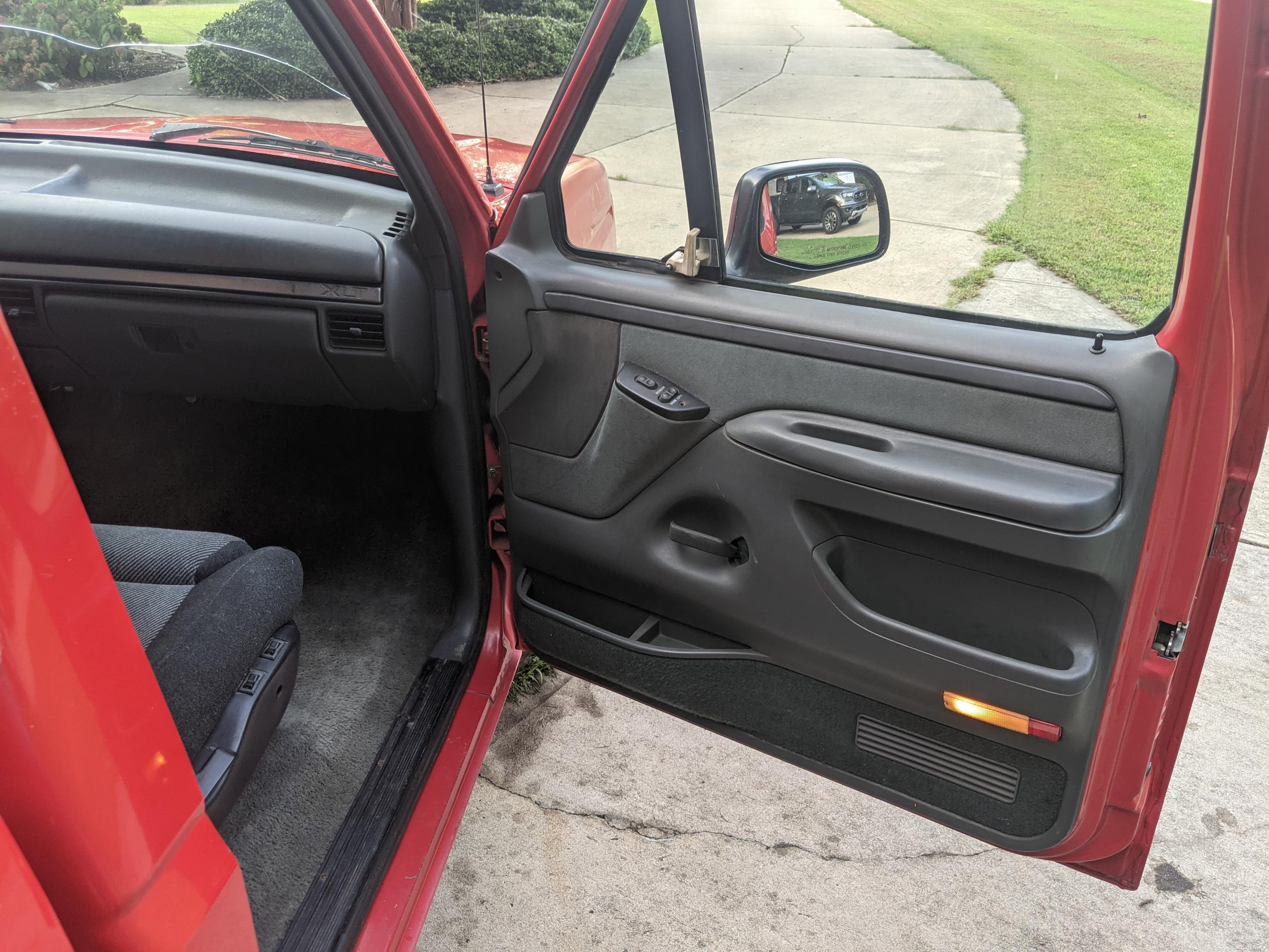

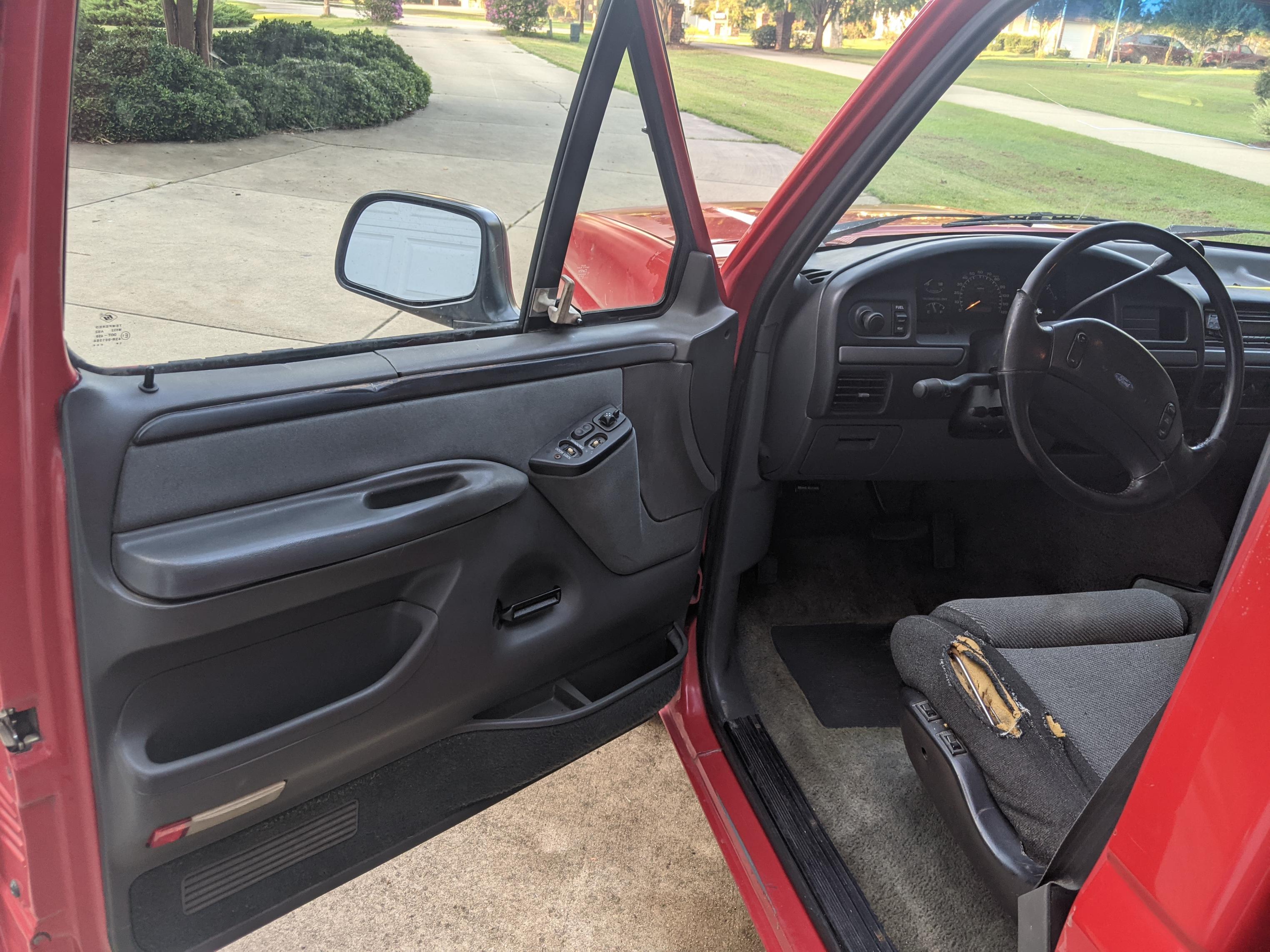

        • I worked on the Lighting last night, doors and dash. Replaced the cable for the passenger side door handle, etc. Got the door panels back on. I was thinking about driving it to work today. So I drove it to the gas station for a splash and go. The road I live on is a little ruff, the steering requires some corrections, smoother road is not as bad, but it's no one finger Lincoln. I have to go pick the kids up after work so I decided to delay the truck to work just incase it doesn't go well. I am going to jack it up and take a look at the front end and shake stuff. The tires are older and wide, older shocks, hard parts? Any advice?

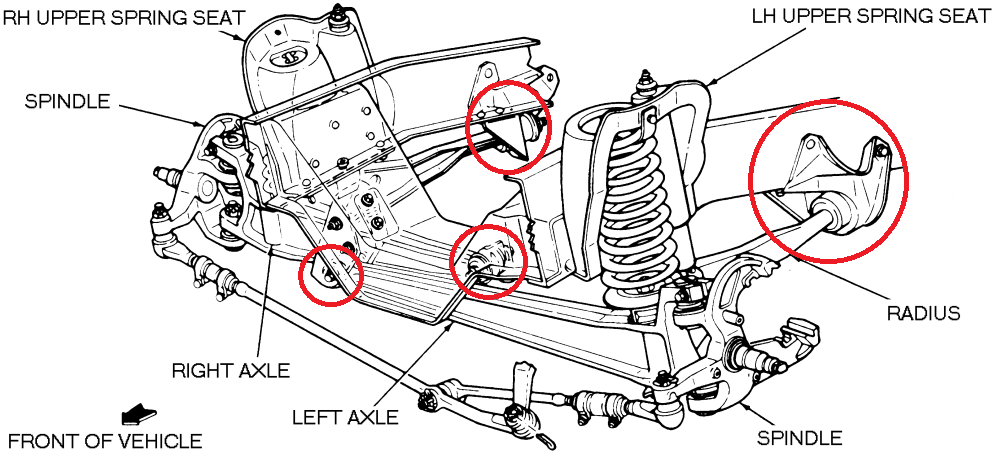

              Late model I-beams are bearing type joints, not sure when exactly they got away from kingpins.... on it's best day when new it was still nowhere close to a strut/Rack and Pinion or a-arm truck for comfort or handling, but they did okay. Random internet picture with random red circles where the rubber wears out, not the point, but shows the bearing joint configuration anyway. I guess you would call them ball joints but they don't have to articulate quite like that.

              and that picture just made me have bad memories. LOL... radius arm bushing replacement means pulling the springs and I'm not sure I've ever had to use a longer cheater bar than the front end of an F series.

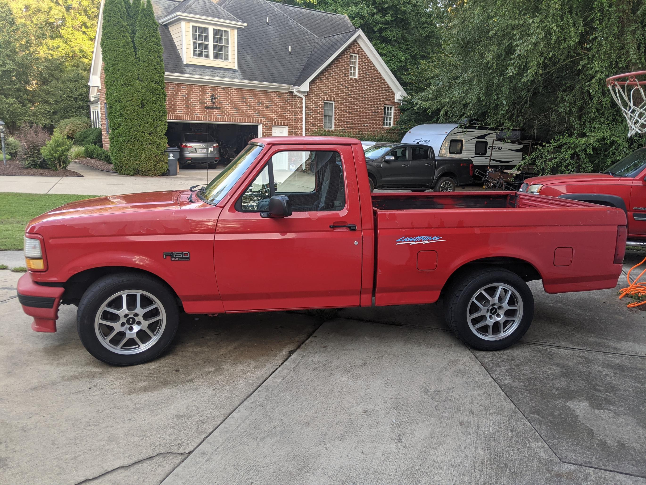

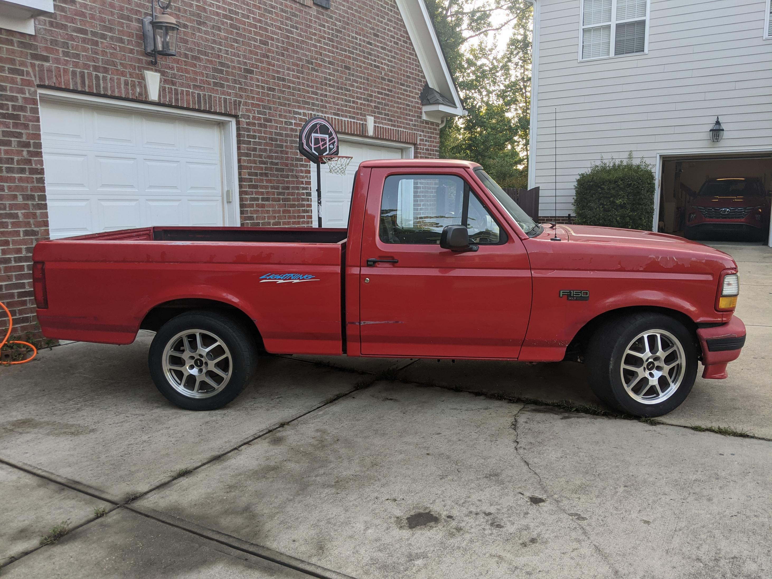

                            • I really should know that I can't have two project cars at one time. I have cancelled my Dragweek registration. The turbo is not getting finished. I worked on the Lightning some I found one of the reasons it doesn't drive great, the ball joints need to be replaced. I didn't check the other front end parts. I think it time to cut loose the time / money suck. So I guess this is like the coming soon ads.
                              1993 Red Lightning 240k Miles. Other than the genuine 2008 SVT Mustang Cobra wheels it's pretty much stock. It runs good, it drives fair, it needs ball joints. It could use some cosmetic work or call it patina. I have enjoyed working on it but I am ready for someone else carry the torch. What's it worth?
