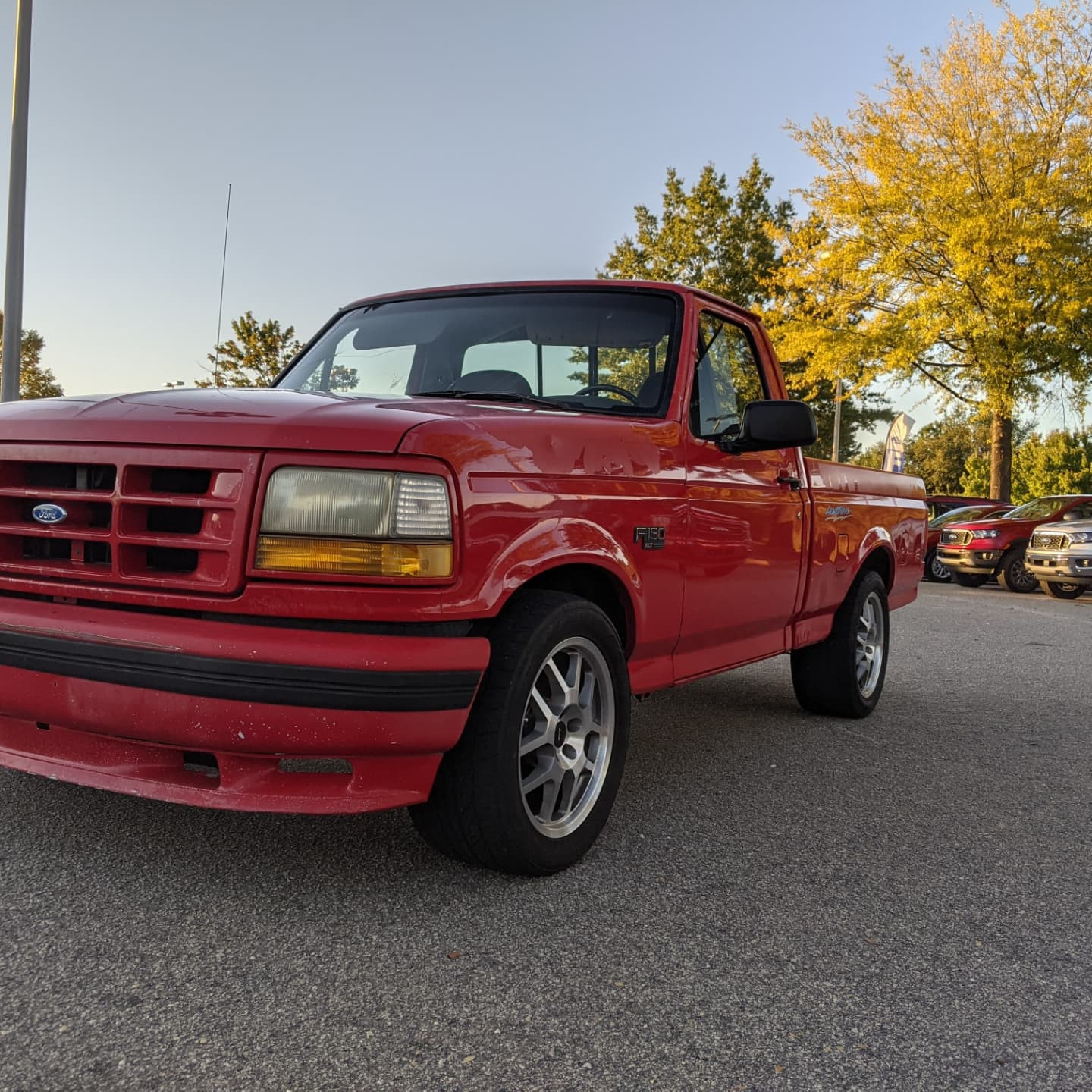

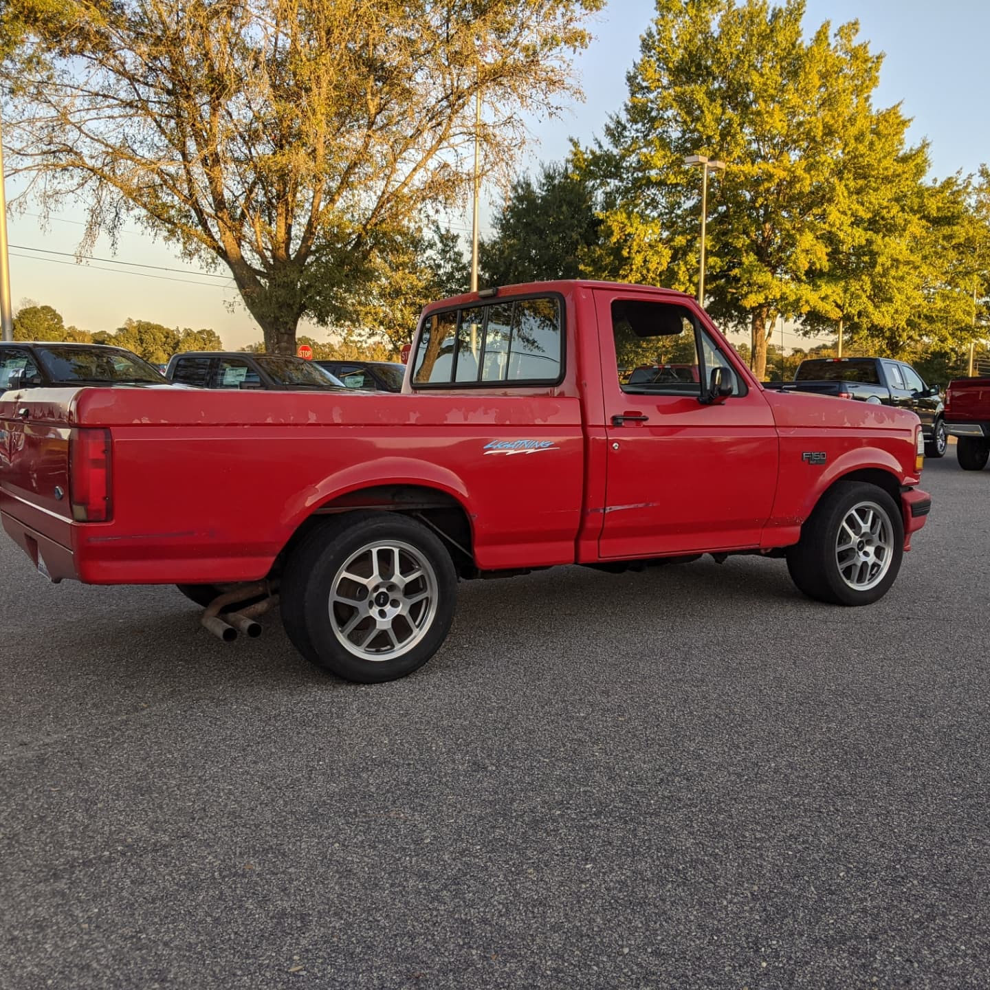

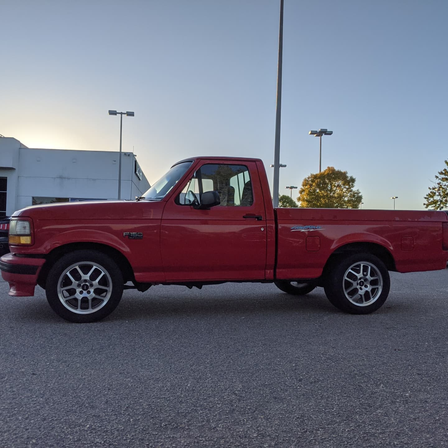

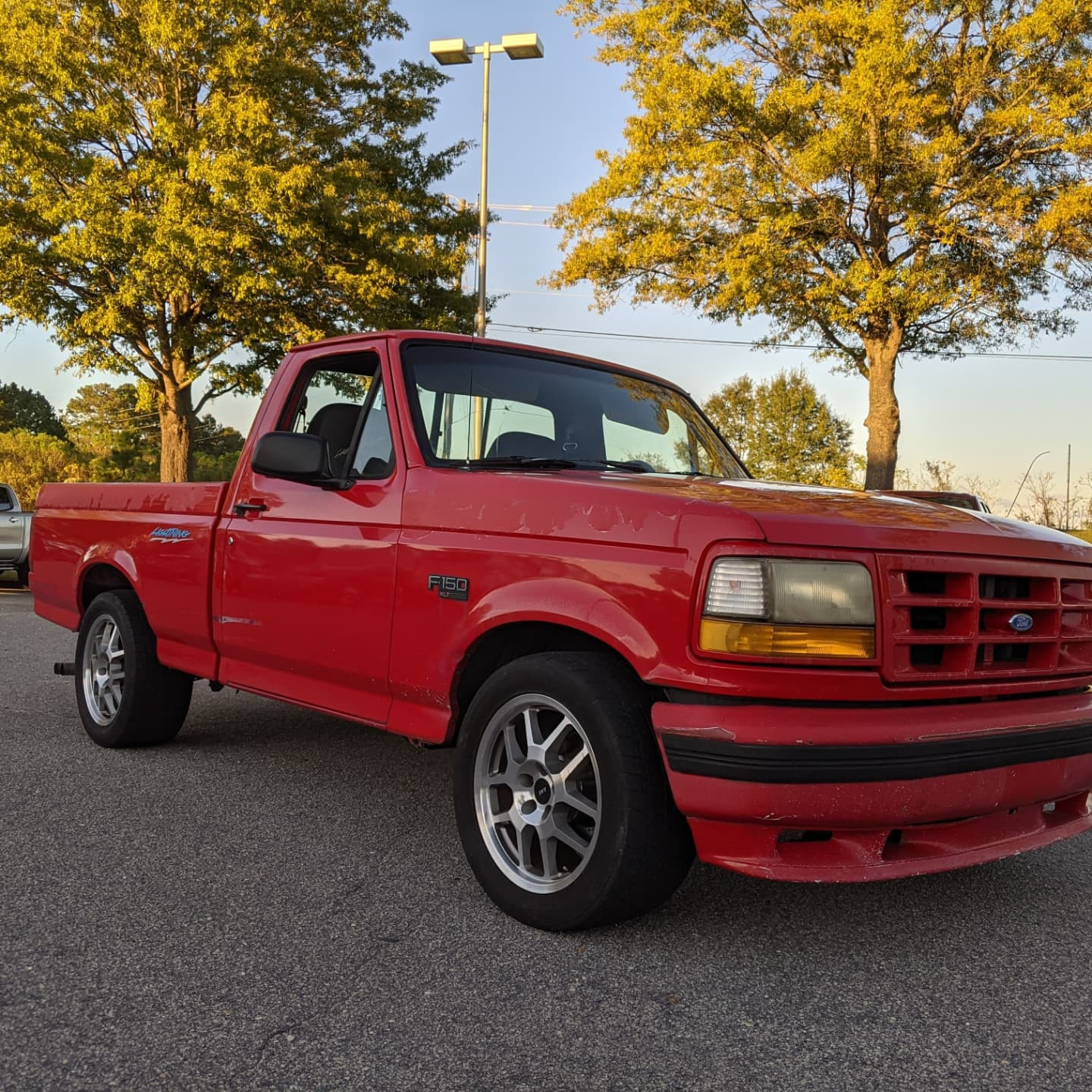

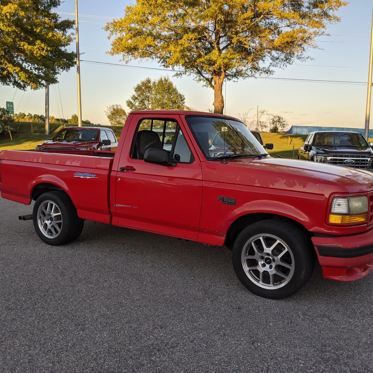

            • It's time to list the distraction for sale. I played the lottery a couple times and didn't win so it's time to go! I have enjoyed having the Lightning. I drove it to work, grocery store, to haul the trash a few times. I have taken my wife on date night, dad for a ride (he had a 70 F100 when I was a kid). Today I took the kids to get slushies. Other than football tailgate I think it's done everything I would like to do with it.
              Click image for larger version  Name:	IMG_20211017_192603_145.jpg Views:	29 Size:	603.1 KB ID:	13079321993 Lightning 240k miles. Running and driving project truck. Could be restored or its good enough to be "a car guy daily driver". Mostly stock with genuine 2007 Mustang GT500 wheels.

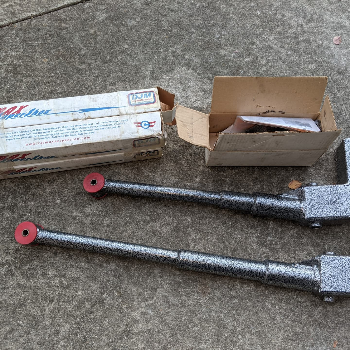

              Can include DMJ Dream beams (lowering I-beams) and flip kit with shocks

              I Thought some new ford's would be a nice back drop for a few pictures.

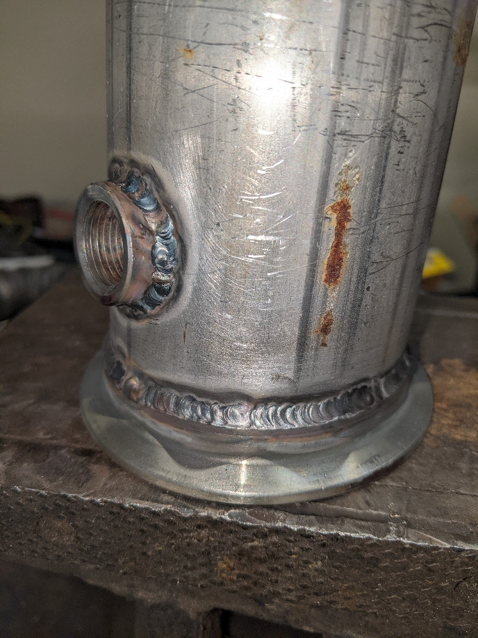

ID:	1315399 I really stink at updates. Mustang is still in jack stand jail. I keep telling myself it's close. Need to finish the temporary downpipe and waste gate dump tube. Then do some wiring and rerouting install boost controller. Then everything else I am forgetting.

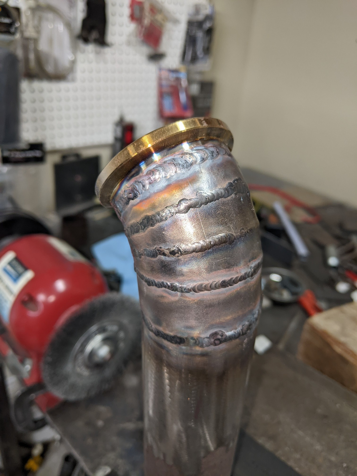

                      • You're getting better at that welding thing! You can tackle my stuff any old time you want.
                        • Thanks Dan! Not sure I am ready for structure yet, but bring it up here we can tackle it. The more time I spend TIG welding the more I like if nothing else I seem to have fewer burns.
                          • Houston helped me in the shop yesterday. We worked on the "temporary" down pipe extension, and the WG dump. Other than a hanger I think the fabrication is done for now.
                              I find the better I get at tig welding , the more time and money I save on grinding…
                              • Looking good! that's ALOT of tig welding practice on a single pipe! well done indeed!
