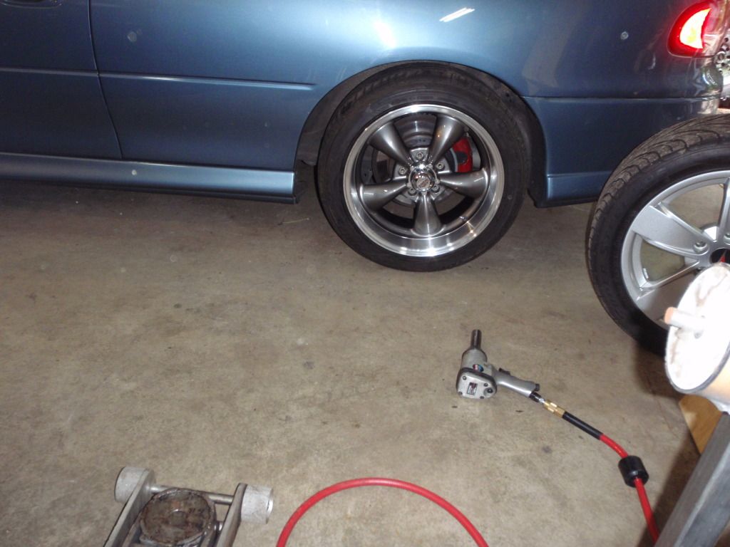

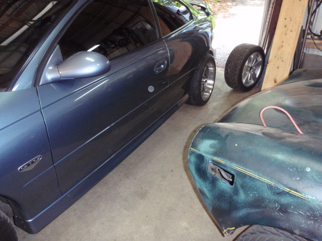

    so I tried on my torque thrusts on the GTO....
    not bad
    errr
    my rocker days are far behind - so no
    how about on the Skylark
    looks okay
    errr. no, for the opposite reason - I've never been into hip hop
    Leave a comment:
