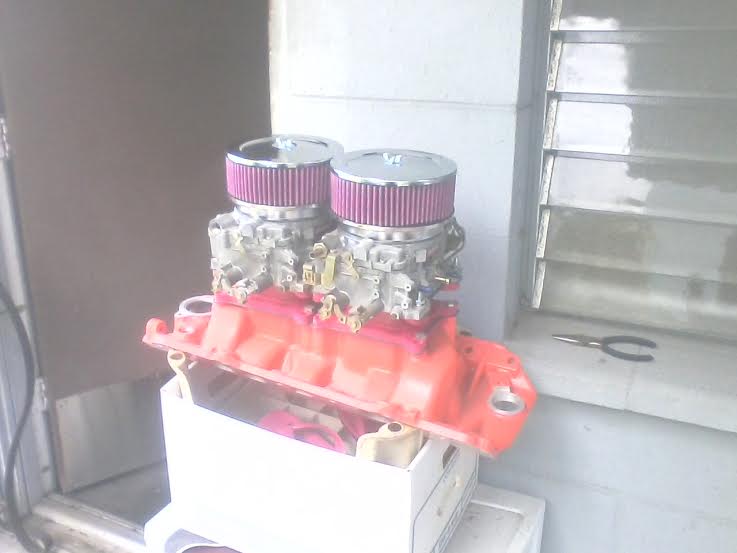

                        • It's how real-men get hood clearance none of this "I'll put a shorter manifold stuff"
                          • dual quad air gap with demon carbs?
                              this ones about ready to go on the 461" in the white vette.
                              i see your hood clearance and raise you one pollock tunnelram setup.
                              its a "C-66-O" intake, with twin 2"-4hole spacers and twin 600's......
                              in the words of tim allen, "arrgh, arrrgh, AAAARRRRRRGH!!!"
                              *edit* when i originally posted this pic in the $5K or less project section,
                              the wife walked past, looked at the screen and said "nice--you know the carbs are on backwards,
                              RIGHT?" i assure you i have since unbolted the carbs and turned them around the right way... Click image for larger version
