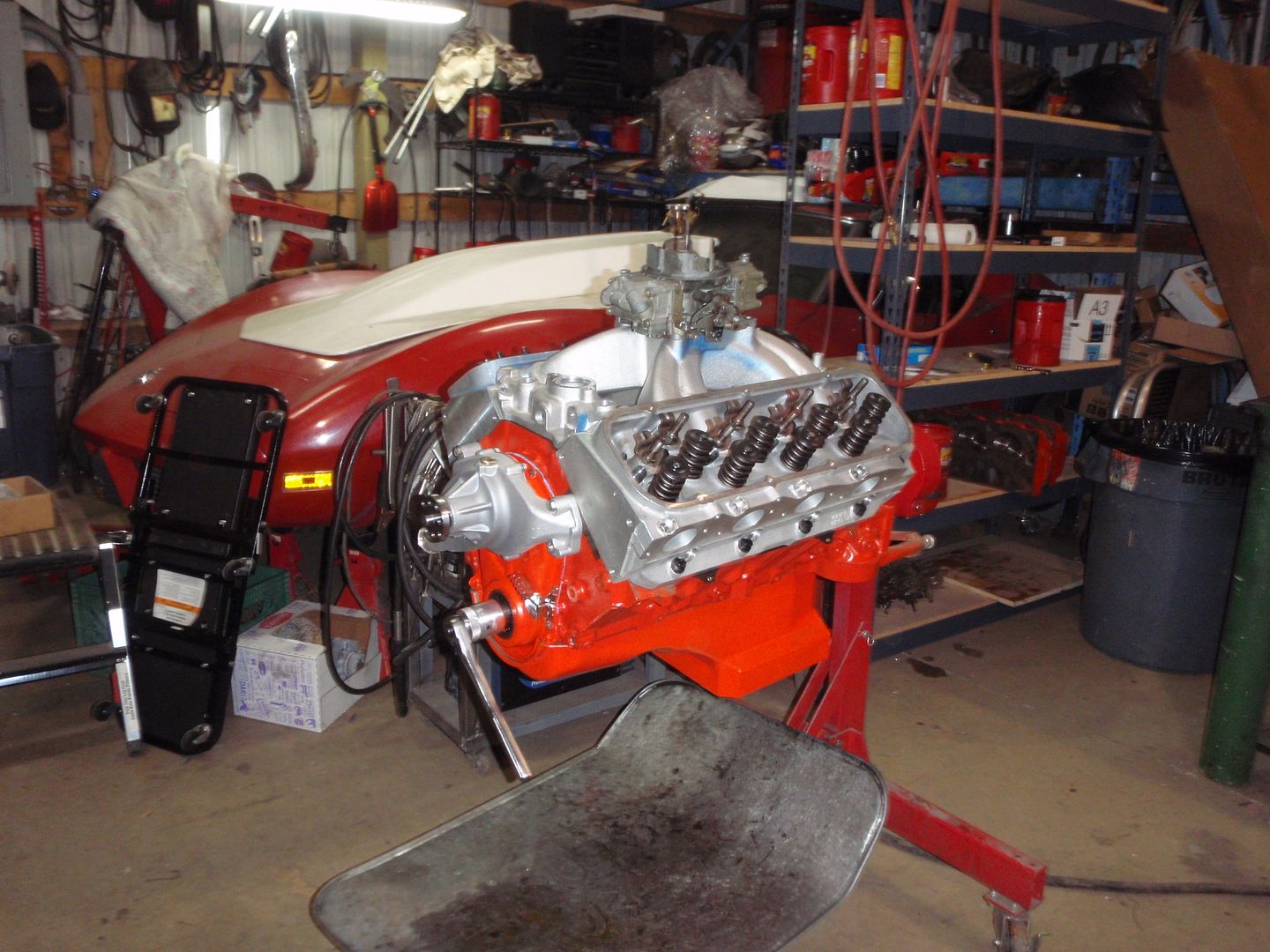

  • first things first.... replace the plug
    then measure for new pushrods
    verify that nothing is going to hit (and who says I'm not crafty?)
    at least .0740 of clearance
    verified both sides
    stack it all together again
    which brings the new problem.... I ordered the wrong head bolts, in case anyone is copying this - the heads are similar to a Profiler 18 or 24, so those are the head bolts to get. Ah well, it's all moving the right way
    • That's cool... hopefully your clearances will be OK now...
      • test fit time
        with supervision
        this was a bit spun up because a balloon went over....
        hmmm, nice balance
        let's try that again
        take wheel off.... life is easier until I finally build a gantry
        almost like GM planned it this way
        part one was how tall of valve cover would fit
        this is why there is a big hit on the header tube from OBX - still looks like crap
        miles of room
        and the other thing I needed to know - how much scoop
        certainly won't be doing a tall filter but it looks like just enough clearance for my L88 scoop
        • i have cal custom tall covers and they fit under the booster--
          by maybe 3 nickles thickness. the fuel pump to frame needed a 90
          degree fitting, and still just barely clears--maybe 3 dimes thick worth.
          good strong poly or solid mounts are a MUST.
          and i was wondering what you were trying to do going in from the front.
          gots to pull a tire and go from the side...oh wait. never mind, just saw
          the next picture, hah hah...
          these are a "fun" swap, but basically a bolt in IF you have the right
          supporting actors- pulleys, waterpump, brackets, mounts, etc.
          its tight, but she go. looking good, buddy. looking good.
          p.s. my 2" primary hedmans didnt need a single ding anywhere.
          hedmans are by far the best fitting brand everytime. driver side
          went up from bottom (no filter yet) and passenger side went in from
          top after i removed starter....to quote ace ventura, "like a glove" !

            • the entire point of test-fitting the motor is to figure out what fits and what doesn't. I have questions on the valve covers, headers, oil pan, accessory drive and hood clearance. I may also install the sidepipes... so there's the list for the week.

                    mines so tight i cant squeeze a finger between the drivers side
                    valve cover and the booster, the fan belt needs to go on 'sideways'
                    and roll into position between bottom pulley & x-member, and if
                    the left energy poly motor mount ever softens up i got like 3 dimes
                    thickness clearance between the fuelpump 90 degree fitting and
                    the RH framerail--thats gonna leave a mark.
                    the passenger valvecover 'self clearanced' the A/C box a bit on full throttle,
                    and even the headmans are REALLY close to the steering box-like 1
                    dimes thickness away. the alternator is 1-1/2 inches from driver inner fender rail
                    where hood sits, etc...
                    but again, basically a bolt in swap if you got the correct stuff- and D*MN is
                    it worth it, a BBC in a vette is pretty crazy. especially a 'slightly modified'
                    one, heh heh... id say im putting out roughly 475-525hp at the crank, she
                    pulls the front end against the top-out bumpstops with a clunk on full
                    throttle and keeps it there to 6000+rpm in all 3 gears till you let off.
                    truly scary, but oh-so-awesome.... youre gonna have a blast with her.

                            • so, other then the DD distraction, parts are coming together to move forward ..
                              first, and oh how I loved the howl last time I changed the rag joint for a solid borgeson joint.... these are the bits to remove the power steering and the rag joint
                              and I got the pushrods
                              now it's time to start pulling the stuff down for the rest of this build
                              I'm sure someone, somewhere needs this cowl hood and wants to trade me for their flat one - so I can put a different scoop in it. The guy who did this did a reasonable job installing the scoop so it seems kind of a shame to cut it one up
