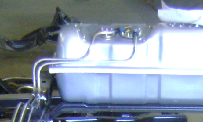

                            With an old-style external pump feeding a carb at 15 psi or so I'd look to up the fuel line diameter to half-inch, which it looks like you'd have to make up as I don't see anybody selling pre-made lines. Stainless half-inch (if you wanted that over steel) gets to be a bitch to work with and a good bender for that is hard to find also, I have one I had to make myself 'cause a purchased one kinked the line due to too-tight radius. Not to mention, bending up those lines with the body installed will probably be an awful job unless you really enjoy bending lines up (I sorta do, sick-o). The Chall has 5/8 lines, aluminum line was the only choice for line and I do not like aluminum fuel lines on the street! Street-driven cars see hazards a race car never will including freeway trash and lots of use over time.
                            But...
                            If you were to go with a fuel-injection-type in-tank pump w/ 50 psi or something like that, 3/8 is plenty enough diameter for the hp...see what this guy says: http://ipgparts.com/blog/fuel-line-s...ize-do-i-need/ You'd need the usual return system, when you get to the motor have a f.i. regulator and return line originate from there, then dead-head out the carb line with an 8 psi (or whatever) regulator on the way.
                            Just buying two pre-bent fuel lines and tweaking them around to run parallel should work or at-least be a good start, if no one sells a supply/return set already.
                            An important plus w/ above scheme, if you switch to f.i. later, you're already set. The negative is, again, doing all this with the body installed, including the fuel tank mods or swap will be a project in itself. The one I did a few months ago using a Tanks Inc. tank and pump/tank plate had some pretty odd bending to do to make lines work, I'd have hated to have to mess with that and work around the body too.
                            Fuzzy pic below: looks simple 'til you deal with the fuel tank hold-down which has to thread in there where the stamped depression on the left is, why the line that takes off to the left is where it is, the supplied tank plate really ran the two things smack into each other. . There needs to be a tank vent in there somewhere too.
                            I suppose that all this would be easier if you were to be accepting use of flex line around the tank area. I kinda avoid the stuff except at the motor, but that may be just personal preference/paranoia as much as anything. Click image for larger version
