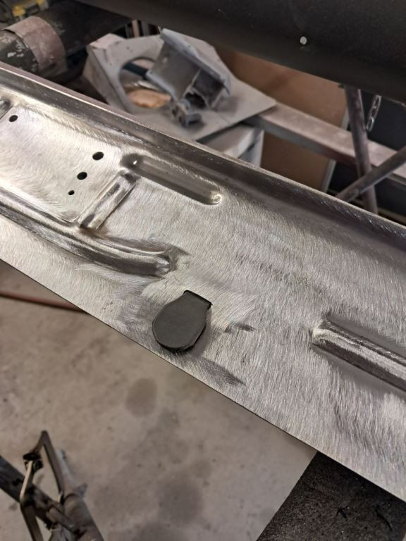

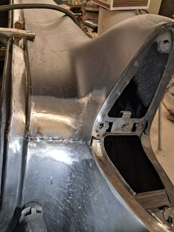

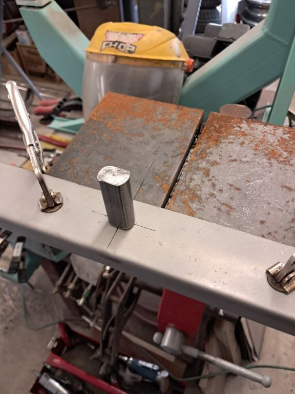

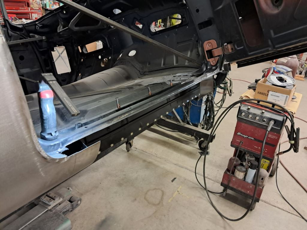

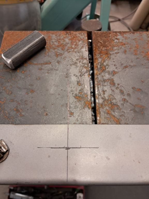

Inner rocker drain plug fabricated:

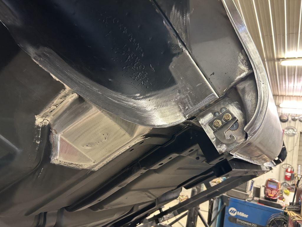

Inner rocker welded in:

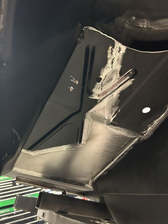

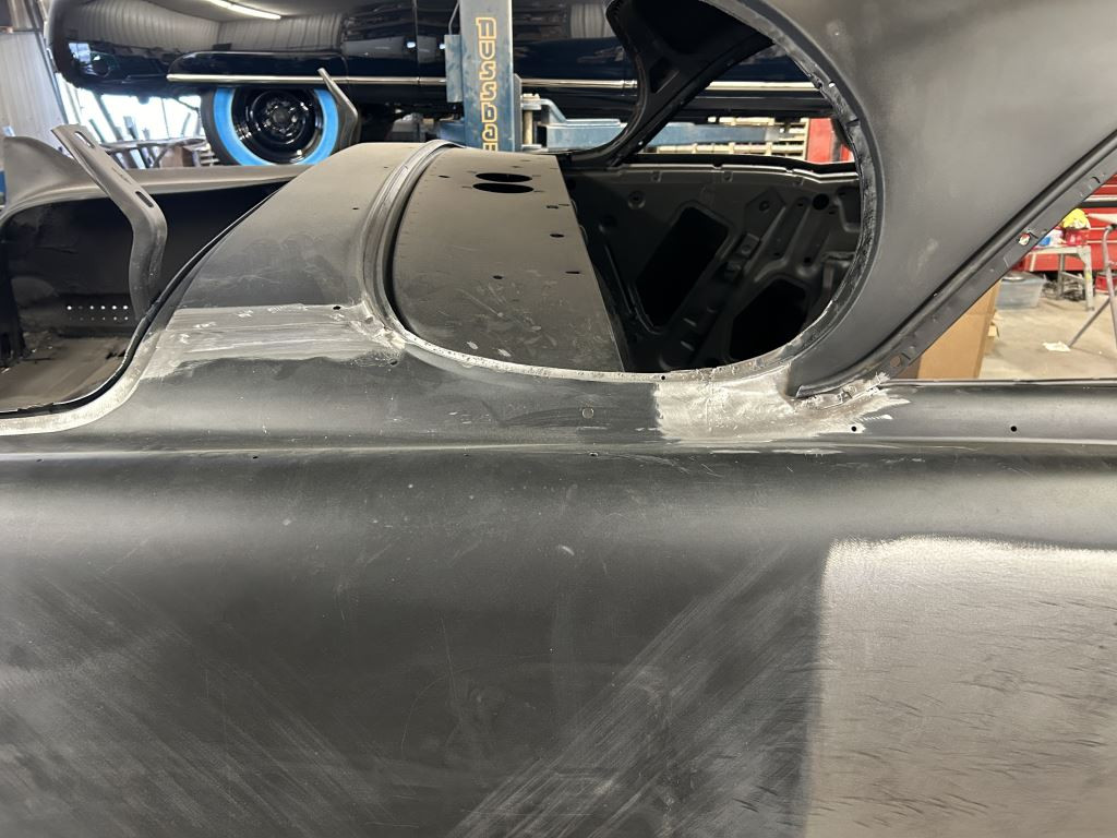

Inside of the quarter panel cleaned and primed:

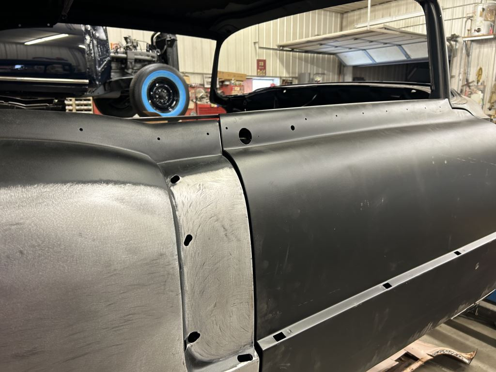

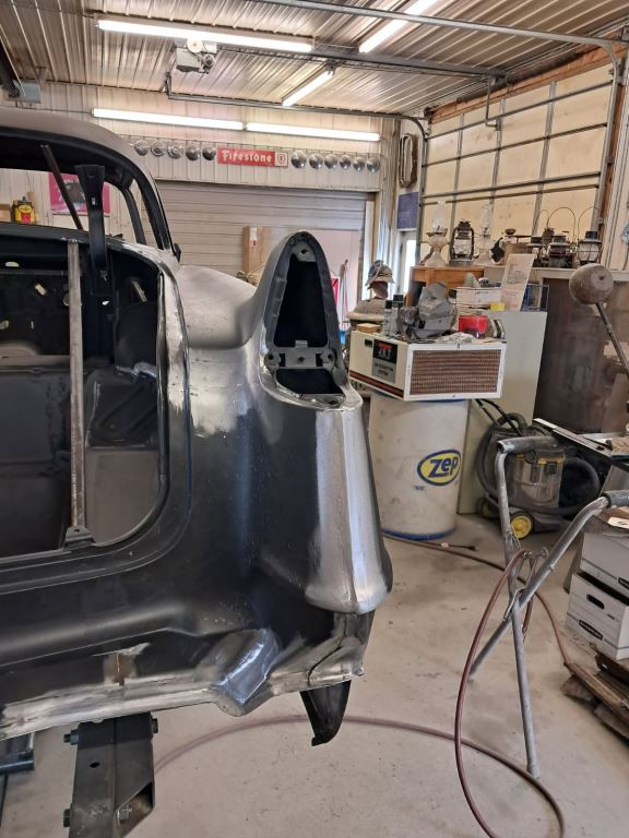

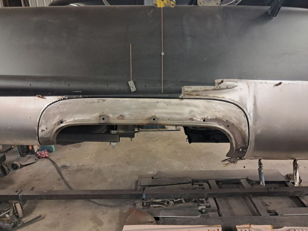

Quarter Panel is on!
74 Nova Project
66 Mustang GT Project
79 Chevy Truck Project
1956 Cadillac ProjectComment

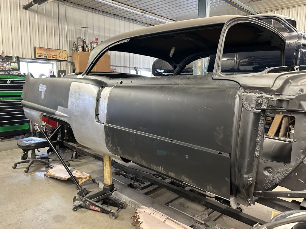

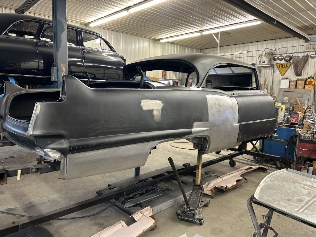

Astute viewers will notice a jack mid body that fixes the O Shit moment of the project. With the quarter mostly welded, the passenger door was fit prior to fitting and welding the outer rocker. Even with the substantial rotisserie arms the body does flex when most of the rocker structure is removed. Door before:
After:
74 Nova Project
This led us to take a break for some more significant inner bracing. All we had originally were door bars. This is the best shot I have of that work:

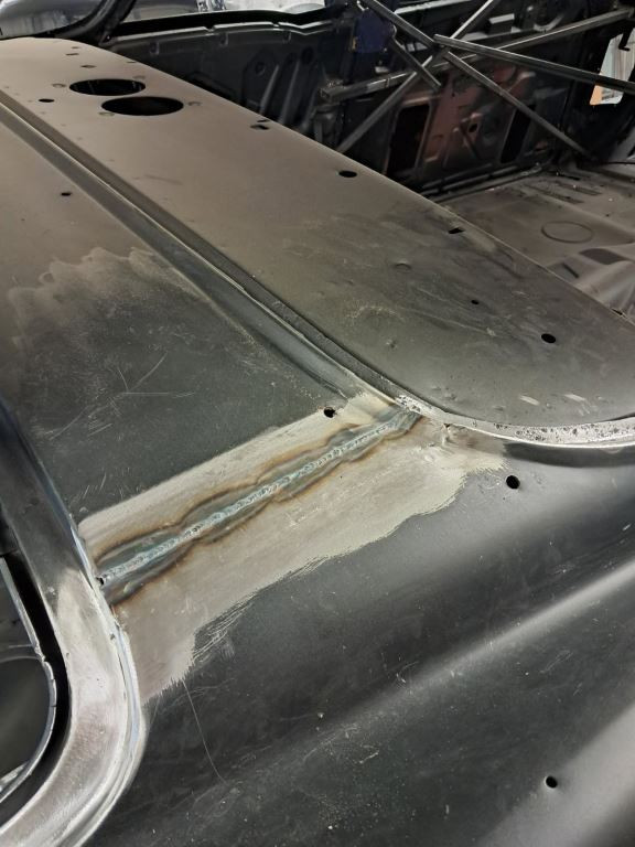

Trunk:
Drivers side (needs work yet):

More Quarter Panel:

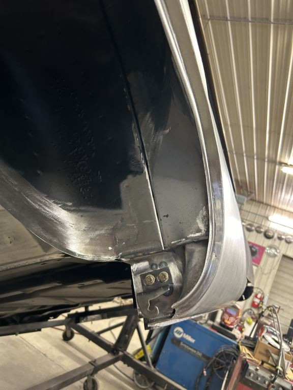

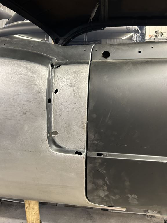

Rocker Panel - prep and door sill detail
