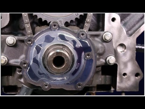

      Remember to prelube that sucker before you hit the key. I made a rig out of a pressure cooker that worked well but I've seen them made from big PCV plumbing drain pipe. Bottom line, LSs will fail if not prelubed as proven to me by the engine I put in my Grandson's Trailblazer SS. Three times.
        • 32184
        #18
        I know I didn't because I planned on pre-lubing by pressure; however, does the Buick pre-lube trick work on LS? (vaseline baby).
          • 28586
          #19
          I don't think so as the pump is buried in there where it would be hard to do. But maybe (says I, mulling it over......). But the pressure luber is easy enough to make and there is a port you can access fairly easily. I wonder if the Vaseline would get in the way of forcing oil thru the pump and passages? (More mulling......)
            That's good info. I usually just crank em without the spark plugs in them and they pick up oil pressure within a few seconds. That got me poking around the internet looking how different people prelube em. There are some neat setups people are building out there. Not sure how I will handle this one yet.
            I like this Melling video. Pretty straight forward way to prime an LS.
            SuperBuickGuy, I bet the Vaseline trick would work just fine to get it to prime. The pump on this 5.3 has bunch of lucas assembly lube oozing out of it. Last time I did one of these it sat for a year before I spun it over without the plugs in it. Primed in seconds. Come to think of it, I'm pretty sure that is one of the methods that GM used to recommend with their crate engines and replacement engines (That didn't have an easy way to prime it). I vaguely remember seeing it right on the tags that came with the engines back when I worked at Pontiac.
