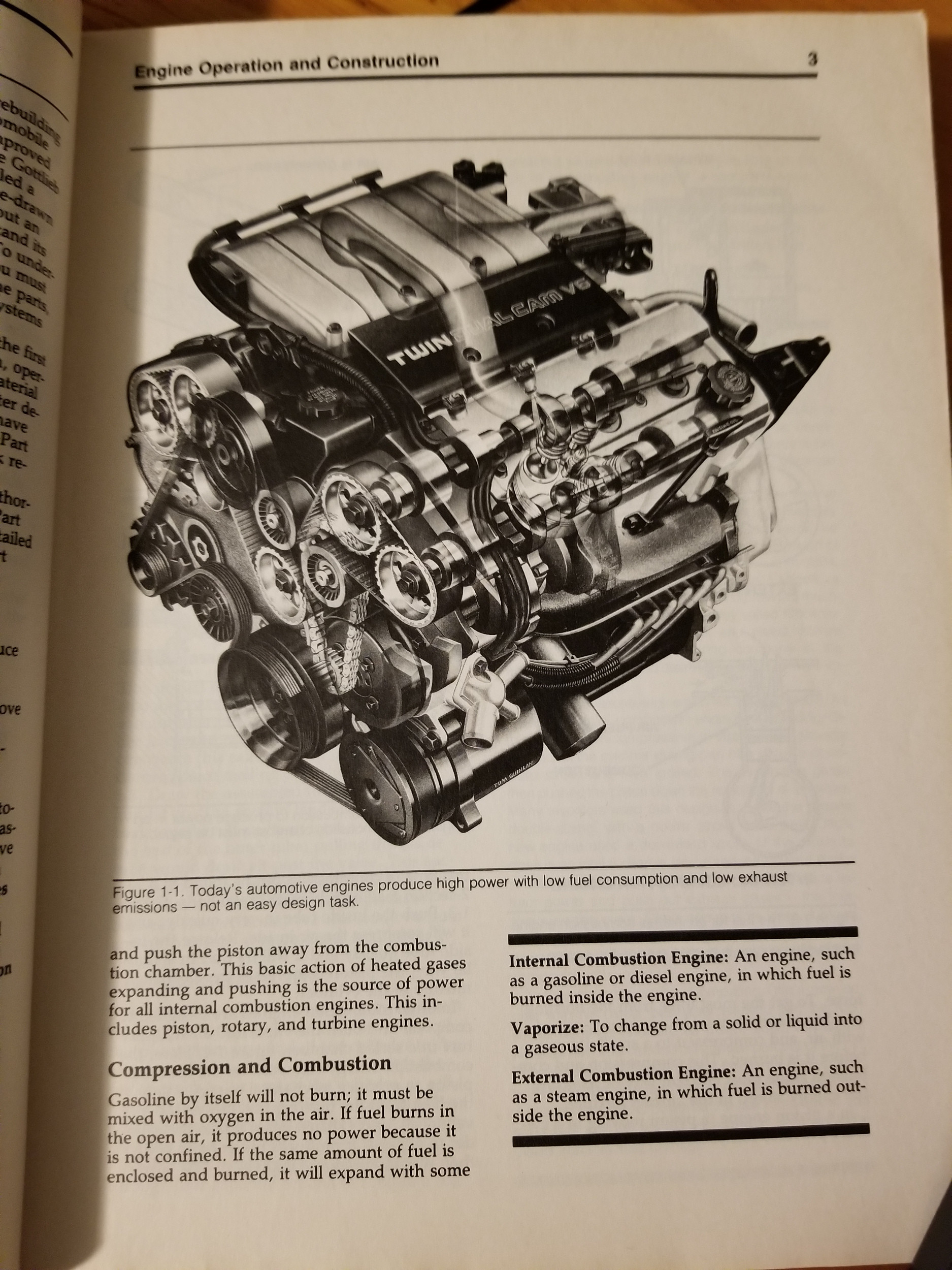

    Also, I stumbled across this gem from one of my engine building textbooks from college in the 90s. My best friends son was asking about books to read to learn about how to fix cars so i went digging through some of my old books.
    Click image for larger version  Name:	20200602_231244_scale.jpg Views:	0 Size:	962.7 KB ID:	1271368

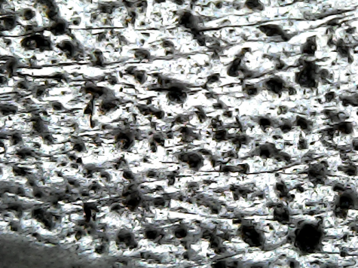

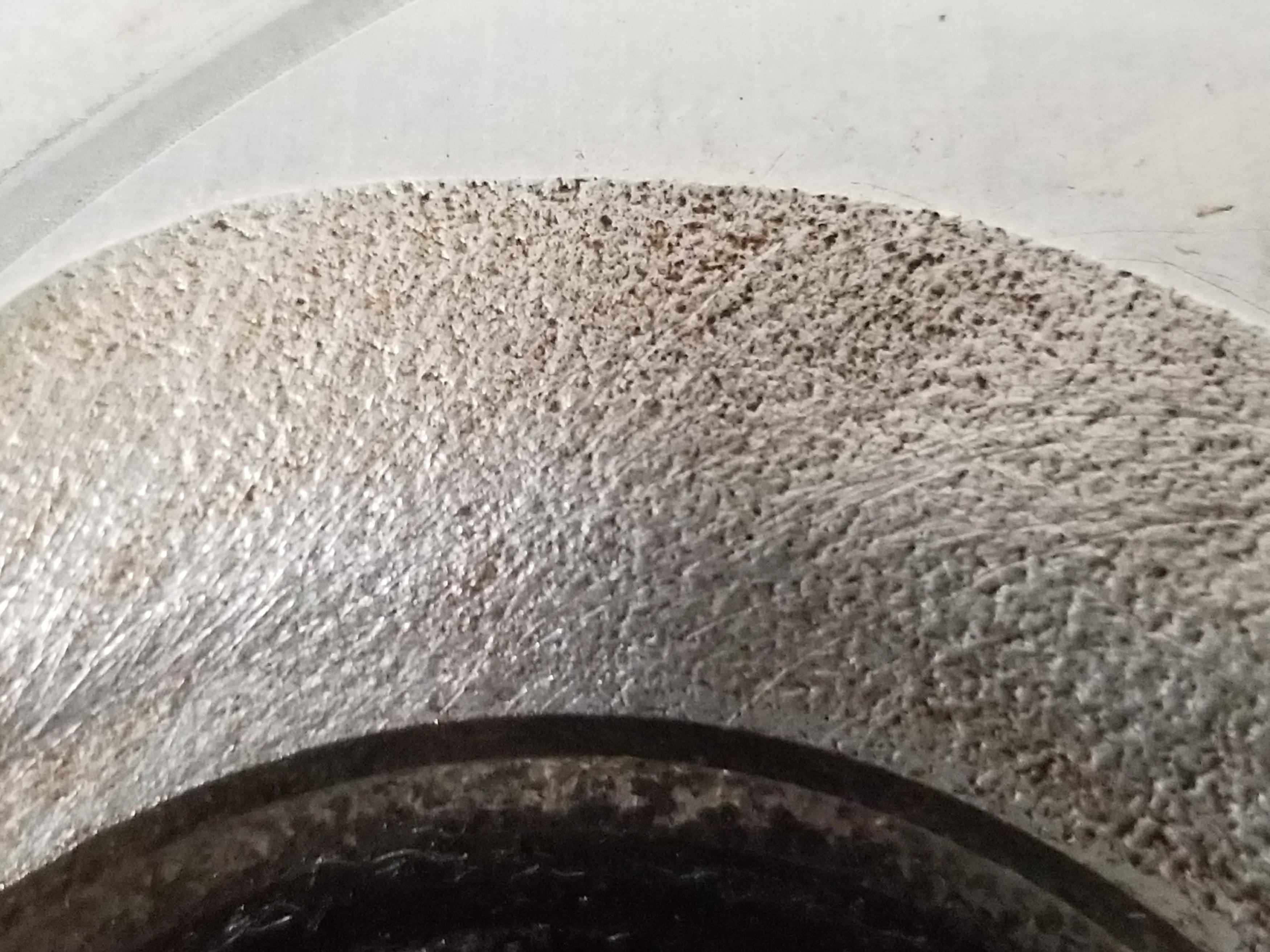

    The chamber looks really porous. How does it look with out the microscope?
    Pretty crazy right? I was a little weirded out by it. The casting itself isn't porous, Its more of the texture from the sand casting process I think. The carbon might be playing games with making it look that way too. The piston one creeps me out the most. Looks like something laid eggs in it.
    Here's some pics with a regular phone camera and some added shots of a different head. I usually smooth an rough areas in the chambers and round off any sharp edges.
    Click image for larger version  Name:	20200602_115124.jpg Views:	0 Size:	878.8 KB ID:	1271353
    Click image for larger version  Name:	20200602_115225.jpg Views:	0 Size:	683.0 KB ID:	1271354
    Click image for larger version  Name:	20200602_115213.jpg Views:	0 Size:	750.7 KB ID:	1271355
    Click image for larger version  Name:	20200602_115205.jpg Views:	0 Size:	753.6 KB ID:	1271356
    And here is a Quad 4/ Twin cam head with a close up shot of the combustion chamber with the microscope.
    Click image for larger version  Name:	20200602_174904.jpg Views:	0 Size:	1,018.3 KB ID:	1271357
    Similar texture in this head as well.
    Click image for larger version  Name:	vlcsnap-2020-06-02-17h49m56s835.png Views:	0 Size:	485.5 KB ID:	1271358

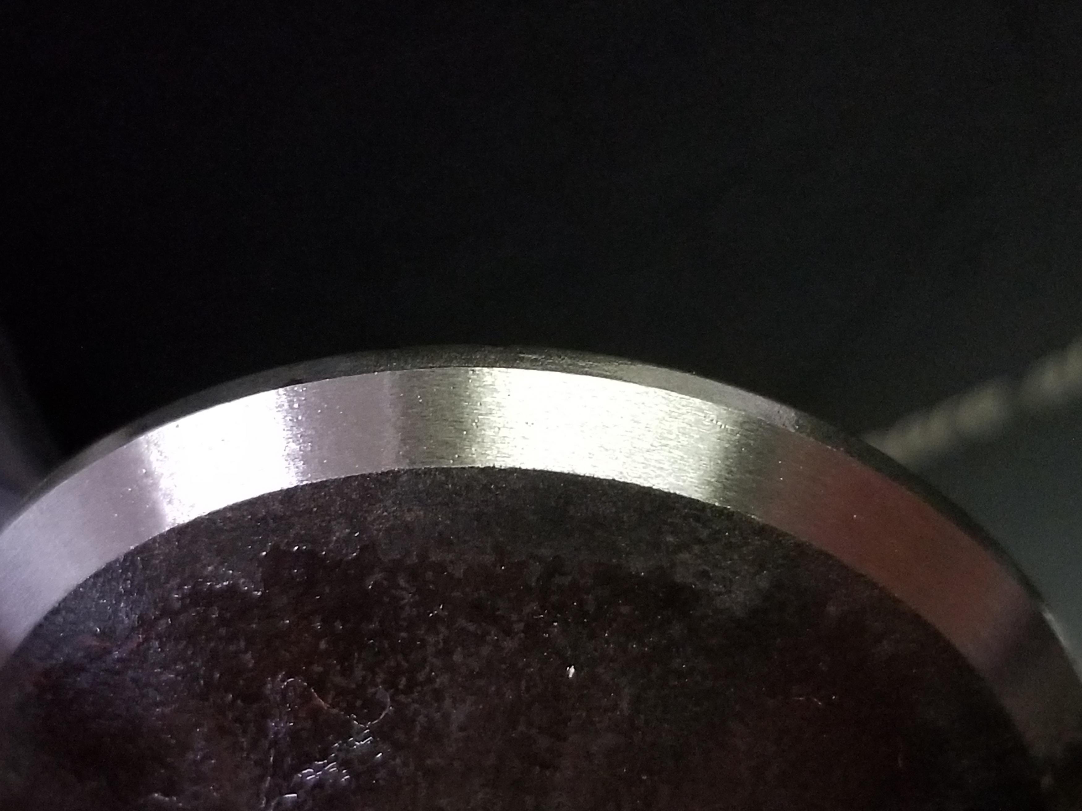

    Ground the valves and took some pics with a cheap microscope. Some are really interesting.
    Before
    After

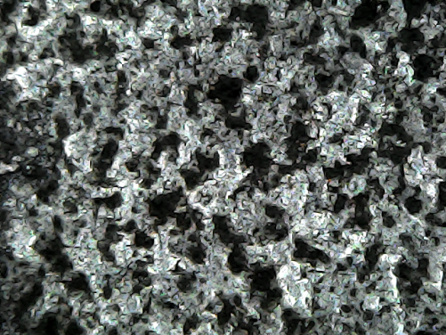

    This is what the combustion chamber looks like.

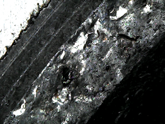

    Piston with chunk of spark plug ceramic in it

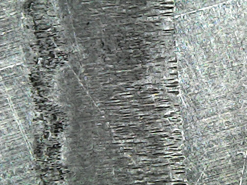

    Gasket surface on head from head gasket surrounding the cylinder. According to the GM service bulletin, this doesn't need to be resurfaced. I can feel it with my finger tip but not my fingernail. I'll put an indicator on it and see how much of an indentation it is.

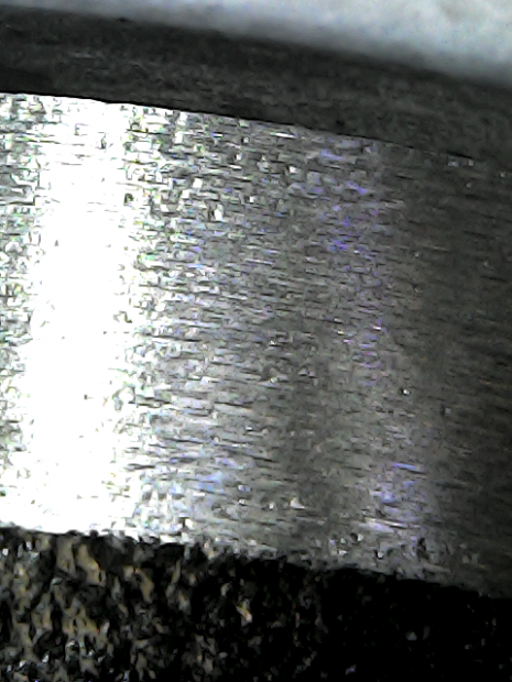

    Ground valve tip
