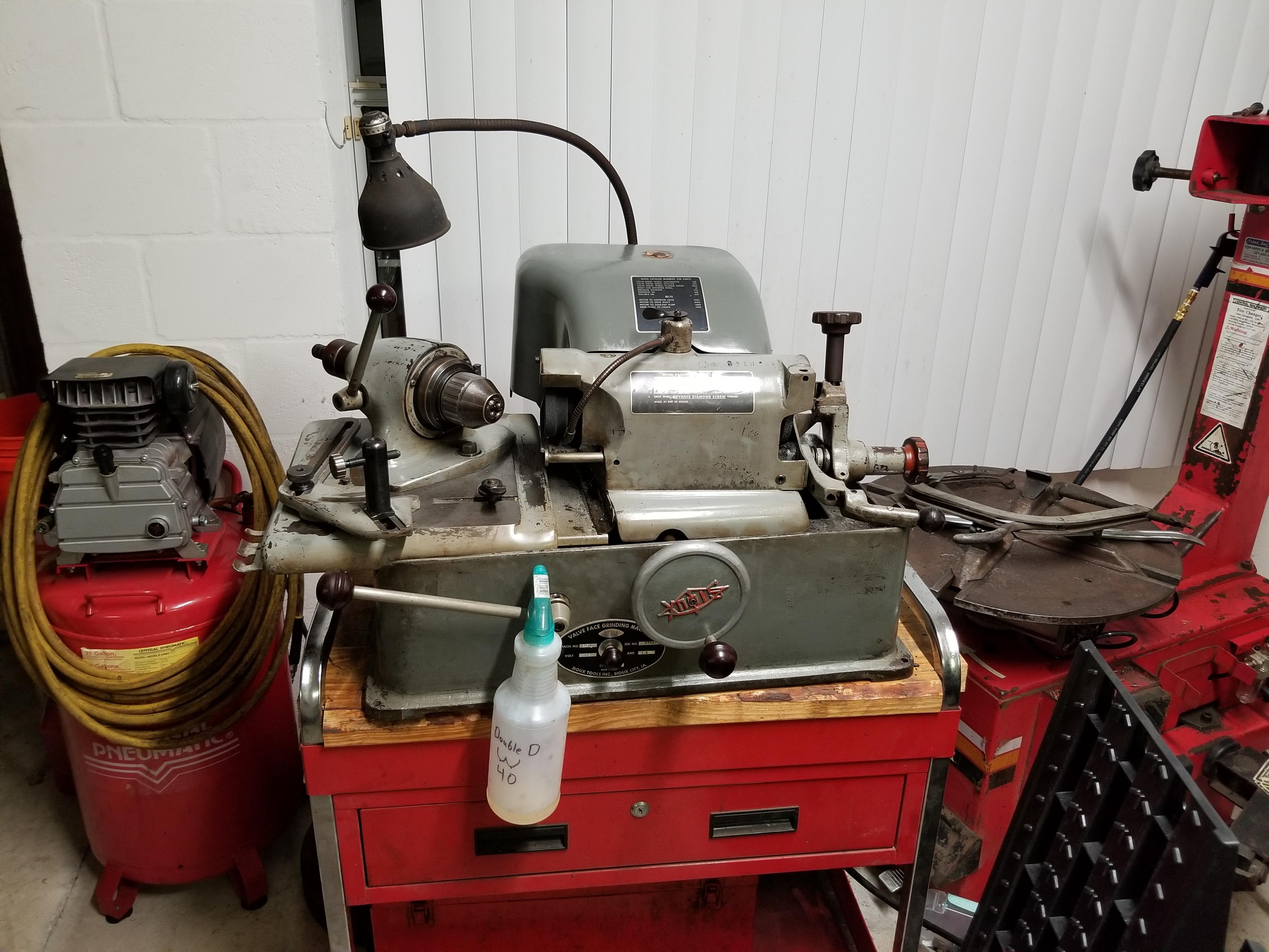

    Those are sweet old machines. A couple of the shops I worked in had them and they always made a pretty nice looking valve. Do you have the concentric seat grinder that came with these? I think they were additional money but the shops that I worked in had both. The concentric seat grinder isn't state of the art but they worked OK.
    I have "A" seat grinder. I don't know if it's the one that came with the machine though. One of these is what I learned on as a teenager. Now that i think about it, It's been quite a few years since I ground my own valves and seats. I enjoyed it back then and am looking forward to it. Plus I have several other sets of heads stashed away I can have some fun with at a later date.

    It needs a little cleanin' but it will do.

    All cleaned, lubed up and ready to grind some valves.

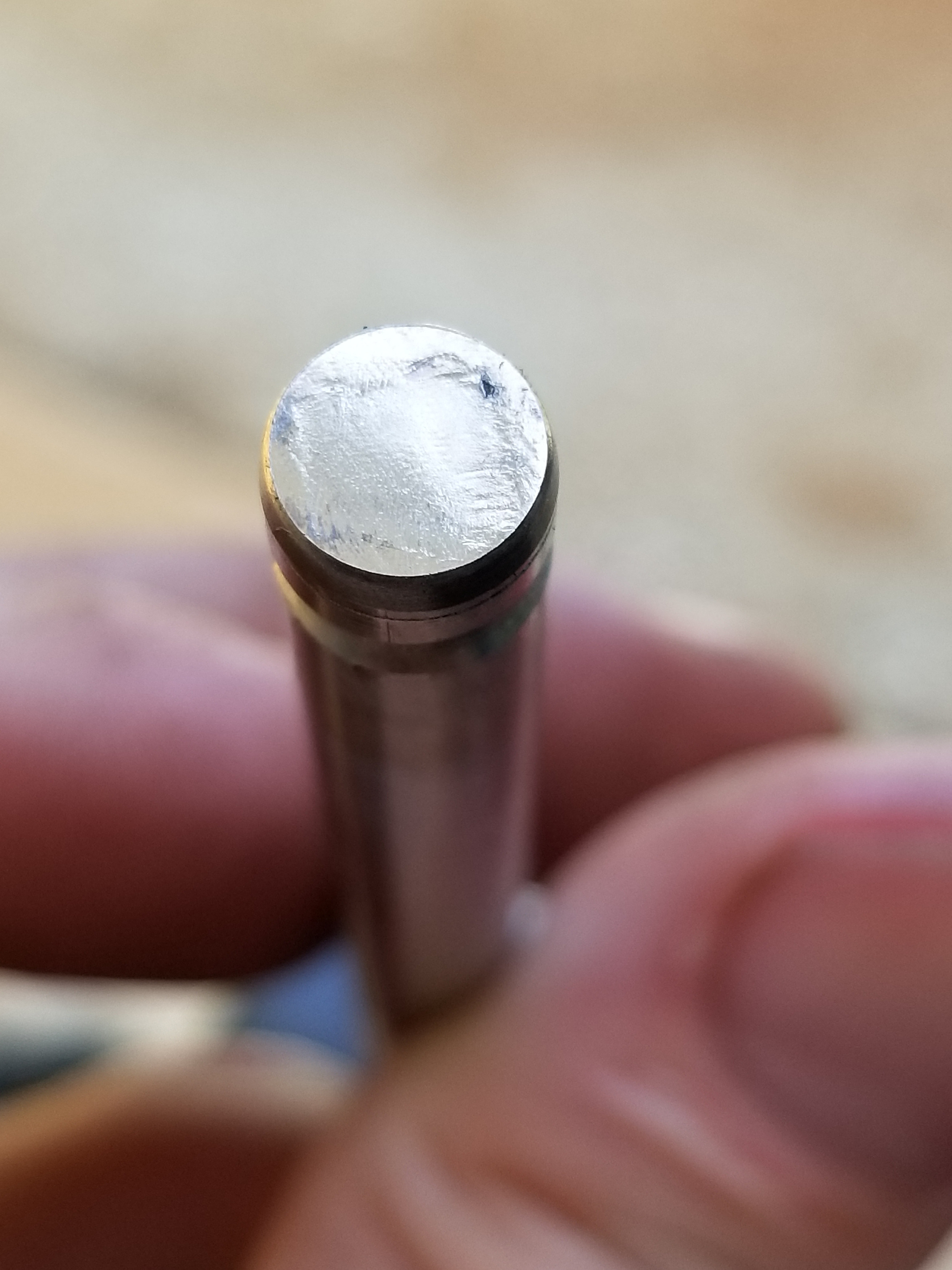

    Not as bad as i was expecting once the exhaust valves were cleaned up. They will probably clean up with a grind but I may just replace them.
    Tips weren't looking too healthy. I'll have to find the specs to see how much can be taken off.

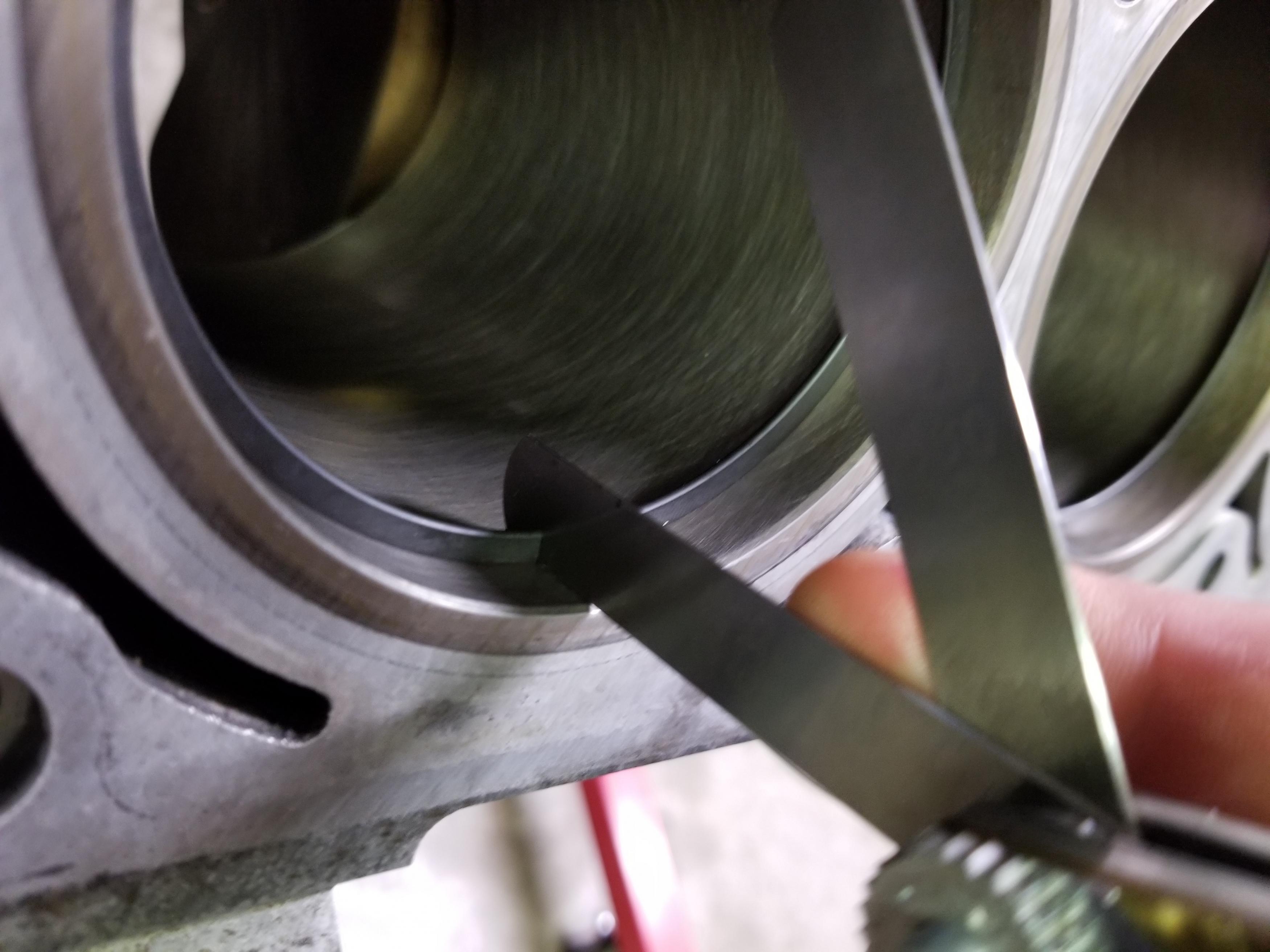

    Minding that gap...
    All gapped and ready to rock. Note - the silveryness of the gap is from the ever so slightest whiff of the file when knocking down the burr. They aren't chamfered there I assure you.
