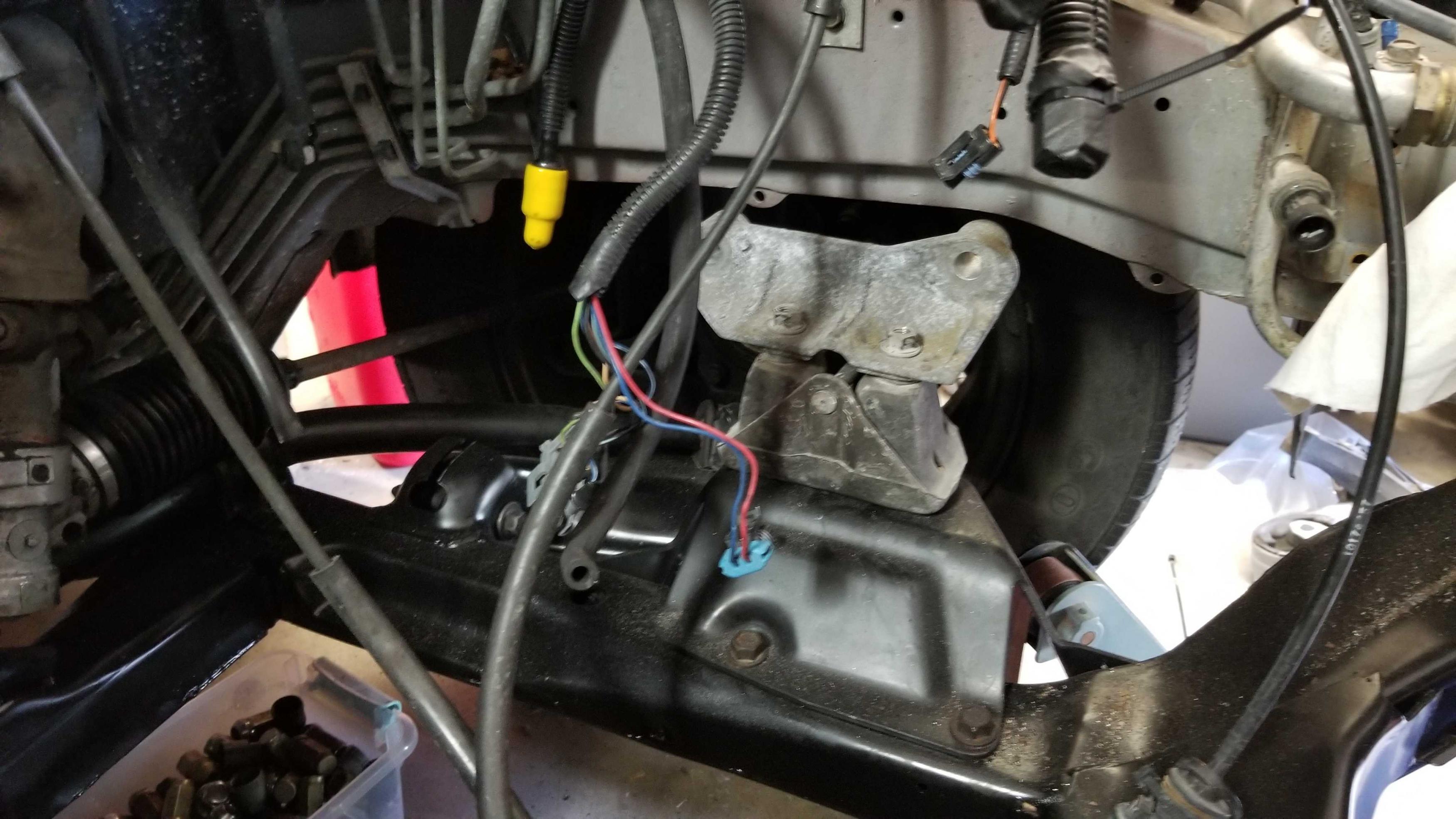

    So I think my idea of using the stock mount in the stock location is no good. The G6 F40 bracket bolts to the stock mount just fine but my quick and dirty measuring tells me it's too high and too far forward. Not a big deal as I was expecting some fabricating of the mounts. But I also noticed that I might also have to notch the bottom portion of the drivers side frame rail after rough measuring the dimensions of the engine and trans. The frame rails taper inwards as you get closer to the firewall. and the F40 is a little bit wider than the F23. Again, no biggy but I was hoping to not have to do that. We'll see what happens when I try to stuff it in there.
    Click image for larger version  Name:	20220821_152618.jpg-comp.jpg Views:	0 Size:	561.3 KB ID:	1324992

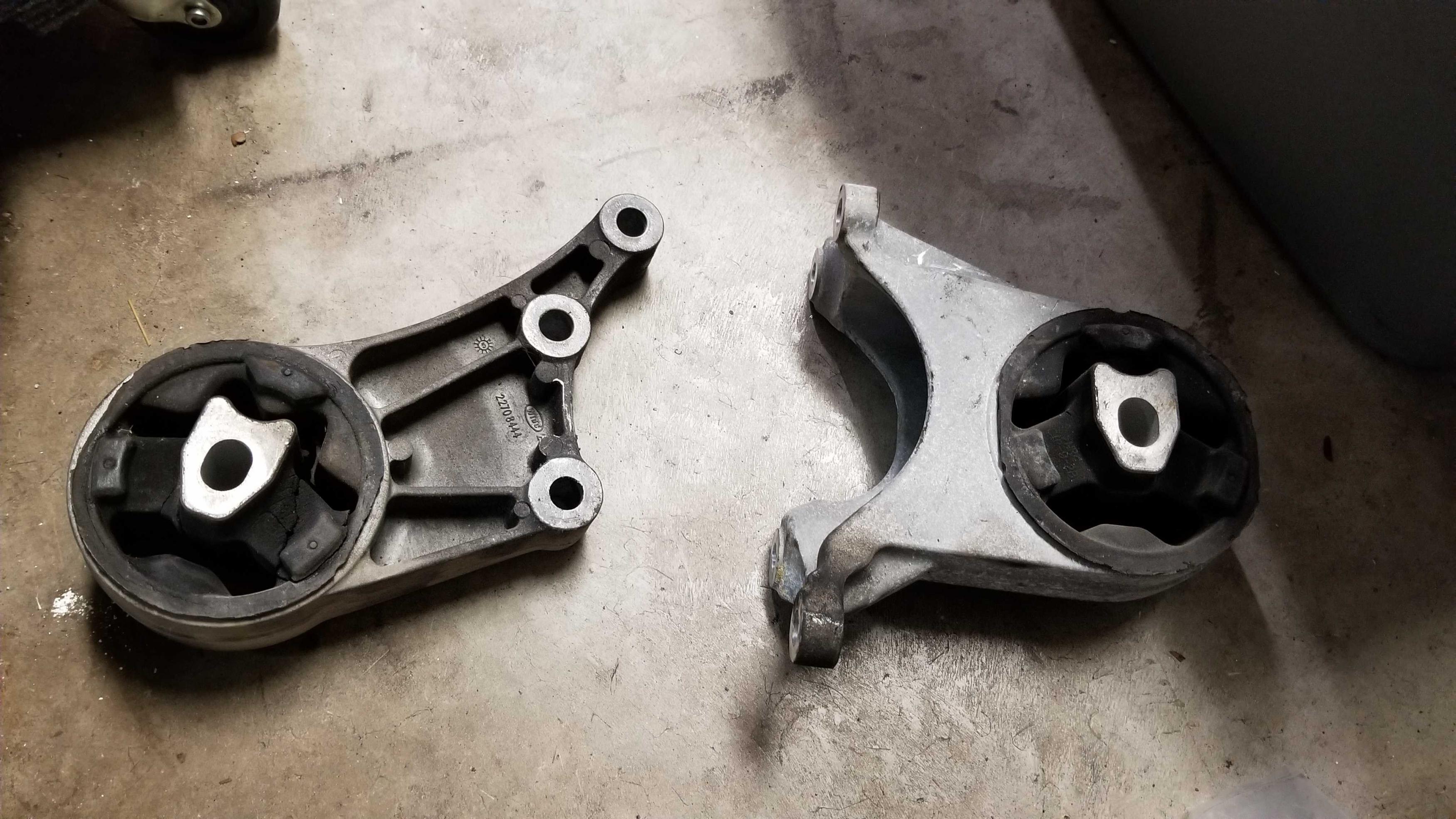

    these are the Rear (Left) and front (right) G6 trans mounts. The Front mount wont work after the transmission is modified for the starter. The rear I might be able to use. Just have to wait and see once it's sitting in the car.
    Click image for larger version  Name:	20220821_175139.jpg-comp.jpg Views:	0 Size:	753.2 KB ID:	1324993

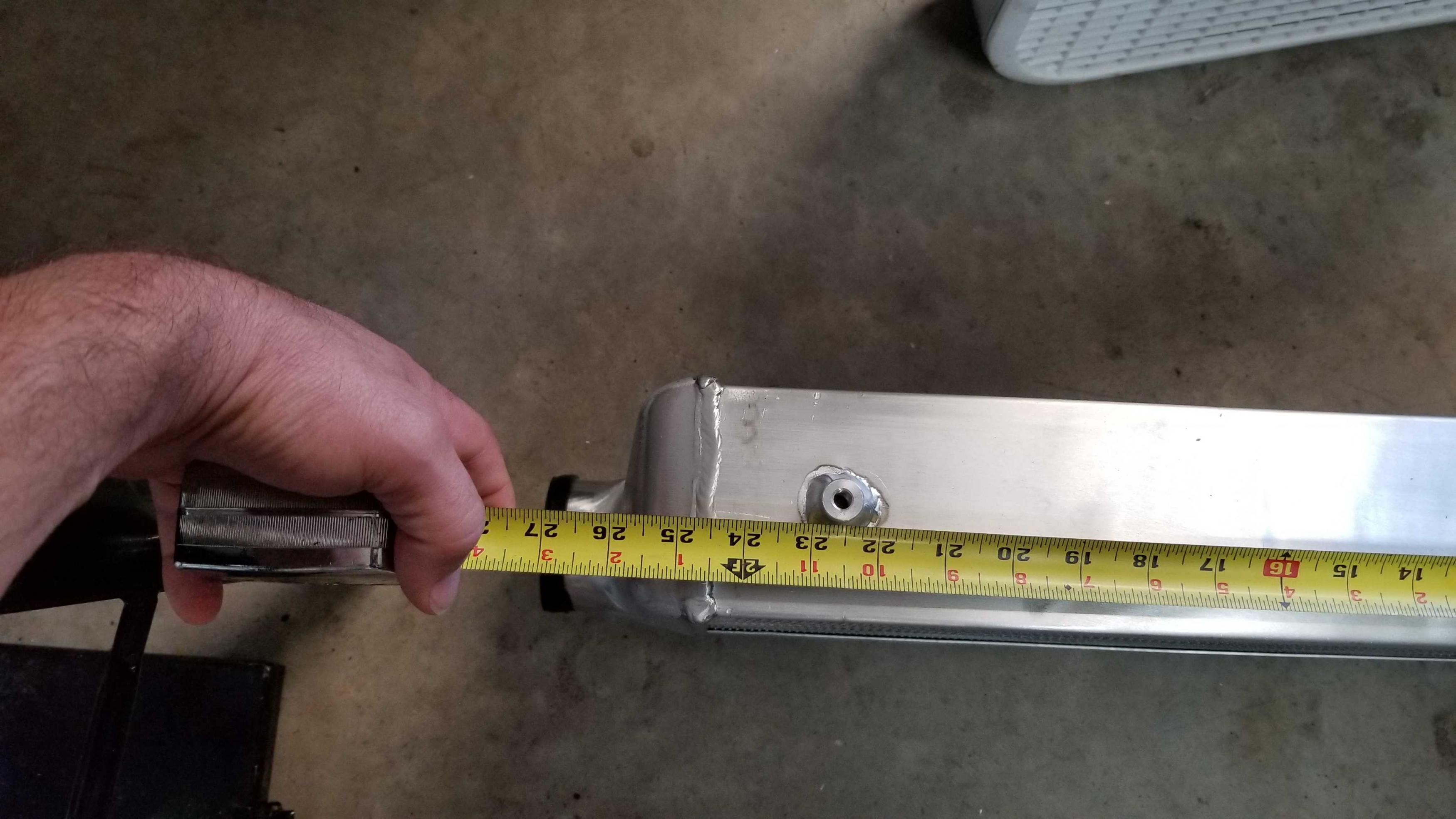

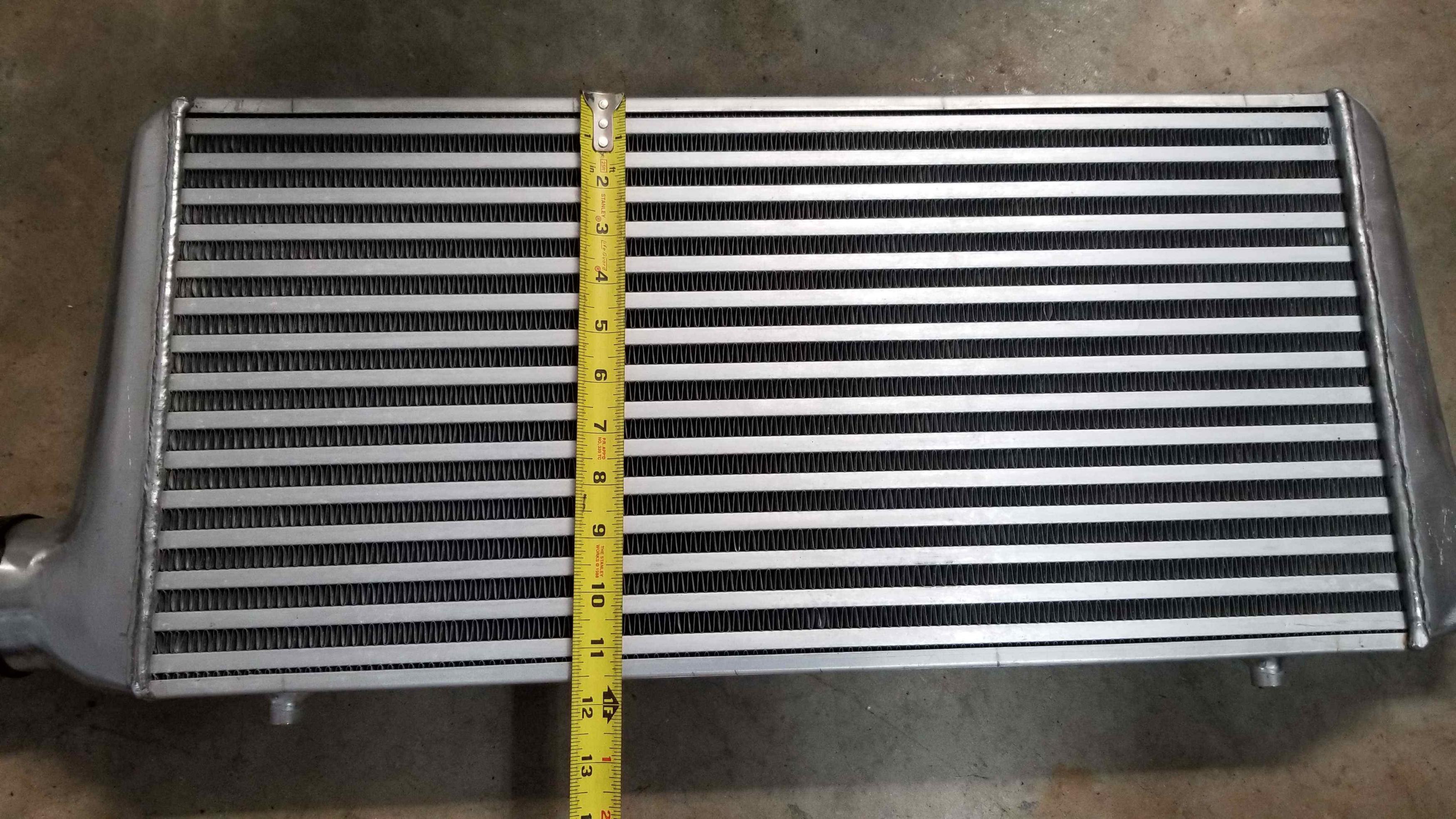

    Decided to mock up the intercooler placement this past weekend. It fits in the car really well!

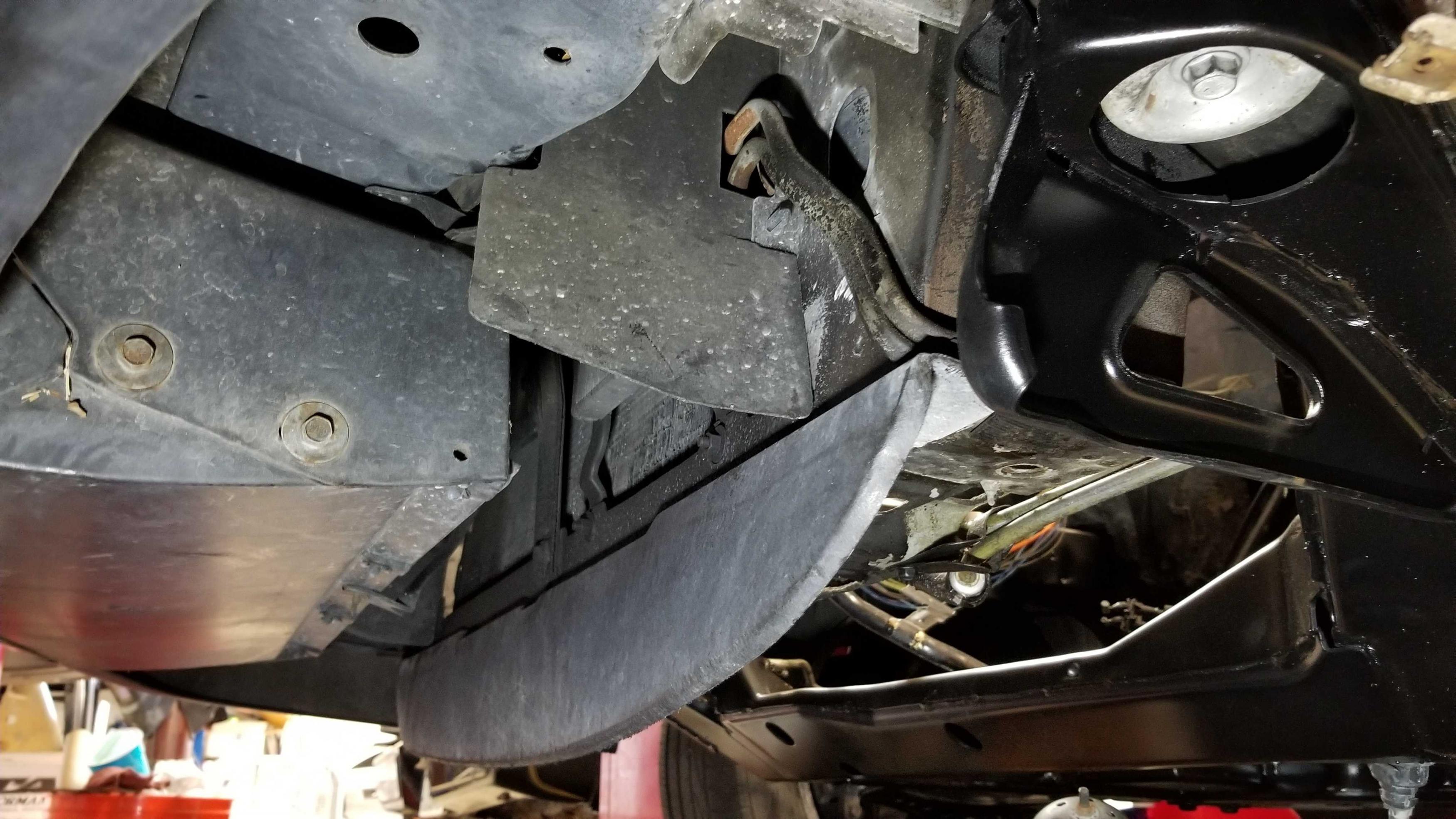

    Shot from the drivers front showing what all is and isn't in the way.

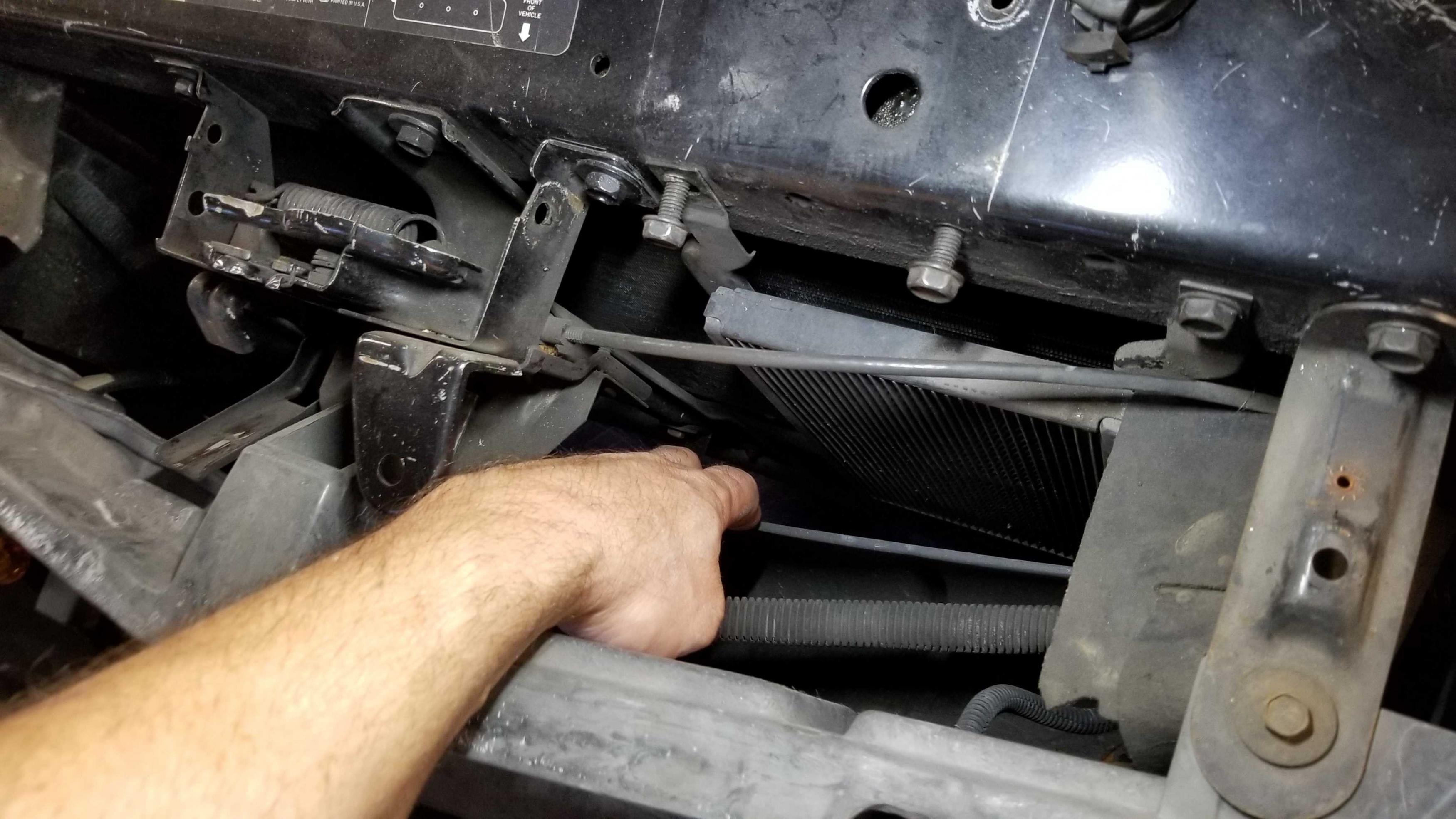

    Hood latch support. I'll rework this and put it back .

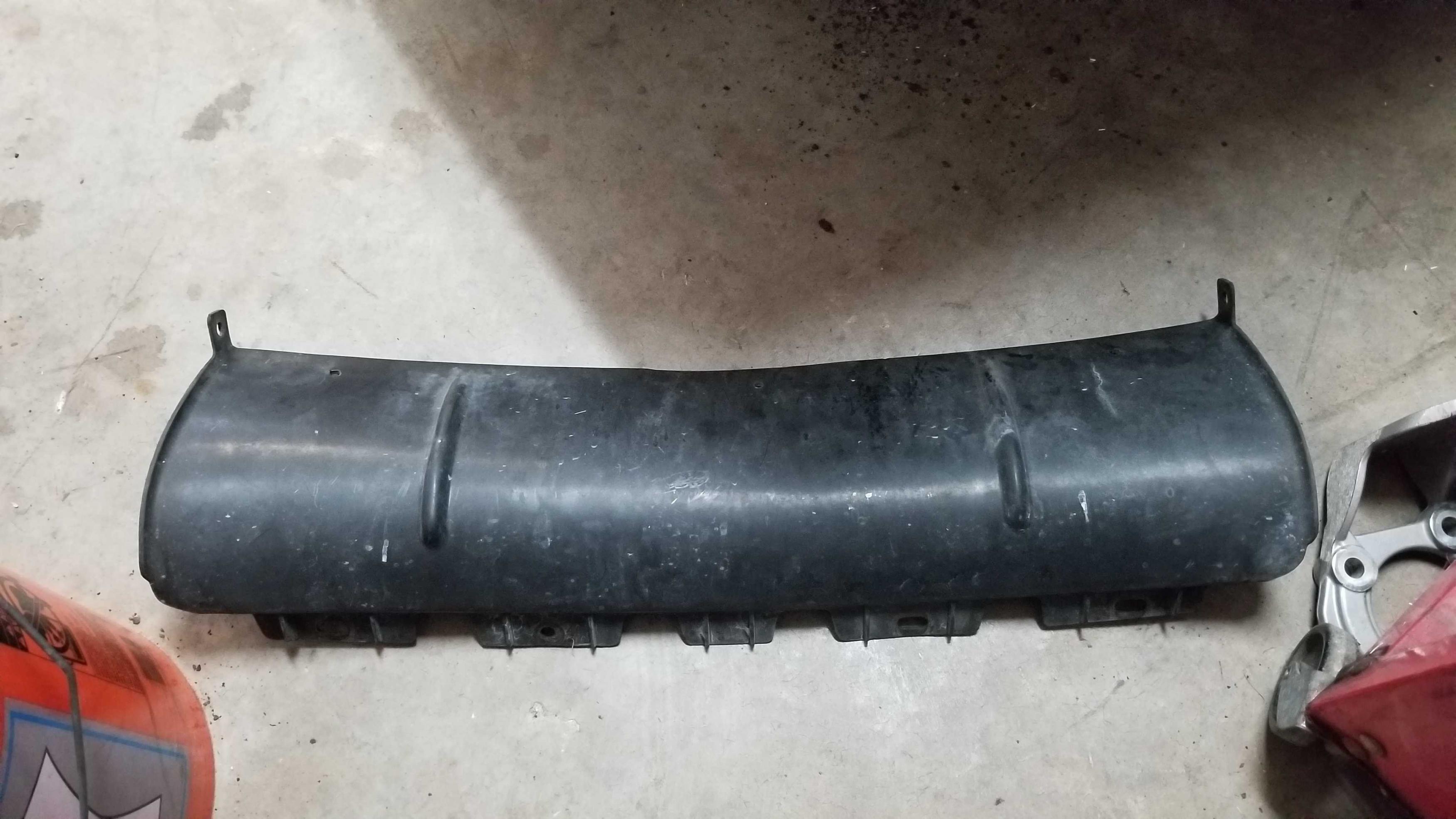

    This will get trimmed up and put back in to help with air management. My hand is on it in the picture above when I'm reaching down from the top.

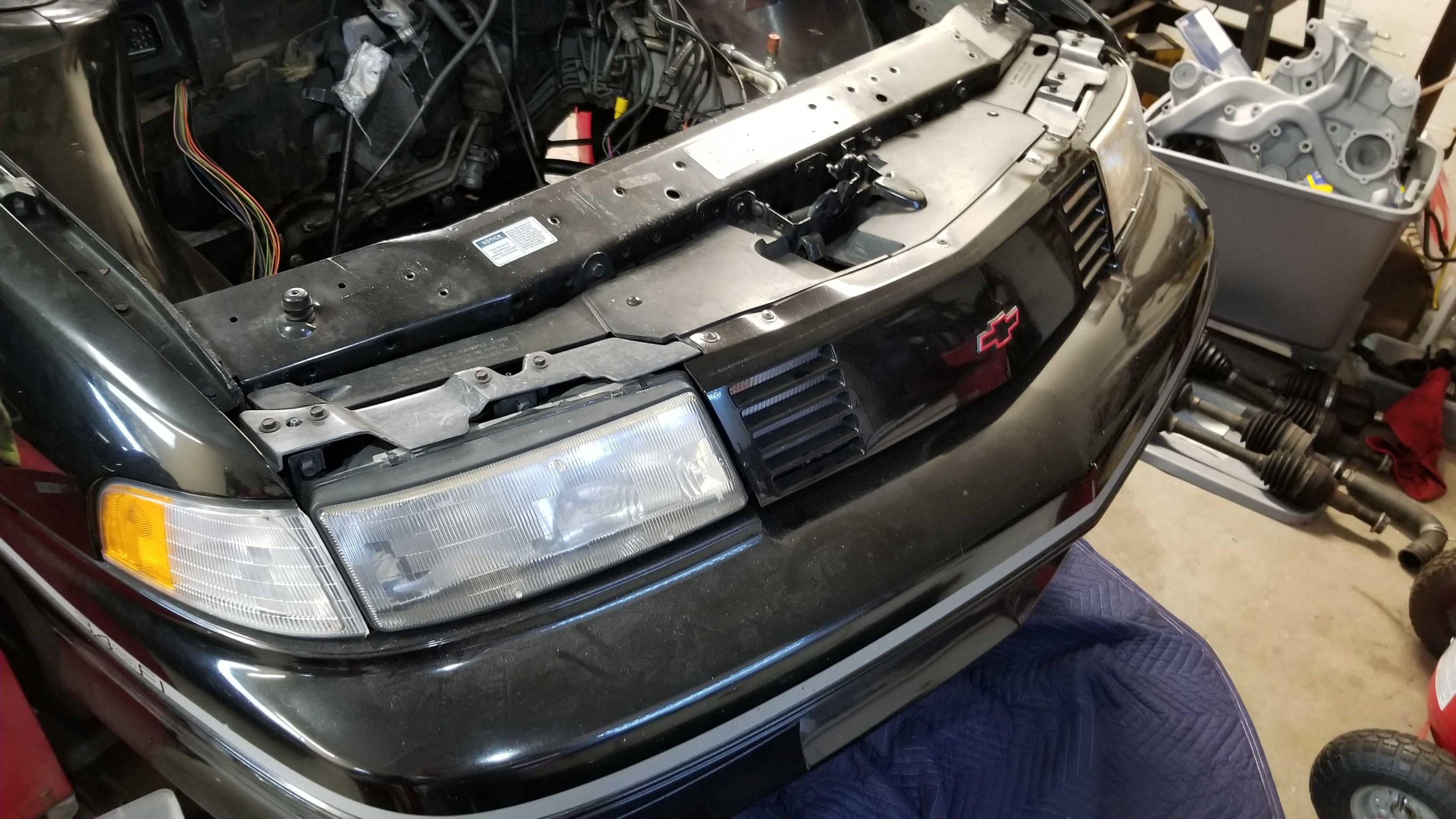

    Like a glove! Ignore the temporary brackets.... Although, I'll also give 5 fake internet points to whoever can tell me what the brackets are from.

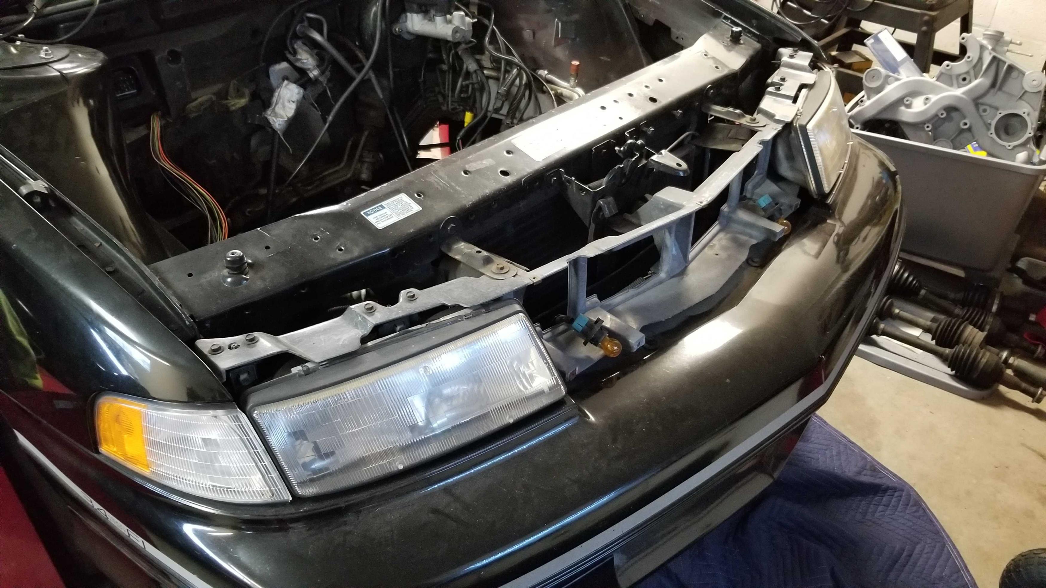

    Drivers side. Slight trimming of the closeout material is needed.

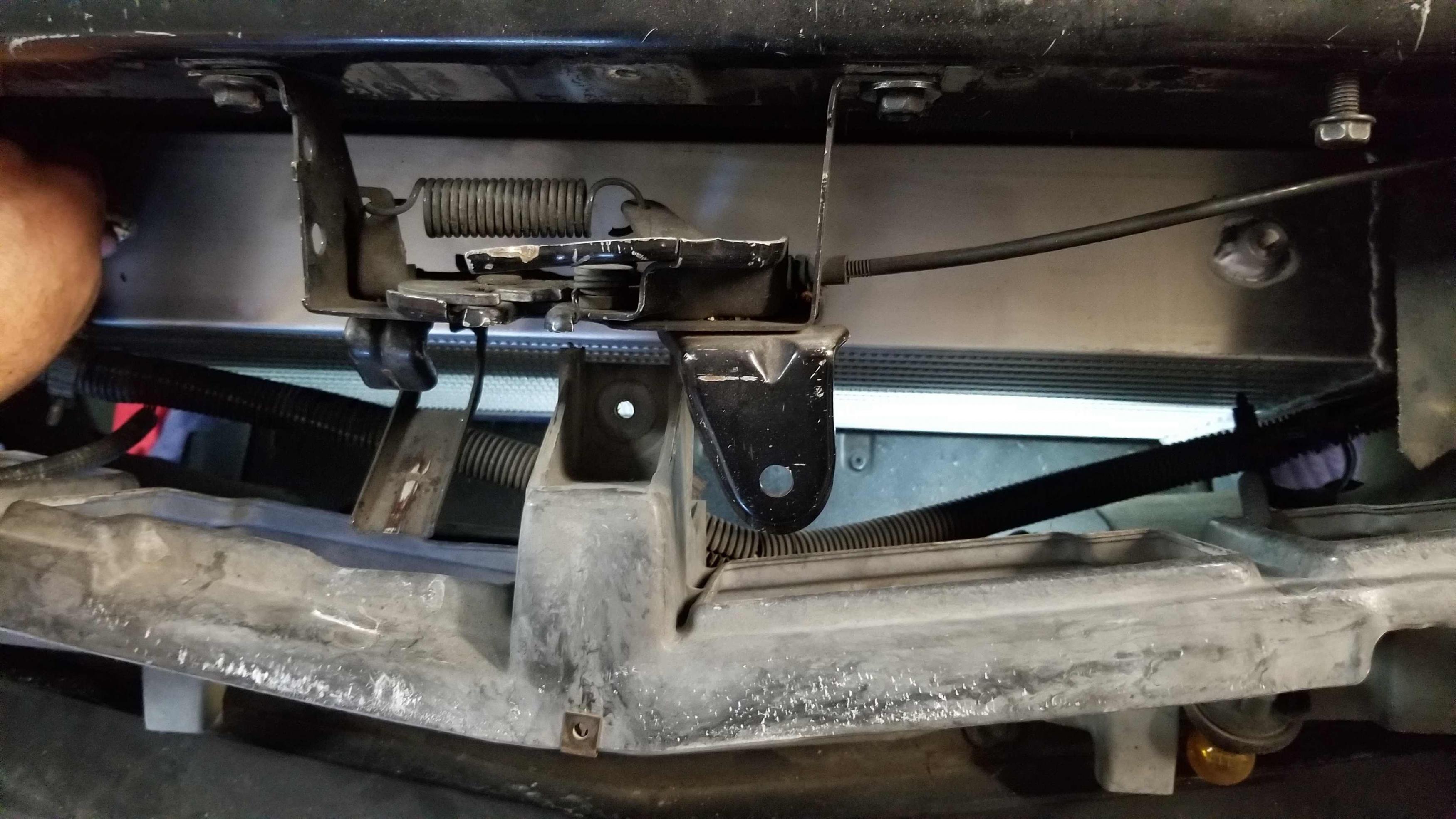

    No need to modify the hood release. Good news! Fits almost like it was made for it.

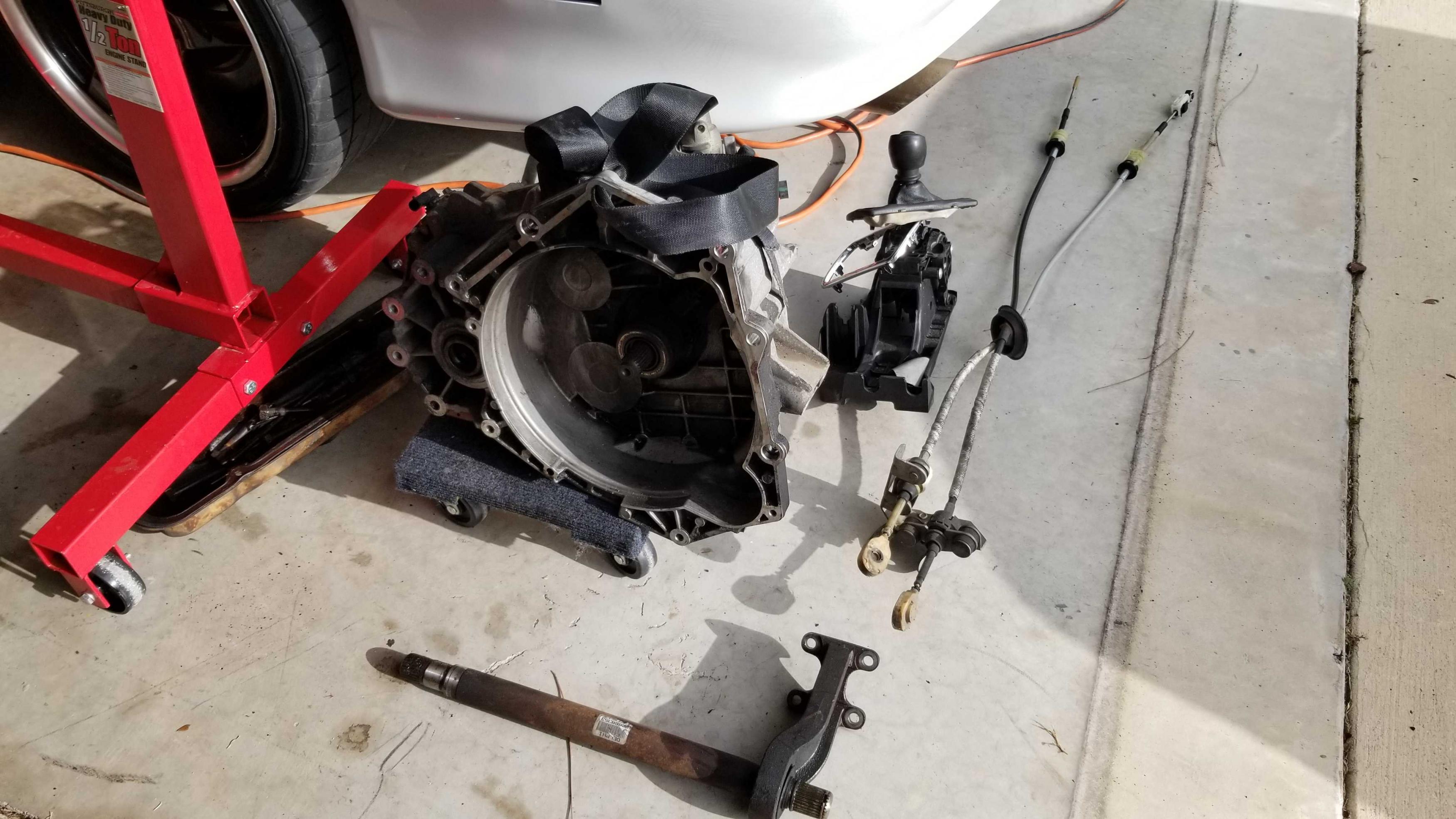

    Got the F40, Jack shaft, shifter cables and shifter. Just happened to find a local auto recycler that just got a manual G6 in. Paid more than I'm used to at the U-pull-it joints but I justified it since they did all the work to pull the stuff and they were awesome to do business with. Also talked to Spec on Friday. They are making the flywheel and clutch setup. Once those things show up, I can bolt this thing together and plop it in the car. I was thinking too that since I don't need the LS4 computer to run the auto anymore, one of those Holly Terminator setups might be the way to go. It's way cheaper to run a stock computer and use HP Tuners since I already have it but I've been kinda wanting to try the Holley setup.
    Fixed picture I think.
