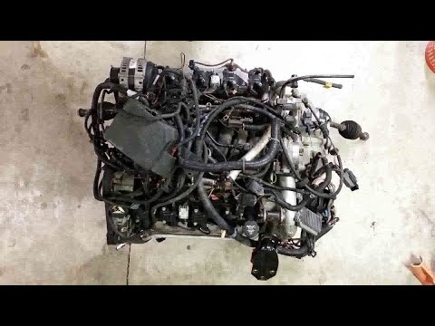

          So I'm going to take an image dump all over this place the next few days to catch up to where I am on the car right now.
          The donor car was a 2008 Impala SS sitting out in one of my favorite junk yards. I'll sometimes go wander through the yard during the week to see if there is anything good and then come back and hope it's still there on the weekend. Luckily this one hadn't been touched yet.
          Well that was easy. One LS4 with trans, CV shafts, accessories, harness, and computer. came out to be $526 bucks including core costs since I wasn't bringing anything back.
          Poor Impala.

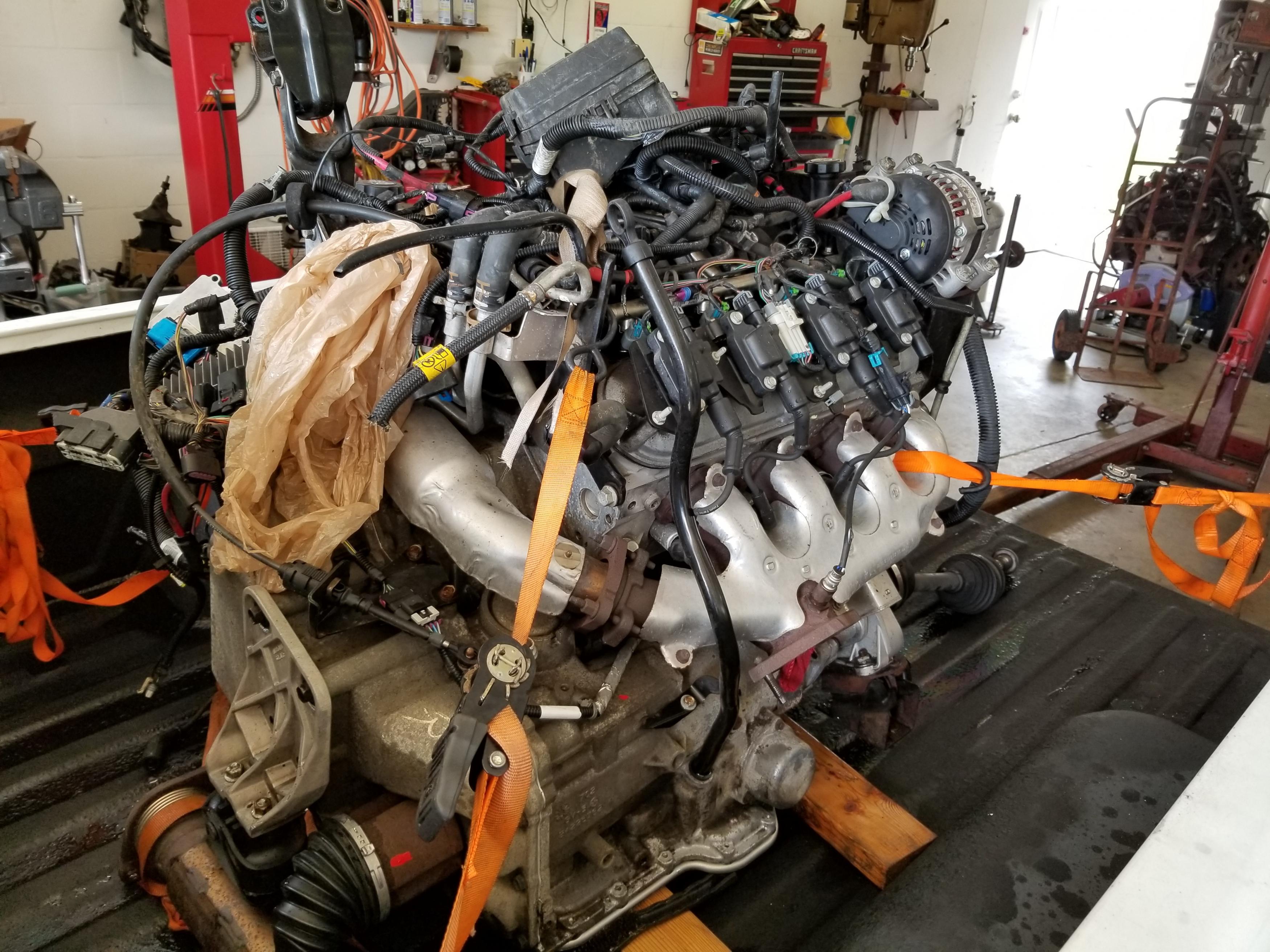

                Unloading the beast after hosing off some of the oily bits.
