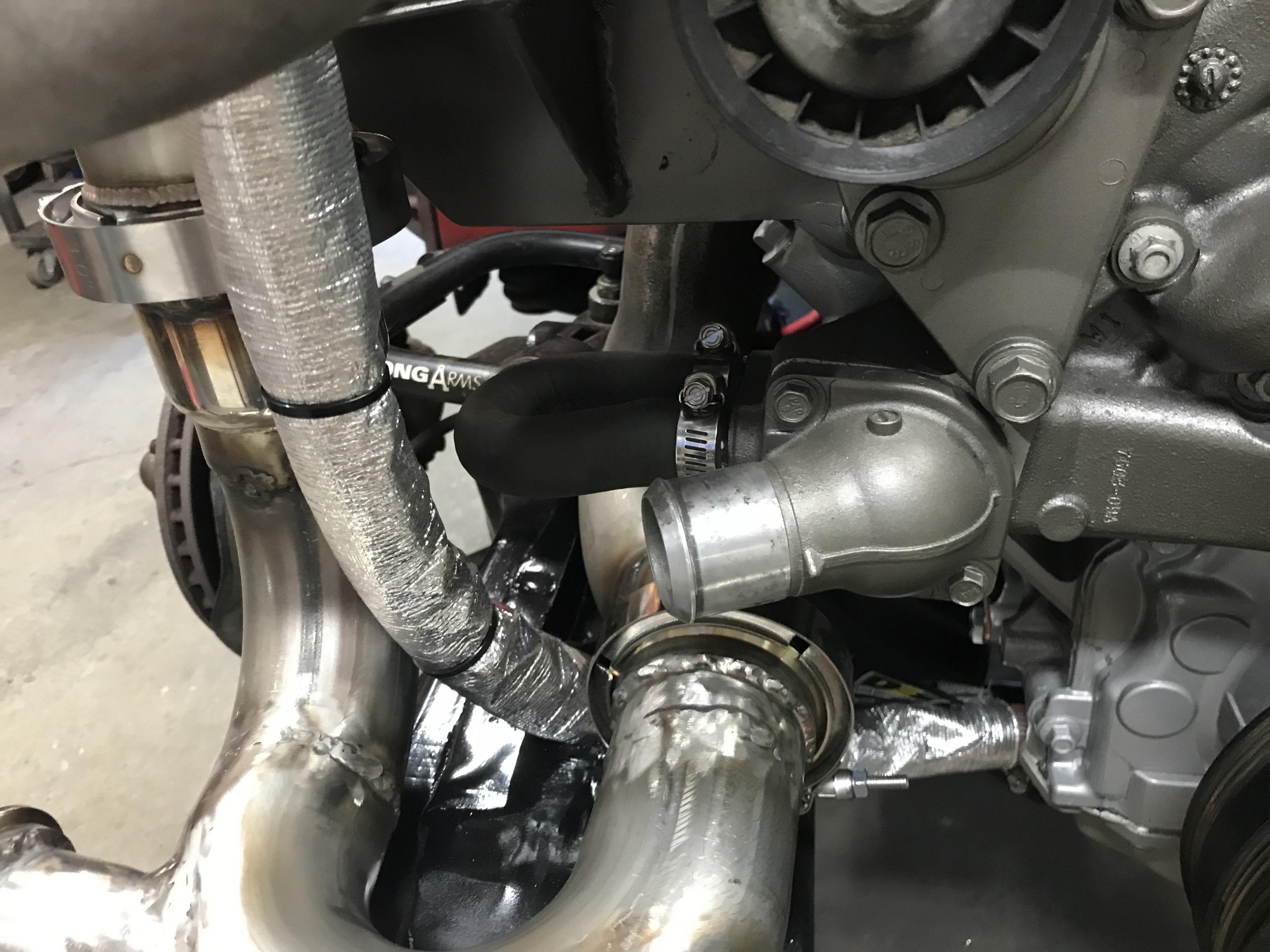

ID:	1296161 Ah shit !
    I'll Bite........
    That Knot past the break,.....was so the 12V neg grd Juice didn't LOSE PRIME ? !!!!
    • langleylad
      • 1694
      #197
      I'll Bite........
      Exactly , but it also looks like the protective cover that’s been pushed down. Nothing lasts forever except for taxes .

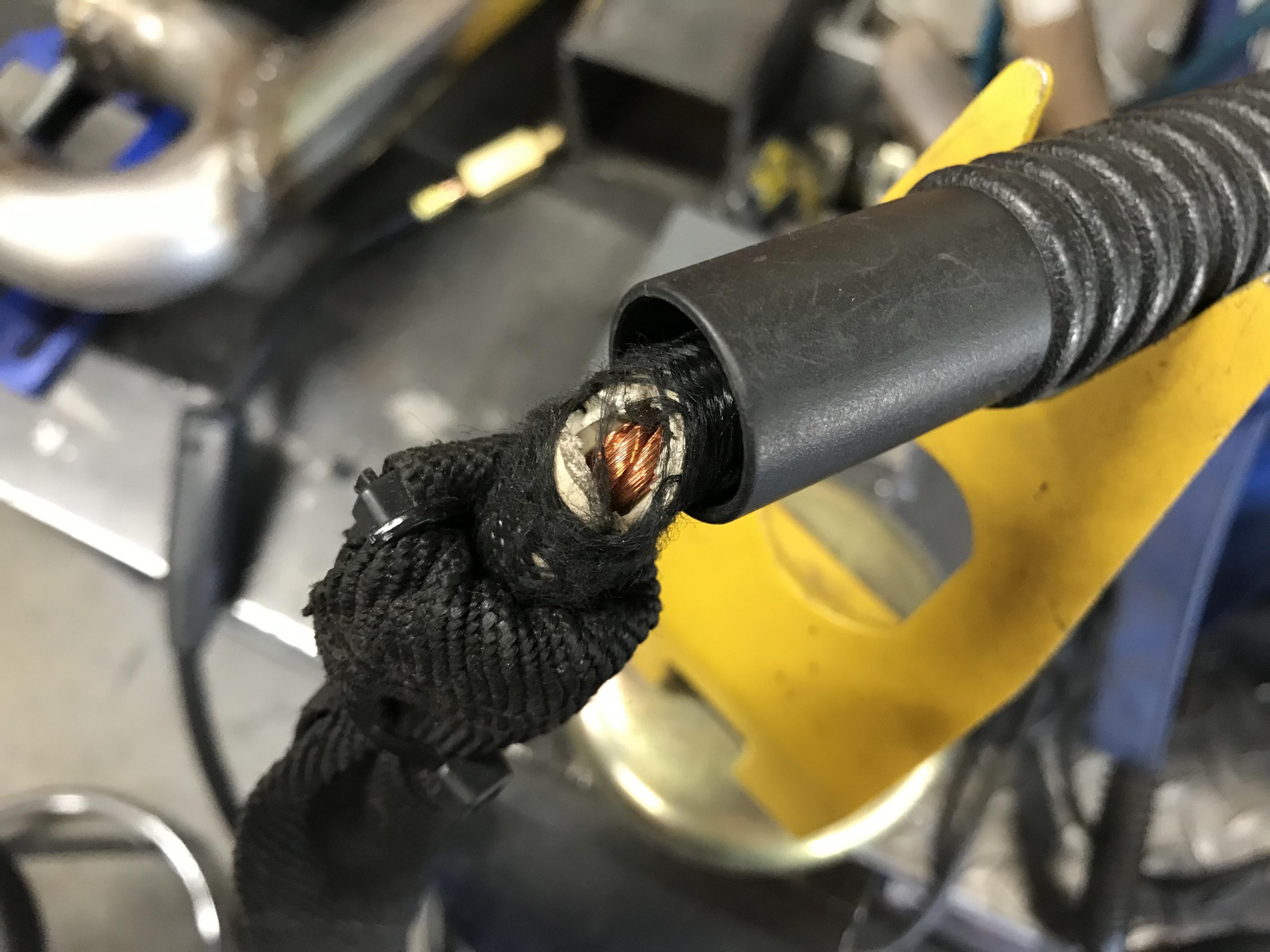

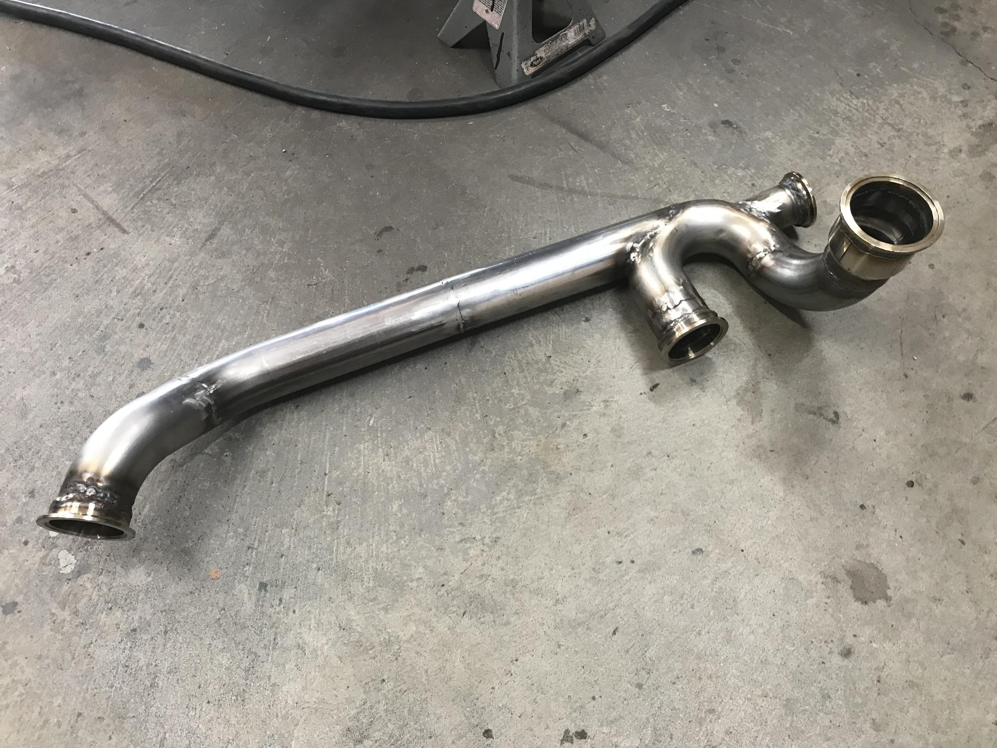

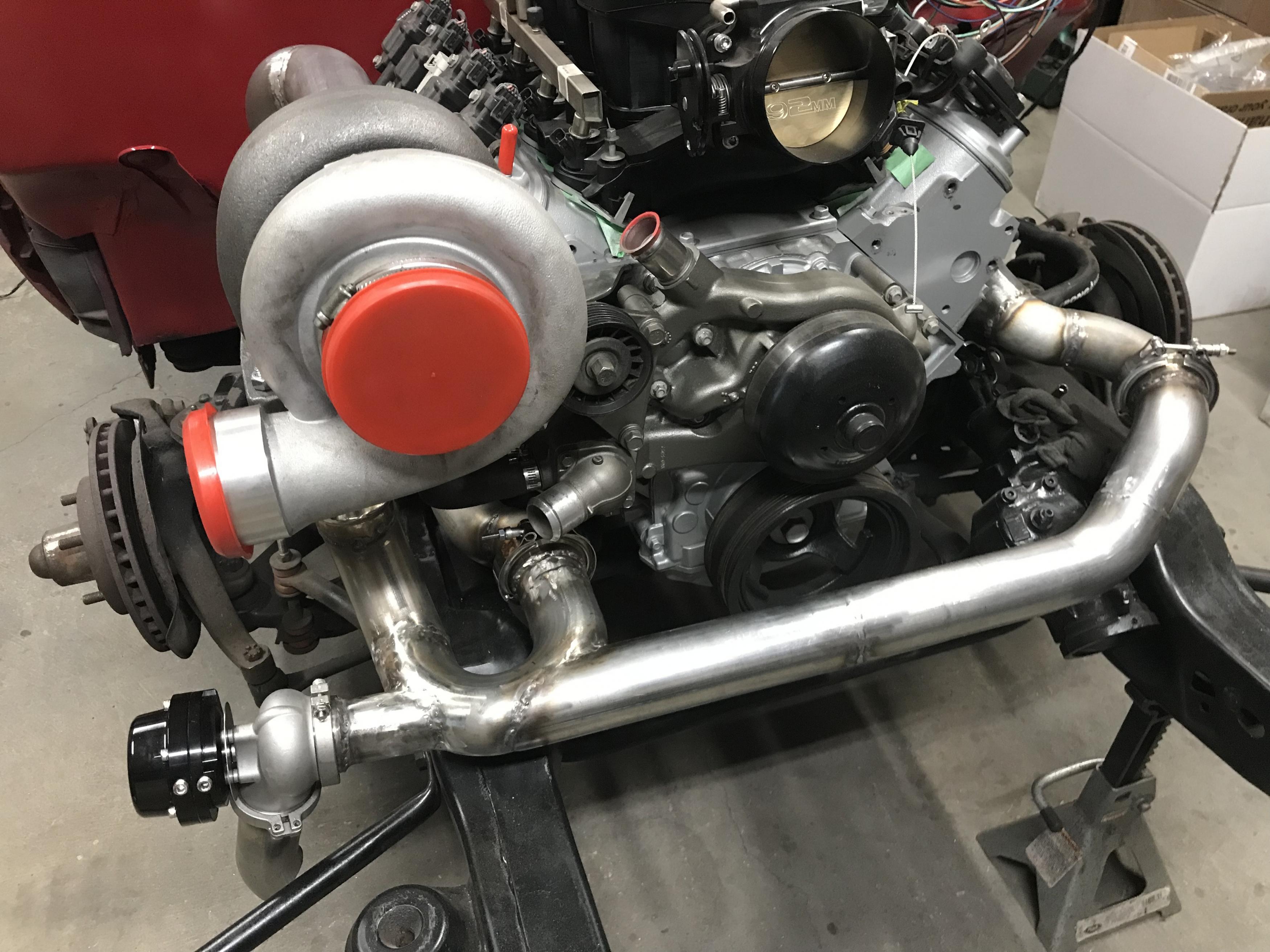

ID:	1297007 It’s funny how my welds have improved when the argon actually makes it to the weld instead of pissing out of a big bloody hole . Tig welding can be damn frustrating , 1 inch of nice weld followed by 2 inches of crap . Anyhow the hot side is done . I’m very happy with the design but the welds ….. not pretty but they’ll hold.

          I really like your hot side! Glad you found the hole in your torch. I am still learning how to TIG weld I am not laying dimes but overall I am please. The last bracket I made I tacked it with the MIG then went back and flowed the spots with the tig so they didn't look so bad. My favorite thing to do with TIG is a fusion weld where I am just melting the existing metal together.
          I think the welds loo fine as long as they don't leak. If the do mark with a sharpie and weld again. If you want them to look better run the TIG over them again with out adding filler. Dan told me the hardest part of body work is to know when to stop. I am guessing this is kinda the same.

            Were you looking over my shoulder ? . Once I “thought “ I had a complete weld (360 degrees) , I stuck a light inside the tube to find holes , then I’d mark them with a Sharpie and then go over them. I learned about when to say when, when I did the bodywork on the Cougar. Of course I have to remind myself of this . Fusion welds work great when you have a tight fit .

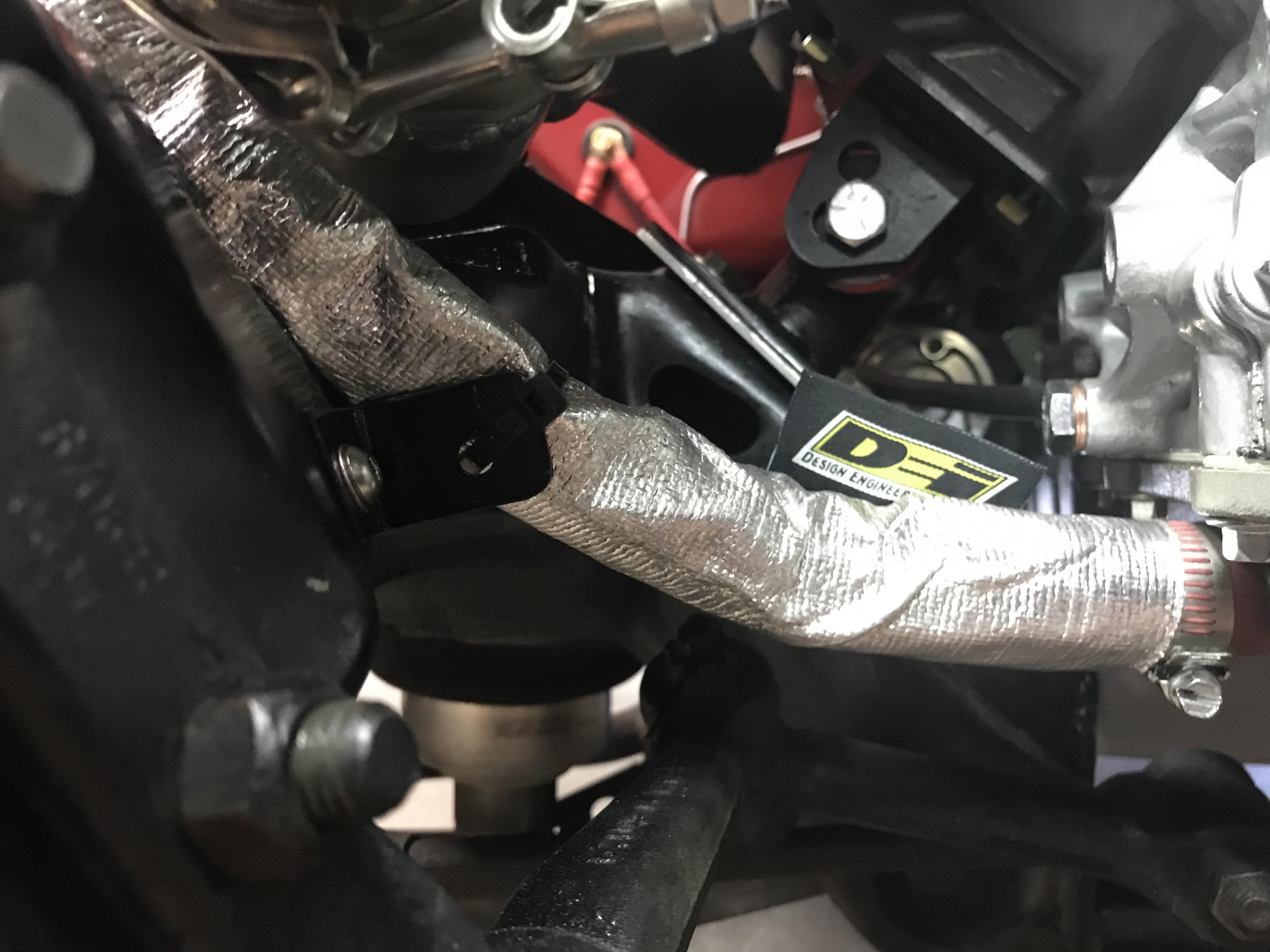

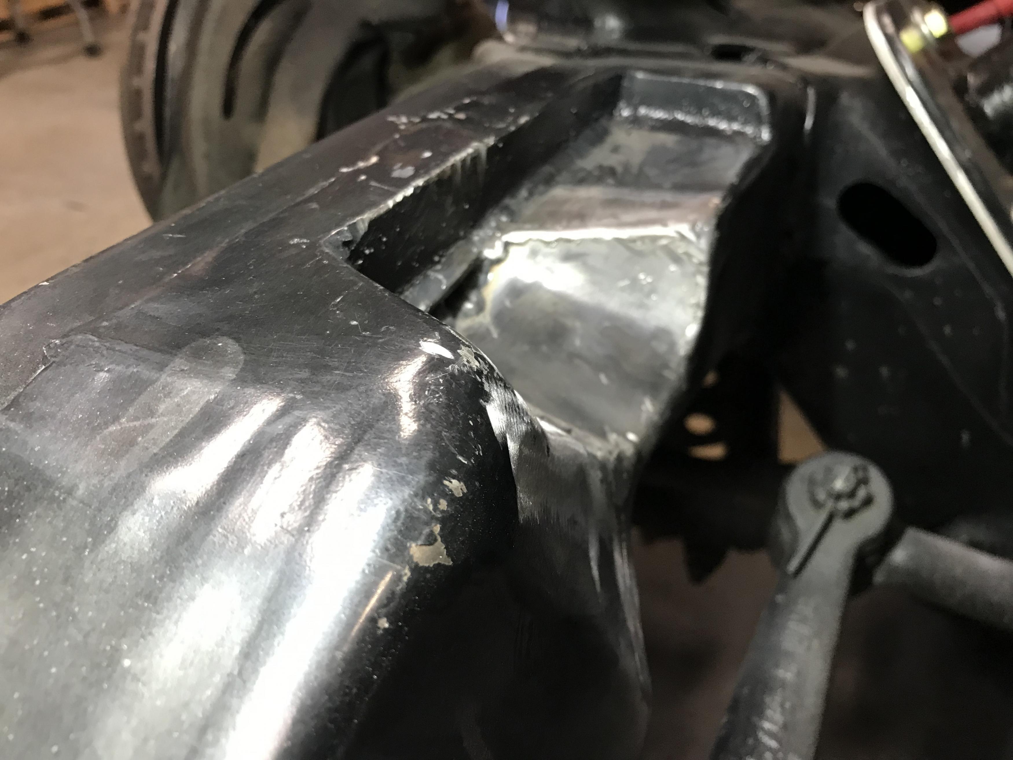

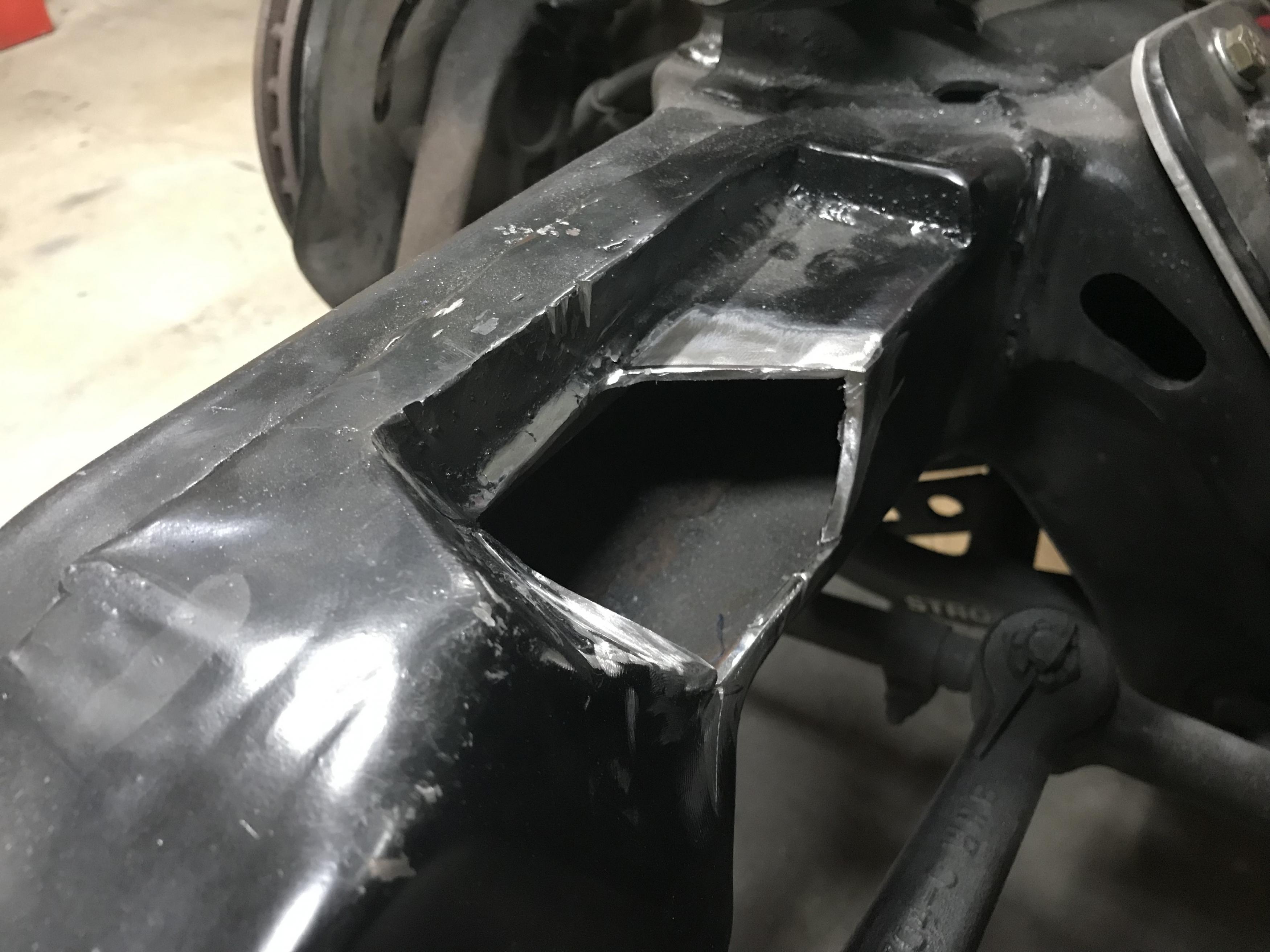

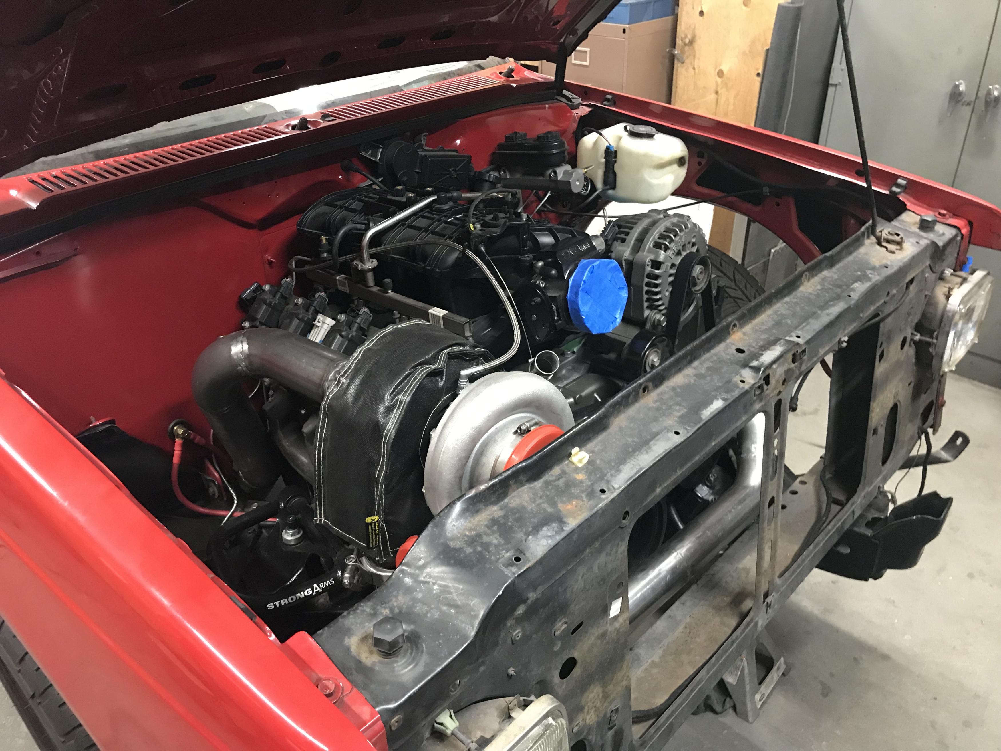

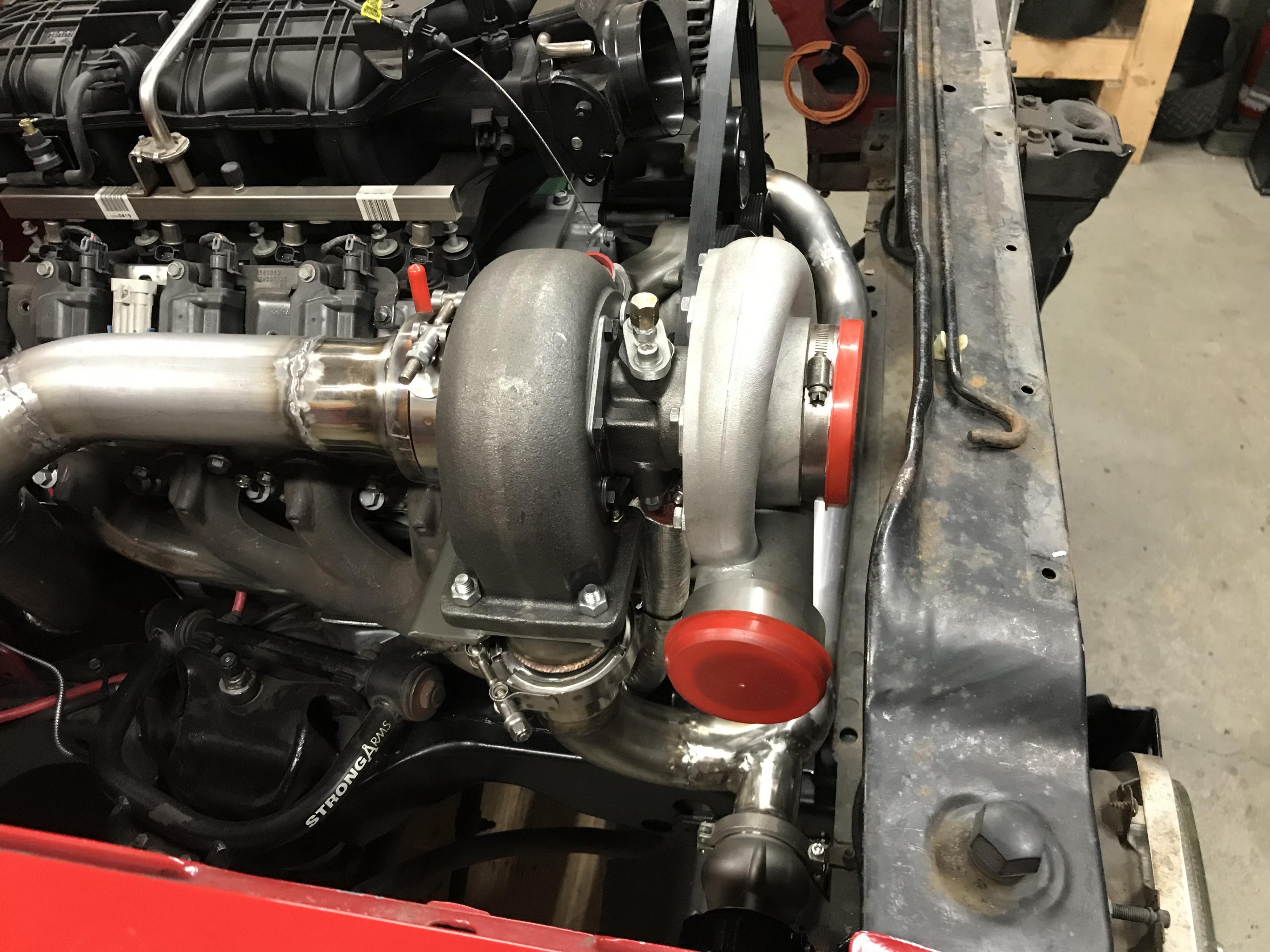

ID:	1298646 Once I had the hot side all together I thought it would be a good time to install a turbo drain line . To do so I had to make room by notching the frame “again” . Anyhow the job is done . I covered the hose in heat shield and secured in place with a simple bracket.

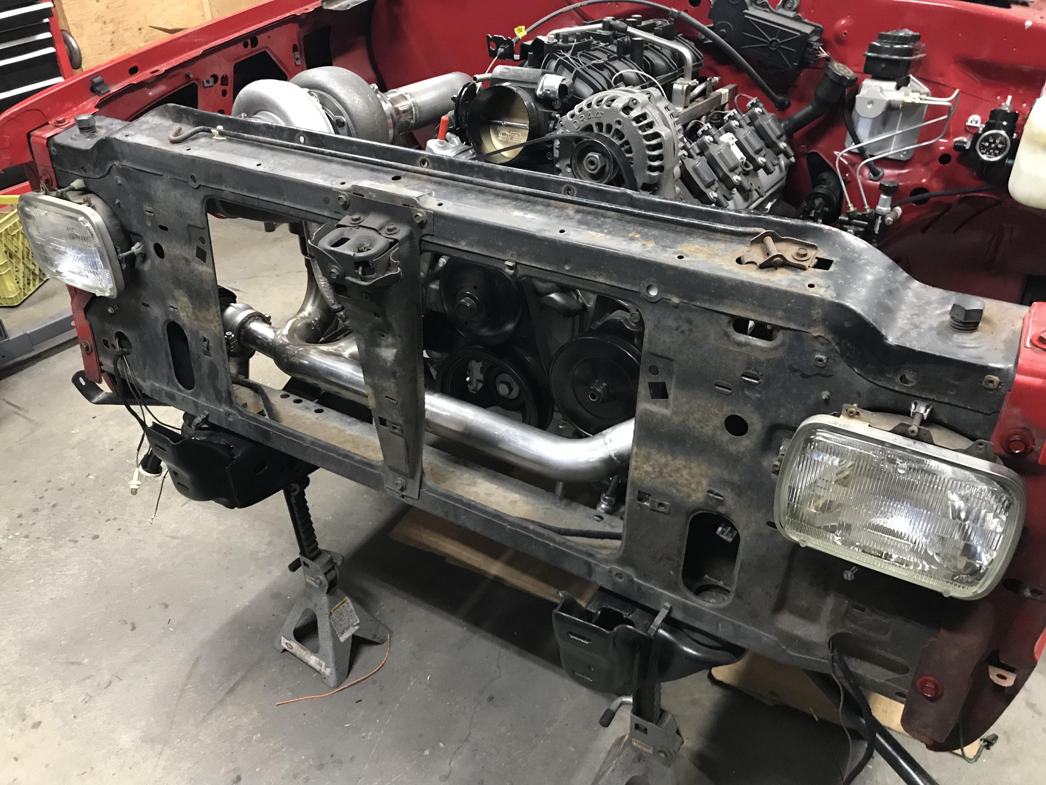

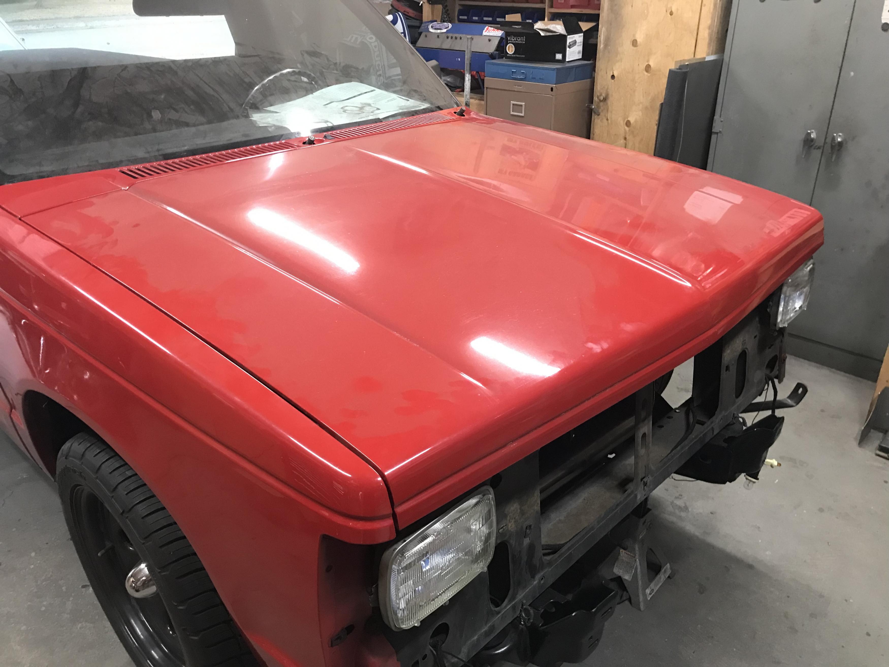

                    Update time . Actually I’ve got quite a lot done lately. I rewired the front end , back end , installed interior trim pieces and reinstalled the front fenders and rad support . I’m planning on redoing the rad support , I need to find room for a rad and intercooler . I’m thinking a 1” box tubing structure to replace the bulky sheet metal piece . I can see this engineering project interfering with my sleep Click image for larger version

                      #205
                      The S10 core support IS bulky! I almost did something similar with mine but I did get everything to fit so it's OK for now.
