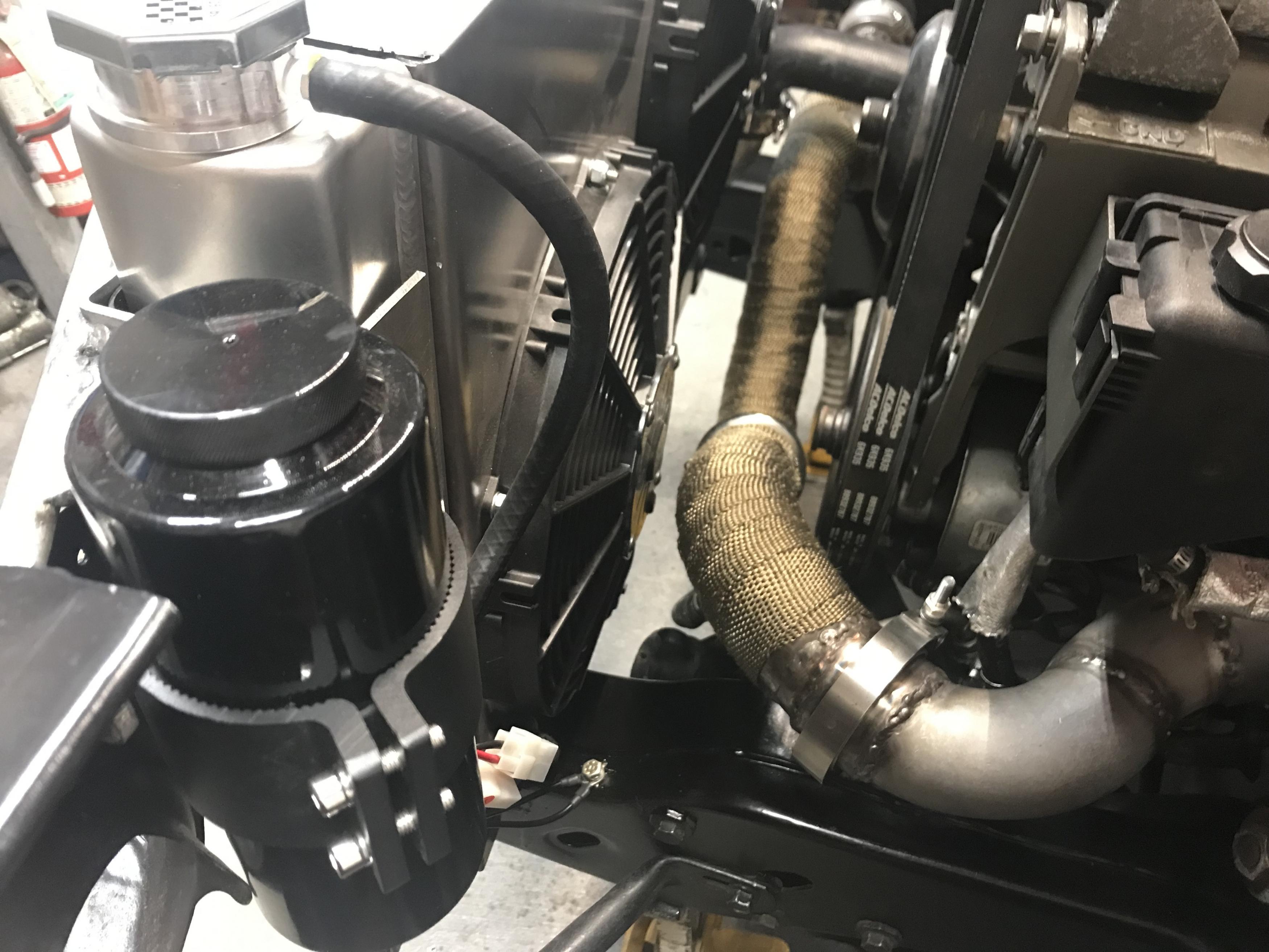

      • Now that most of the fabrication is done I can take it apart and make things pretty. I needed to finish welding a section of the frame , clean and paint various parts , wired in the Spal fans , heat wrapped the crossover pipe and installed the radiator catch can . I bought one of those cheap aluminum catch cans on Amazon. They come will some half-assed mounting bracket/hose clamp arrangement , I don’t do that. The can is 3 inches in diameter. So looking for a better way , I found on Amazon aluminum off-road light mounts. They are meant to clamp onto a 3 inch roll bar . 2 for $20 , that works for me. In the meantime I’m saving up for some Holley goodness ...

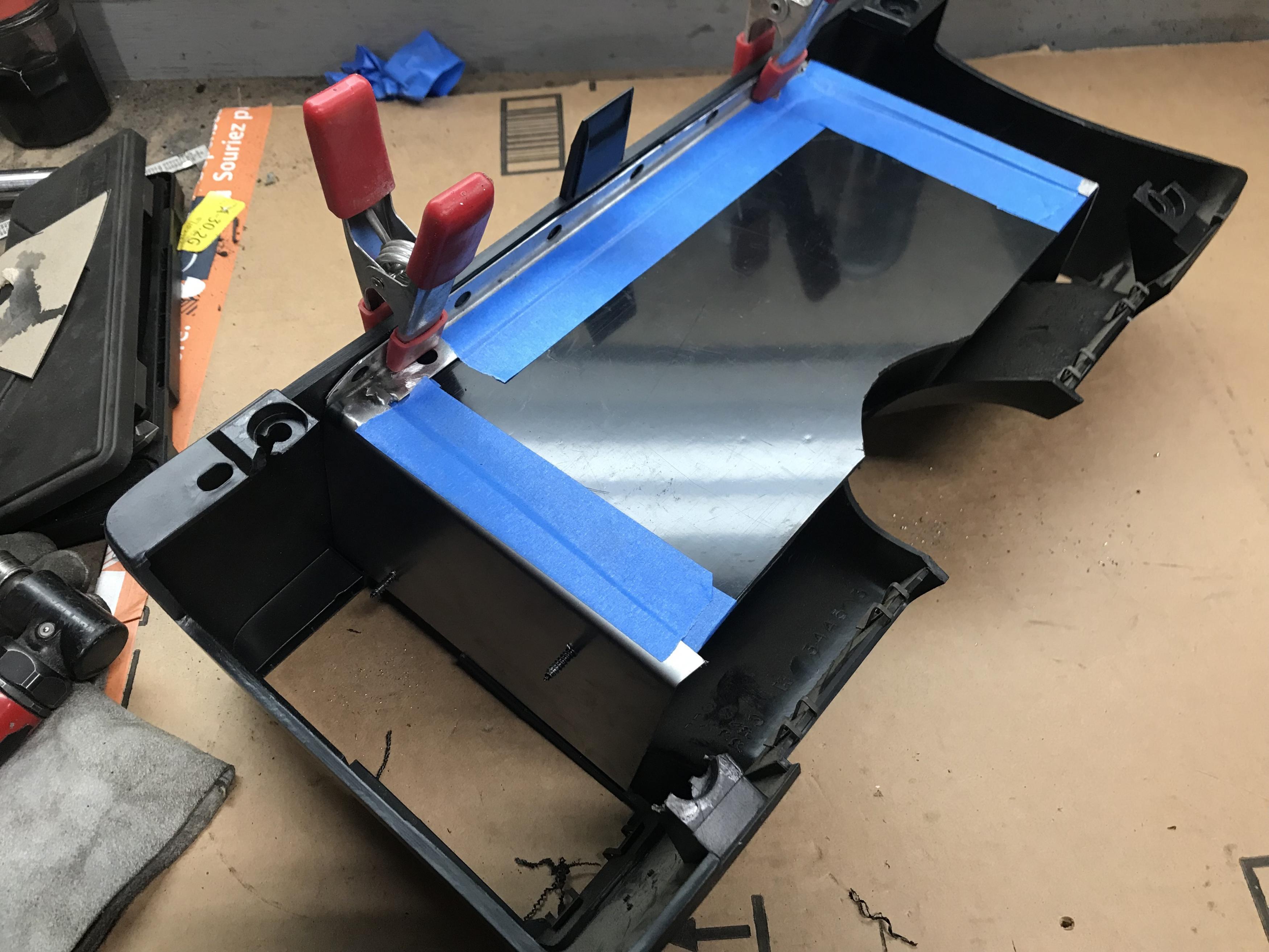

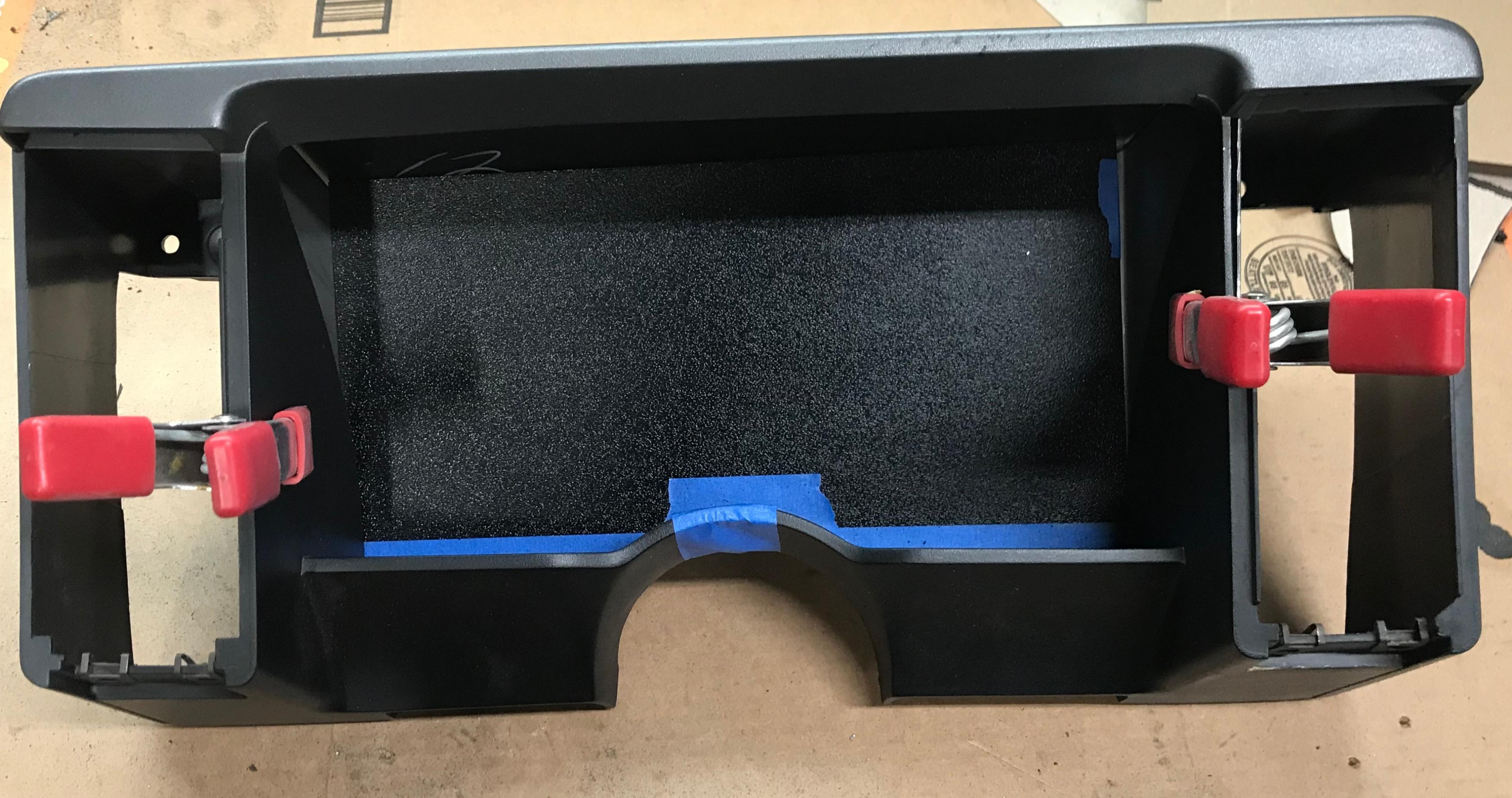

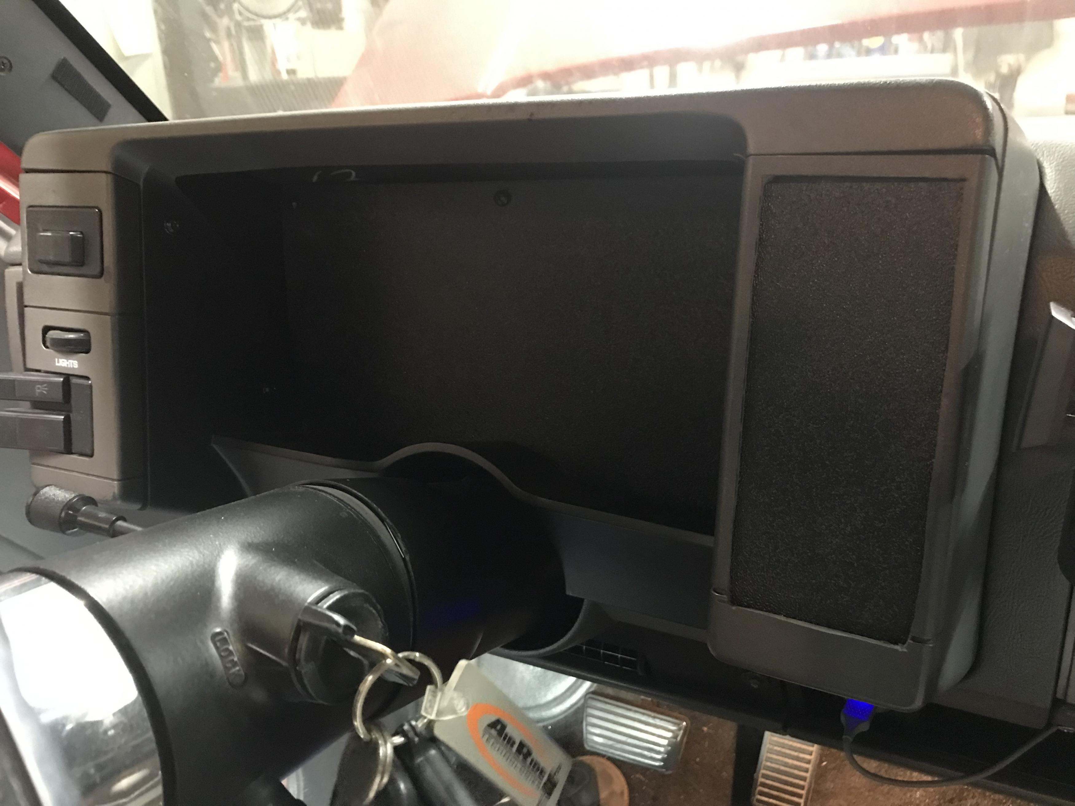

                        • Today’s project was to get the dash ready for a Holley 7” Digital Dash . I could spend $300+ for an aftermarket piece but why do that when I can make my own with material I already have plus I don’t have $300+ to buy one when I’m trying to save $ to buy the digital dash. I also deleted the heater controls and made a delete plate . I used some black textured plastic thats used by stereo installers from Amazon .
