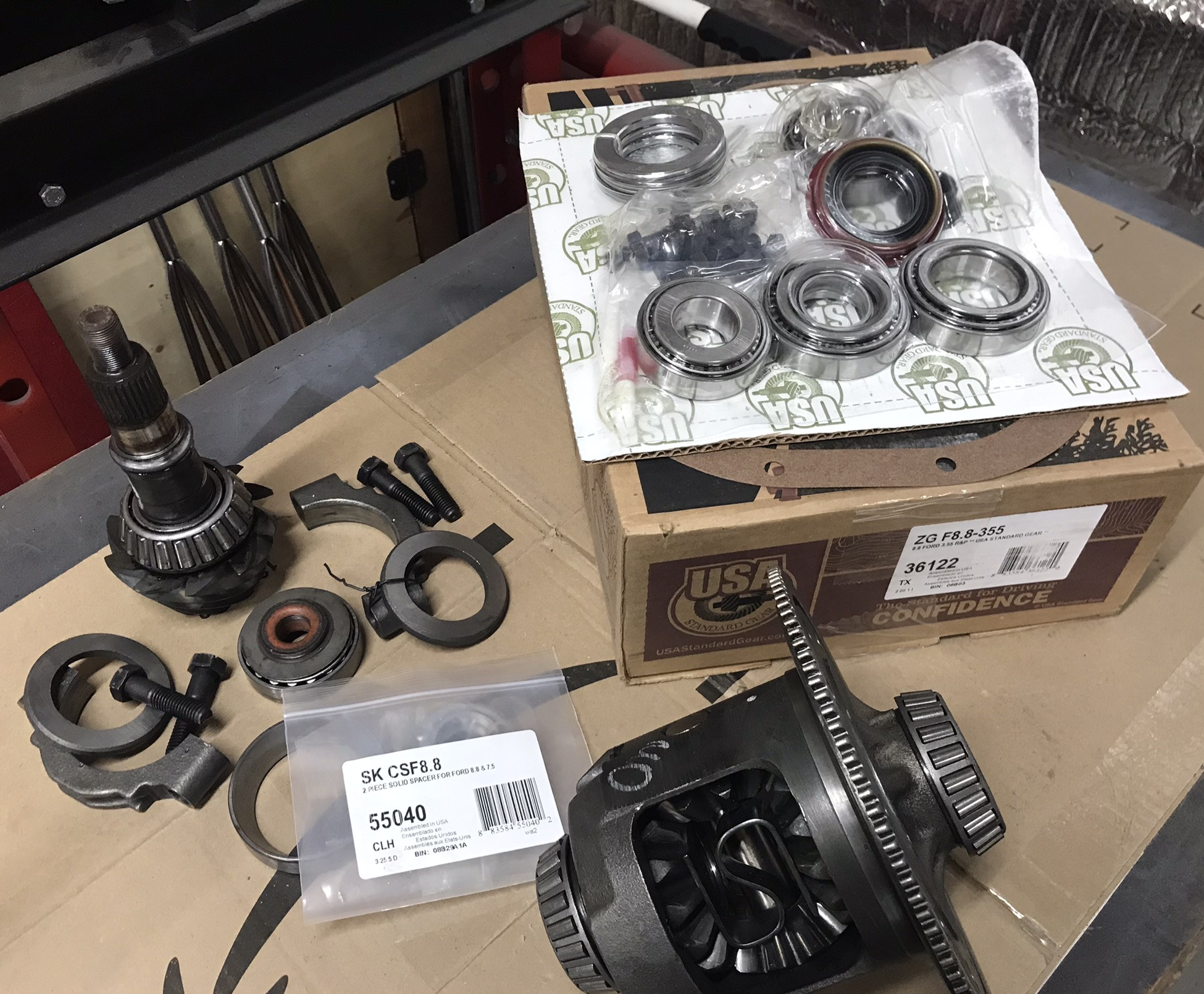

              I spent all of my allowance on a 1999 Explorer 8.8 with 4.10 gears . In typical fashion I had it blown apart within 2 hours of getting it home. No surprises , everything looks great and the oil hardly stunk at all. Since I’m running a TH400 the 4.10s will get swapped for a set of 3.55s I have on the shelf. Around here most of the 8.8s for sale have had 3.73s , even if I had picked up one of those I’d still have to swap those as well. So the dirty work has begun.

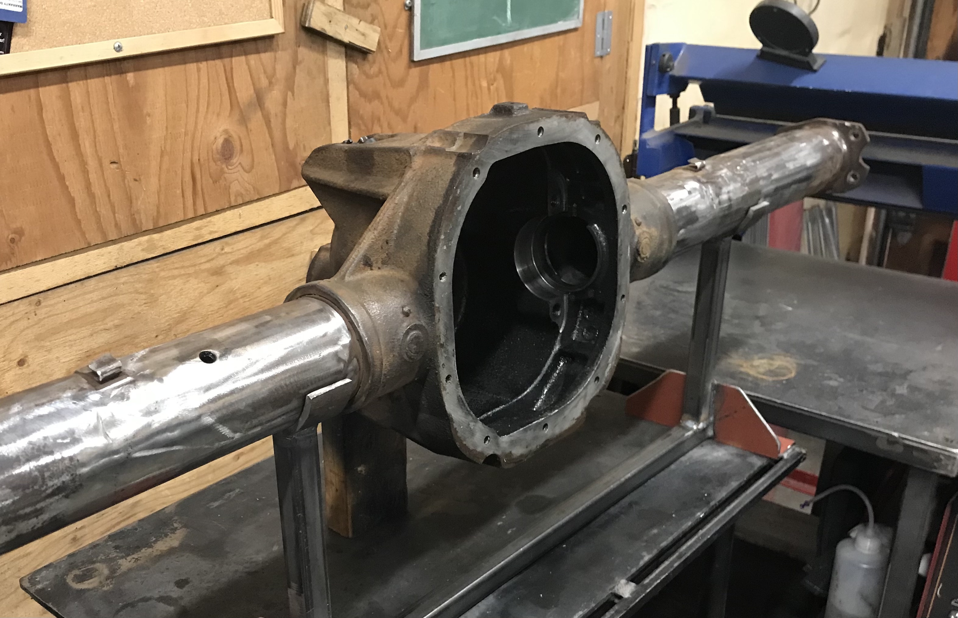

                Click image for larger version  Name:	3EA8C896-4D03-4754-941C-9ECBFEFFE50C.jpg Views:	0 Size:	763.9 KB ID:	1341756 Click image for larger version  Name:	31FF91F0-FD7E-49A8-89AD-ACB04F4FBCFA.jpg Views:	0 Size:	1.09 MB ID:	1341755
                Got work done this weekend !
                Narrowed it by 1 1/2” narrower than the stock 7.5 just to tuck the tires a bit more . I’m going to order axles from Dutchman . Have any of you dealt with them before? .​
                  can you buy their 'cut to fit' axles? you can save some bucks with them... basically they just make the splines go further onto the shaft, then you cut it to whatever length you wish. I used Nitrogear axles on my '40, one of them was a cut-to-fit.... works pretty slick.
                    These are c clip axles. Their axles will run between 300 and 350 a pair . Thanks for your input
                      I knew that.... forgot, but knew that... the 7.5 in my Fiat's axles interchange with the 8.8 (another random bit of useless information I carry around). Those are c-clip...
