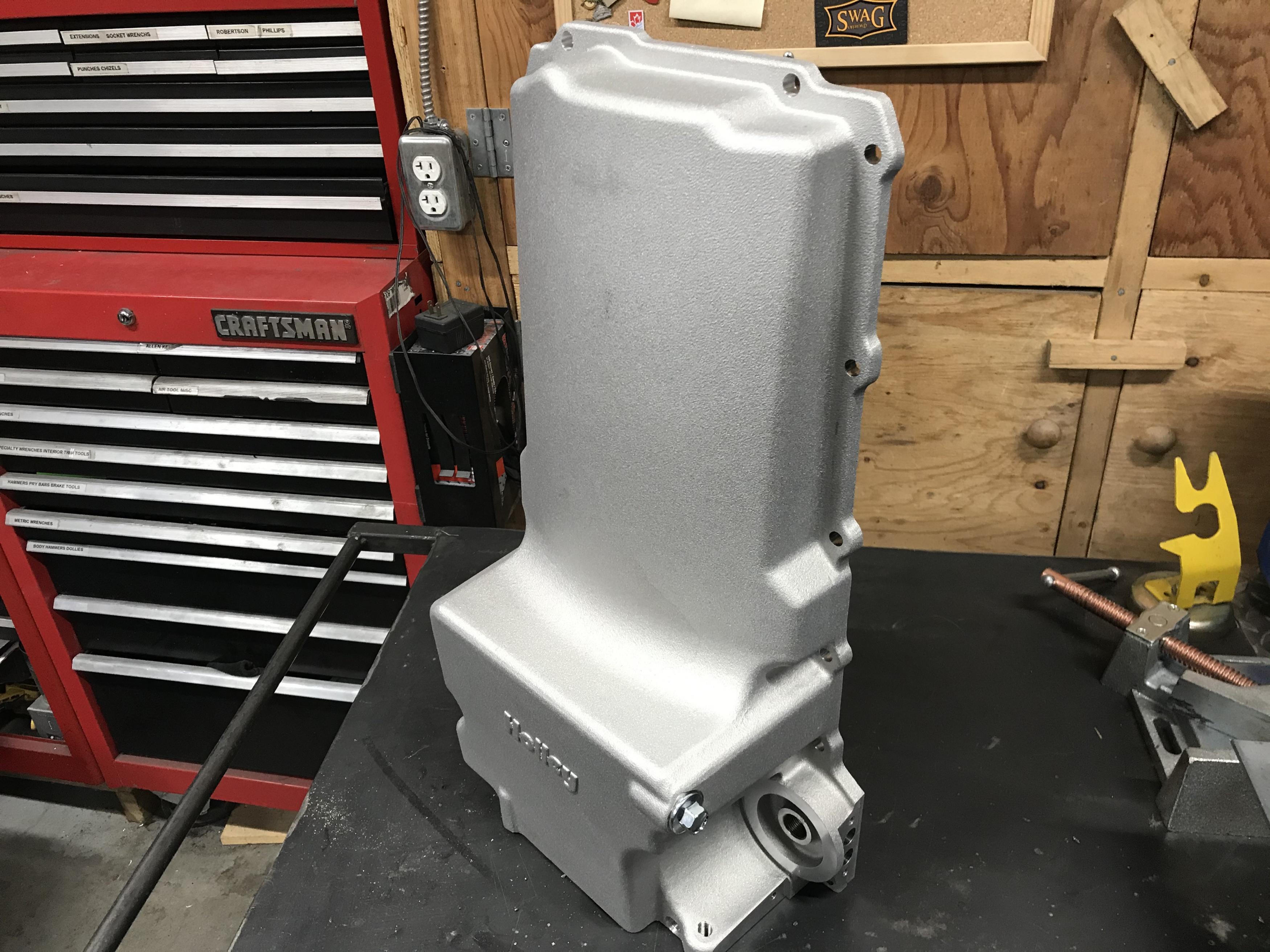

    I did receive the Holley 302-1 oil pan yesterday from Summit on sale. I was looking at the eBay Holley knock off pans but they are too deep (front to back) to fit in the S10. I could notch the cross member to make it fit but decided against that. I'd save $150 on the pan but the Holley pan saves me the hassle . I ordered an eBay special , the GT45 turbo. I've watched plenty of Richard Holdener's videos and he sold me on it plus it's dirt cheap and it'll be perfect for my needs . The truck is just going to be a toy anyhow . I'm not planning on making 1000 hp , 500 hp is easily in reach and more than enough. From what I've learned from Richard and Matt Happel (Sloppy Mechanic) you don't need a lot of high $ parts to get the job done. I'm looking at an 4.8 Vortec/LS and I'll drop in an Elgin E1839-P cam 220/224 .575 lift 112 lsa this cam is also known as the Sloppy Stage 1 cam . The Sloppy Stage 2 cam is really popular and really too big for a 4.8 from what I've learned. A few months back I picked up another eBay special , a 92mm throttle body. So I'll keep on collecting parts in the mean time .
