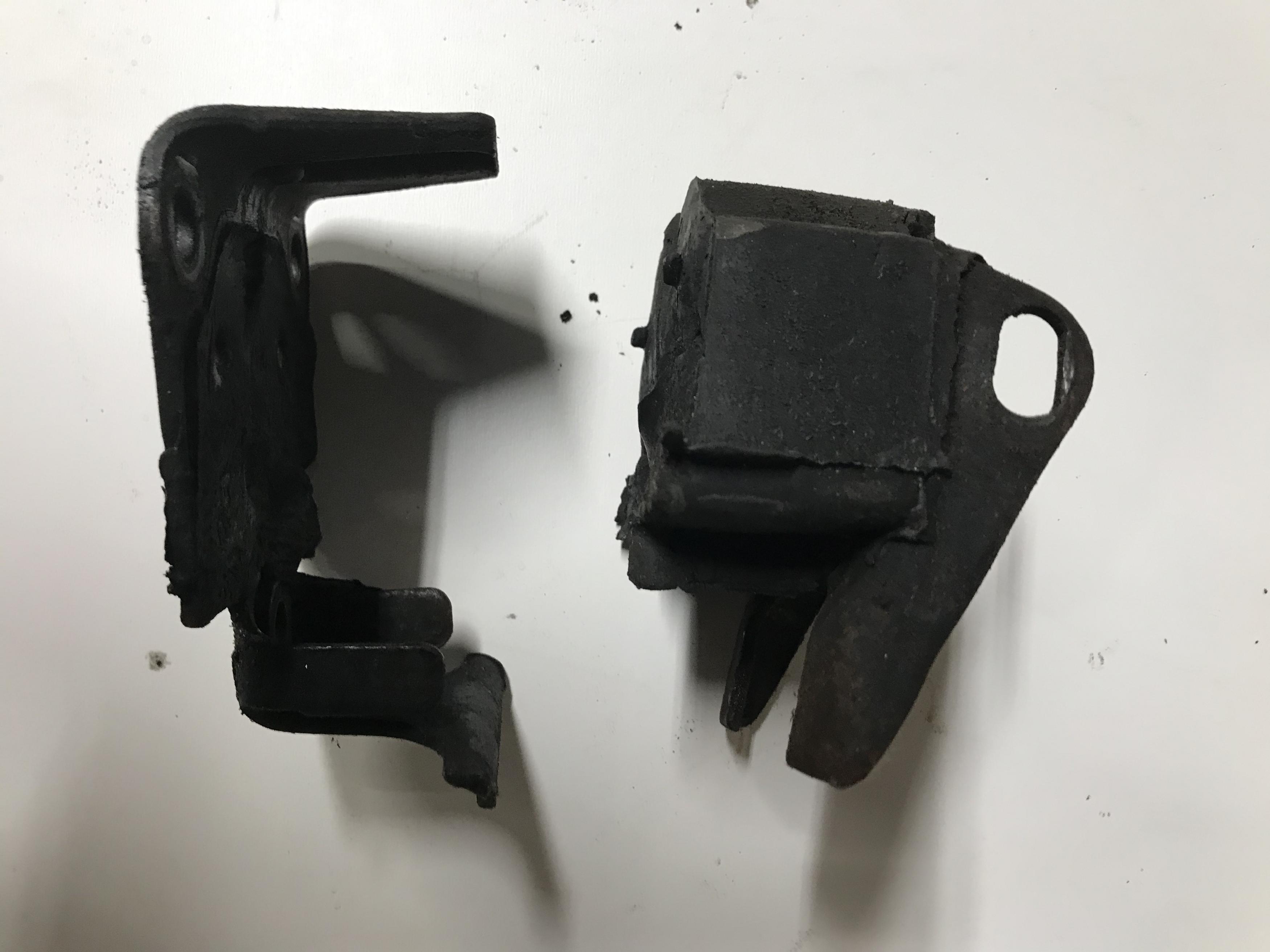

      I didn’t find that 10mm but I did find a broken driver side motor mount. That’s the second one to go since I’ve owned it.
        In my opinion, the quality of motor mounts has gone down hill significantly in the last 10 - 15 years. I ended up making some adapter plates to use urethane mounts

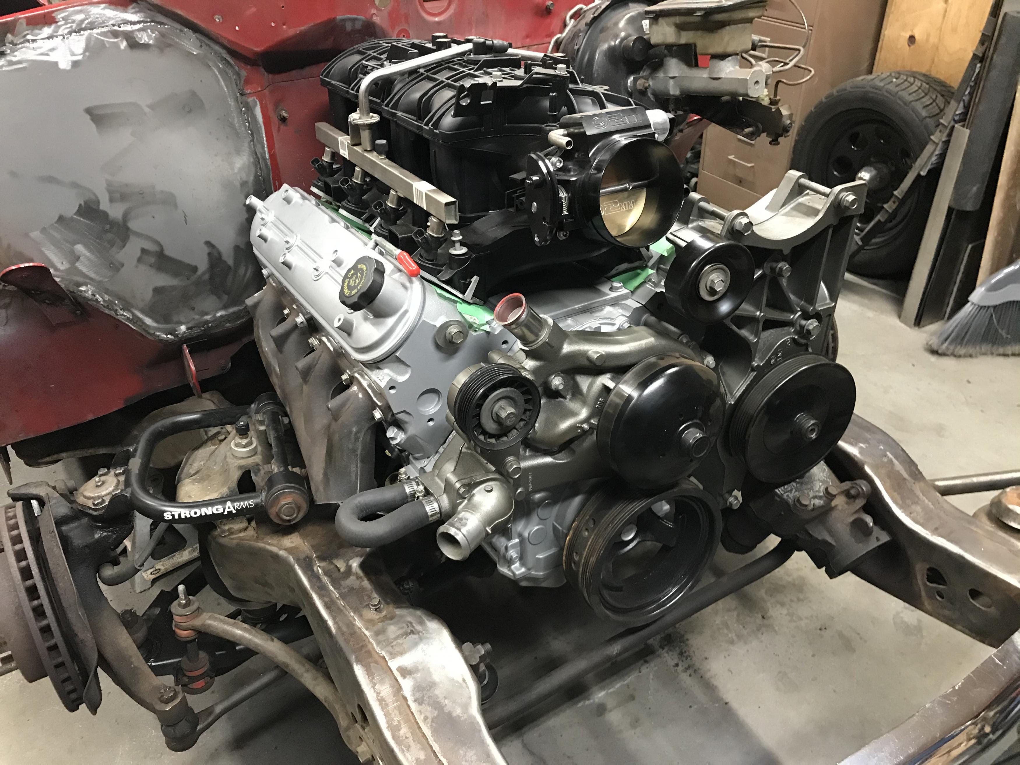

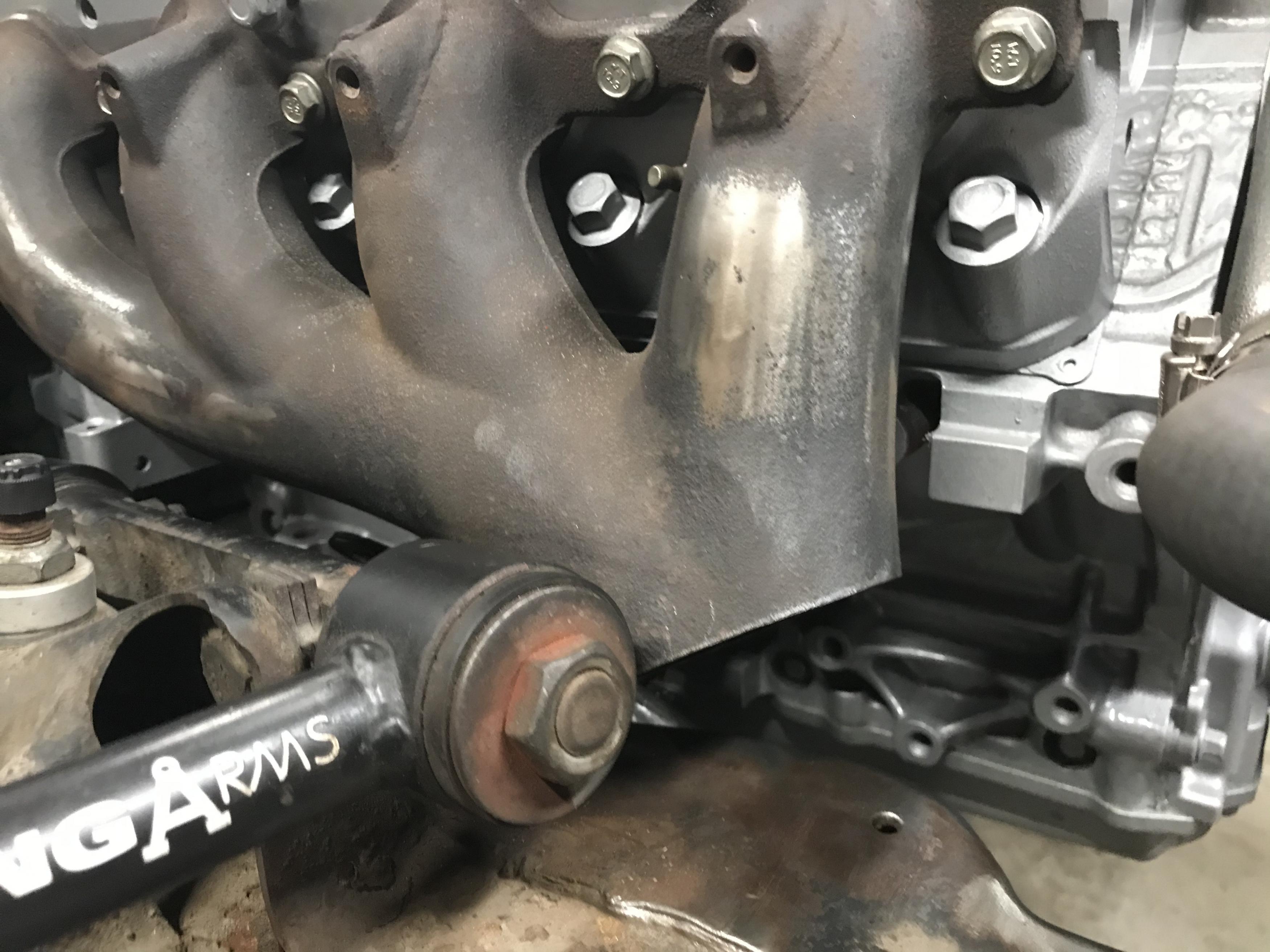

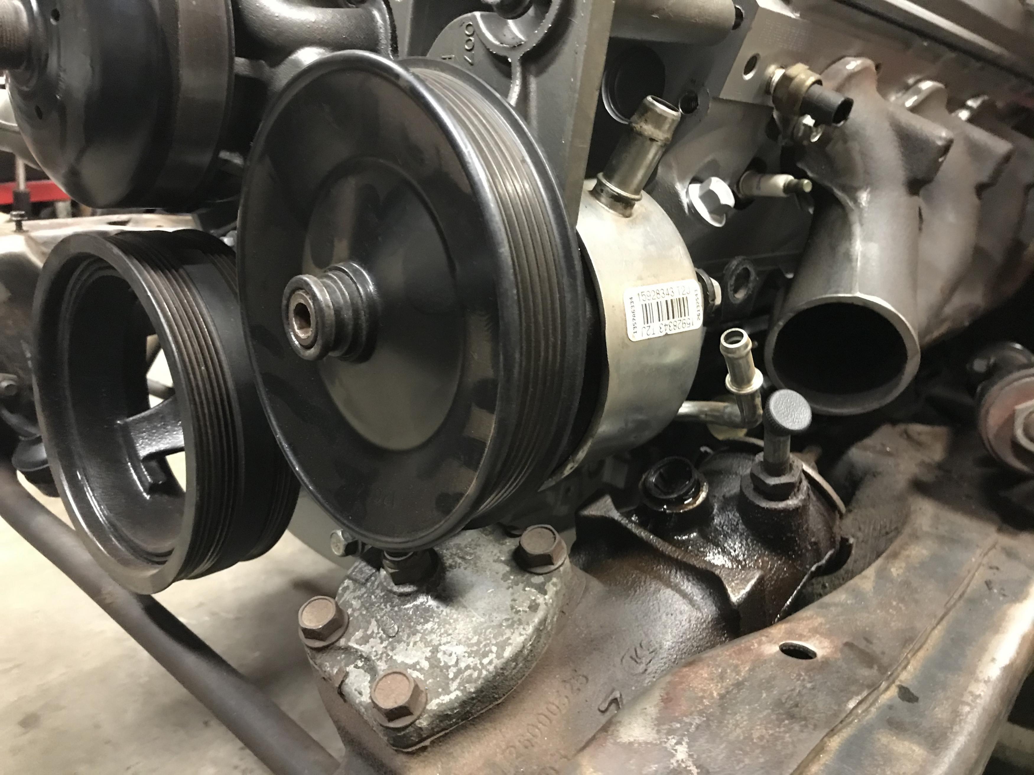

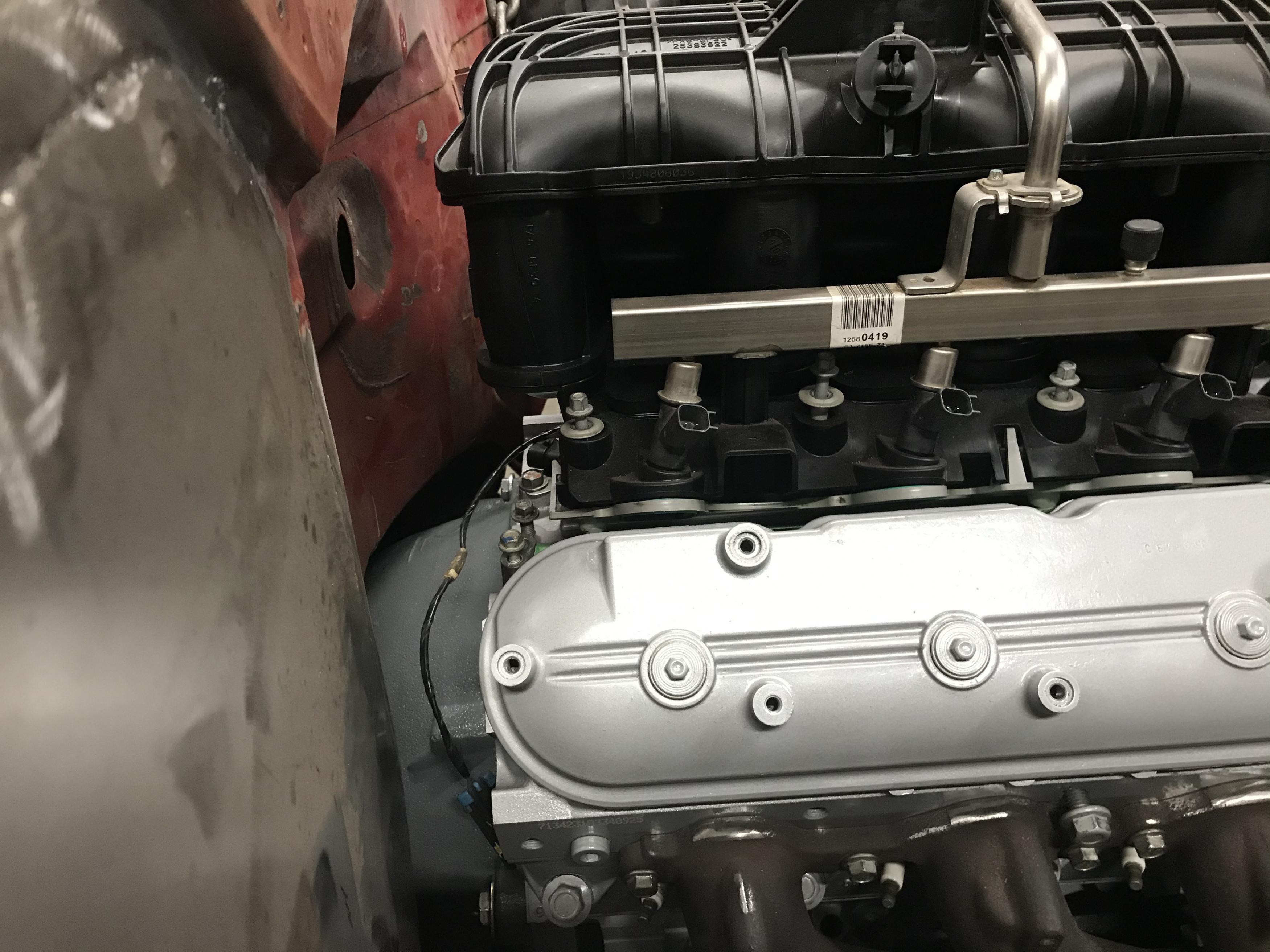

                    Click image for larger version  Name:	B1B59BCC-8FC2-4287-9EBF-2C744D638F8E.jpeg Views:	0 Size:	771.1 KB ID:	1292266Click image for larger version  Name:	82D45FD5-DBE9-46E6-B1A3-6B835CA1E1C4.jpeg Views:	0 Size:	899.7 KB ID:	1292265Click image for larger version  Name:	857528C3-634F-4DF0-B87A-435517612605.jpeg Views:	0 Size:	747.7 KB ID:	1292264 I installed the engine and TH400 using Trans dapt motor mounts. These mounts sit the engine really low . If I hadn’t sectioned the crossmember I’m sure there would be contact in a couple of places. So I’ve decided to use part of the kit and I fab up new frame mounts to lift the engine up an inch or two. As it sits the exhaust manifolds which need heavy modifications which I knew from the start. Passenger side points straight at the frame rail and the driver side has issues with the steering box which has issues with the PS pump . The steering shaft also wants to share the same space with the exhaust manifold . These swap mounts also place the engine a little too forward, which makes it nice to get to the transmission bell housing bolts. So the plan is to move the engine up and back and see how things look. Intake to hood clearance I’m sure will be tight . I’ll also have to fabricate a trans crossmember . Click image for larger version  Name:	88482785-3958-4154-A0FE-B769DA2A2AB9.jpeg Views:	0 Size:	699.8 KB ID:	1292263

                      • 31966
                      #130
                      I put button head bolts where the PS pump interferes... but I think you need to move the engine wayyyyyy back... have you set the core support on yet?
                      • langleylad
                        • 1694
                        #131
                        Ya , about two minutes after I rolled the lift back. Wasn’t too bad but an inch or two more will be better. I just got home from the metal supply shop . Picked up some tubing for the new mount but I won’t have the poly bushings till Sunday.
                          and button heads it will be..... thanks!

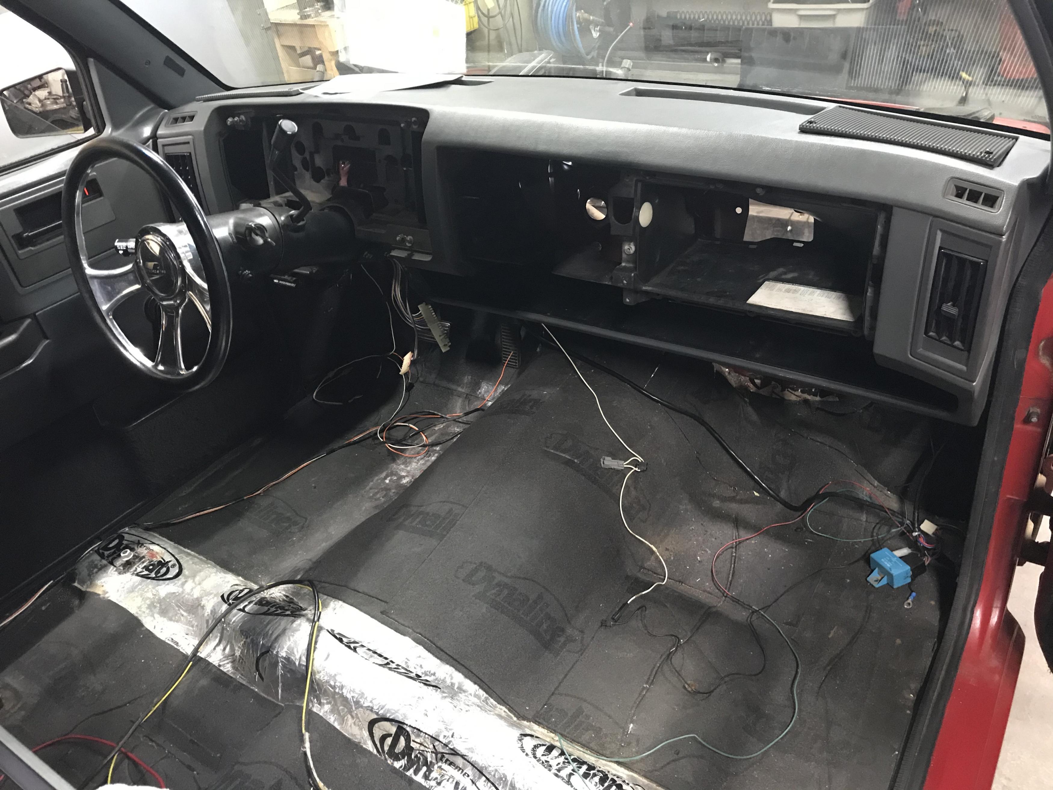

ID:	1292386 While I’ve been waiting on Amazon to deliver my bushings I’ve started on the rewire .

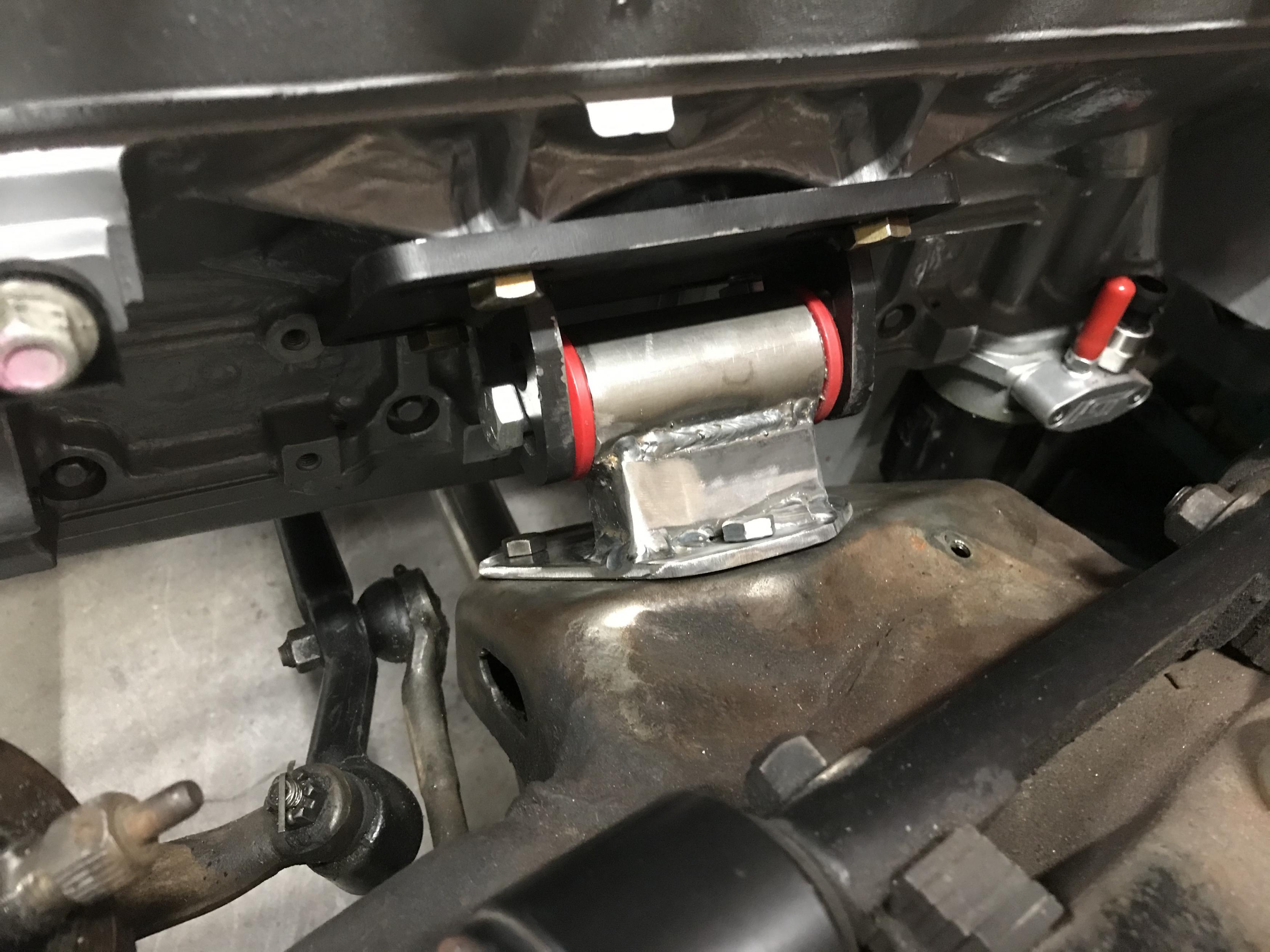

ID:	1292508 Mounts are built. I thought of welding them directly to the crossmember but instead I welded them to plate that will be bolted in the stock location. Which should ease the engine/transmission installation.
