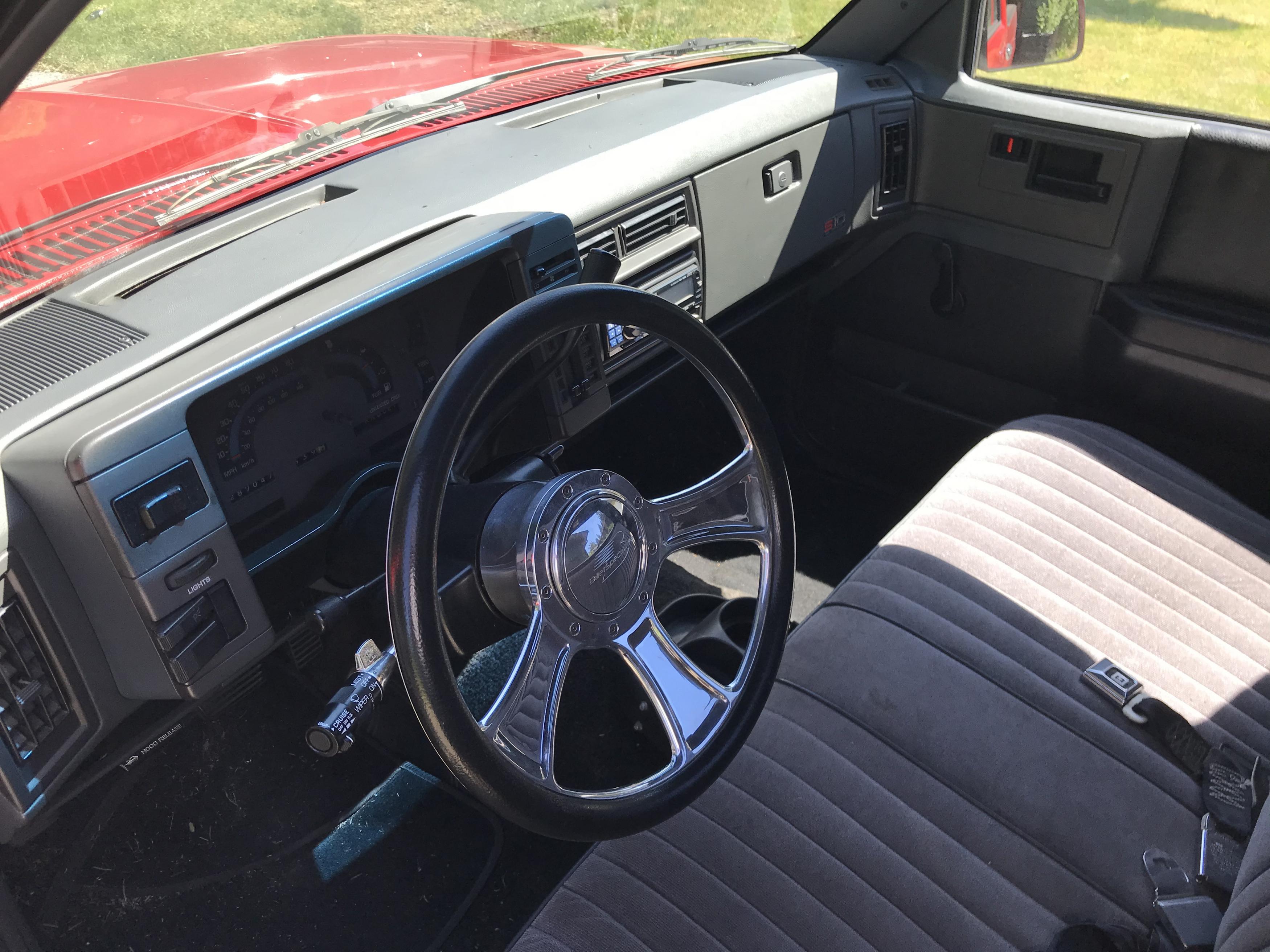

    I decided to build the 88 S10 again ........... I did paint and body plus RideTech suspension 10 years ago. Actually I did a lot more than that. I freshened up the interior , a SSBC rear disc brake conversion plus tires and wheels. I've owned the truck for the last 20 years. I bought it off a woman who had moved up to BC from So Cal . The truck has a 4.3 V6 with a 700R4 behind it . Back in 01 two weeks before Christmas it blew a head gasket , it had over 100,000 miles on it . It was my only transportation at the time , so I called up the local Chevy dealer and bought a remaned long block . Since it was that time of the year I popped into a speed shop and purchased a Edelbrock intake and headers also by Edelbrock . Those headers have never been off the engine , still running the original header gaskets .Years later I added a Holley throttle body and MSD distributor . The truck runs great , it now has over 287,000 miles on the truck overall . I've always run Mobil synthetic oil , I'd love to see the inside of the motor.

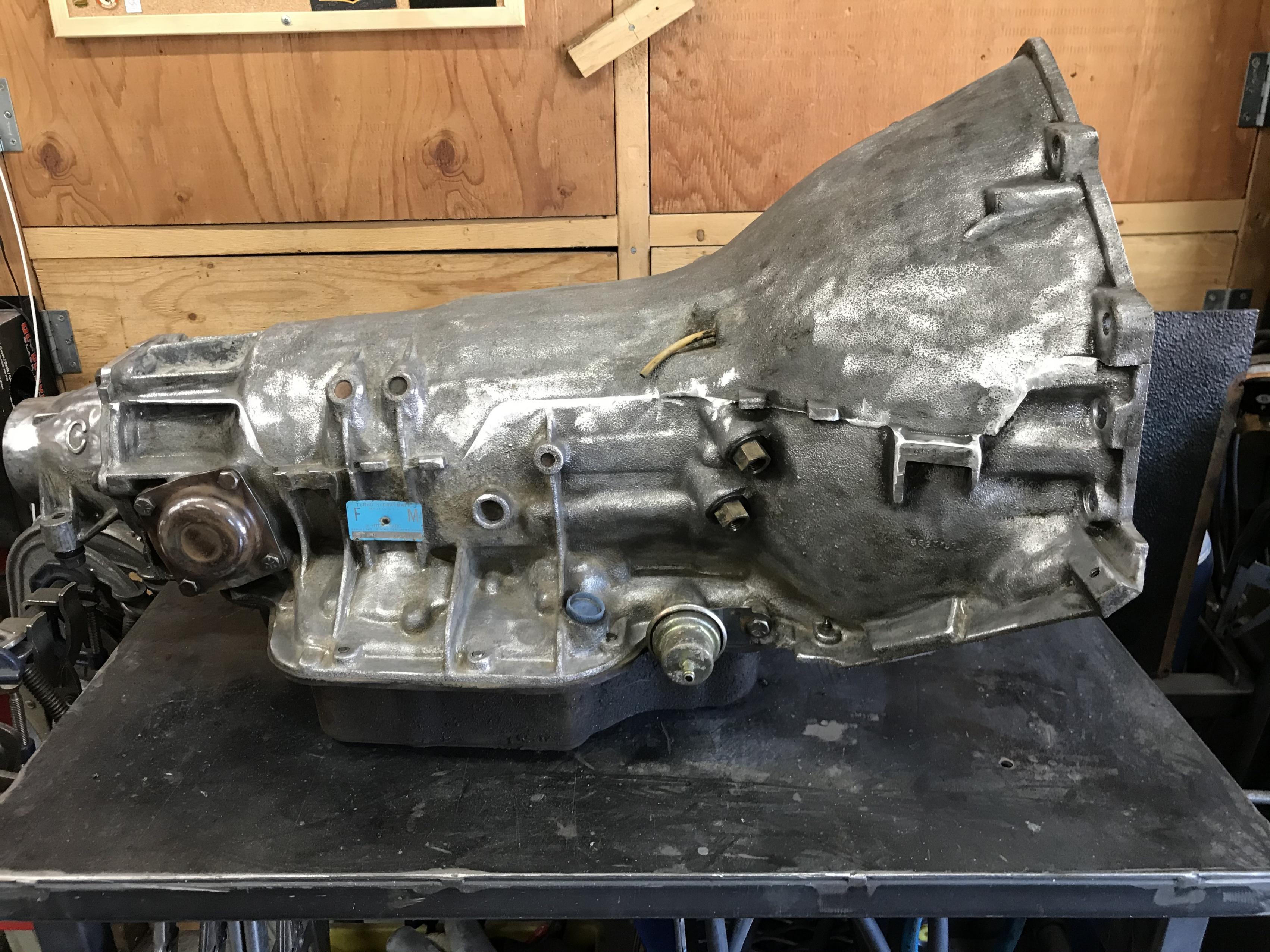

    That brings us to now , the plan is to swap in a used LS and throw a turbo on it . I've already been scouring the interwebs as they say . I picked up a 83 Turbo 400 off of Craigslist locally here . The old guy told me that it had been rebuilt , driven for a year and then parked when he was having other problems with the truck (not the trans) . He decided to part the thing out. I also found a great deal on a brand new TBSS intake. I thought it would be a good idea to collect most of the parts for this project before I start tearing things apart . We'll see how that works .

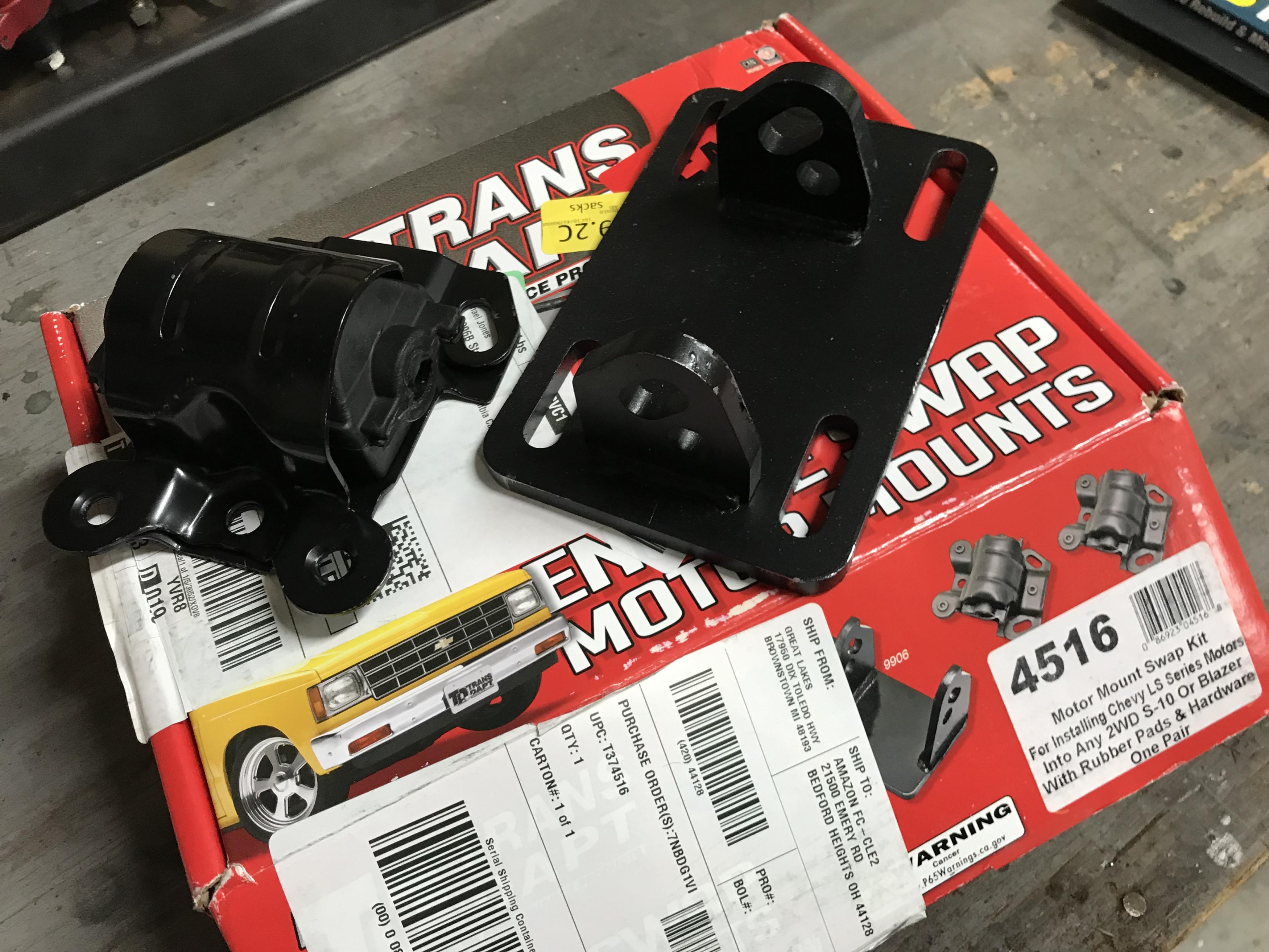

                            With a budget in mind I went with Trans-Dapt mounts . They were $127 cdn on Amazon . I could have purchased billet mounts but why would I ? they're motor mounts. I looked at Hooker mounts and they were close to $400 when all is said and done , they are pretty but so is $250 in my hand. The Trans-Dapt mounts have a little bit of adjustability and in the S10 there's not a lot of room anyhow , so I don't need lots. I should have more parts showing up in the next week. I'm still looking for an engine. My favourite pick & pull closed down for good because of this covid 19 PITA ! , which really disappointed me. It was nicely laid out and always had new stock coming in. I found a new place but their pick & pull yard is a bone yard , pretty much picked over . They have half of their yard closed to the public, It looks like that half is where all the good stuff is and they remove the parts as need and when they're finished with them they move them over to the pick & pull section. Not many other pick & pull yards around here . Probably going to have to spend more on a motor than I had planned.
