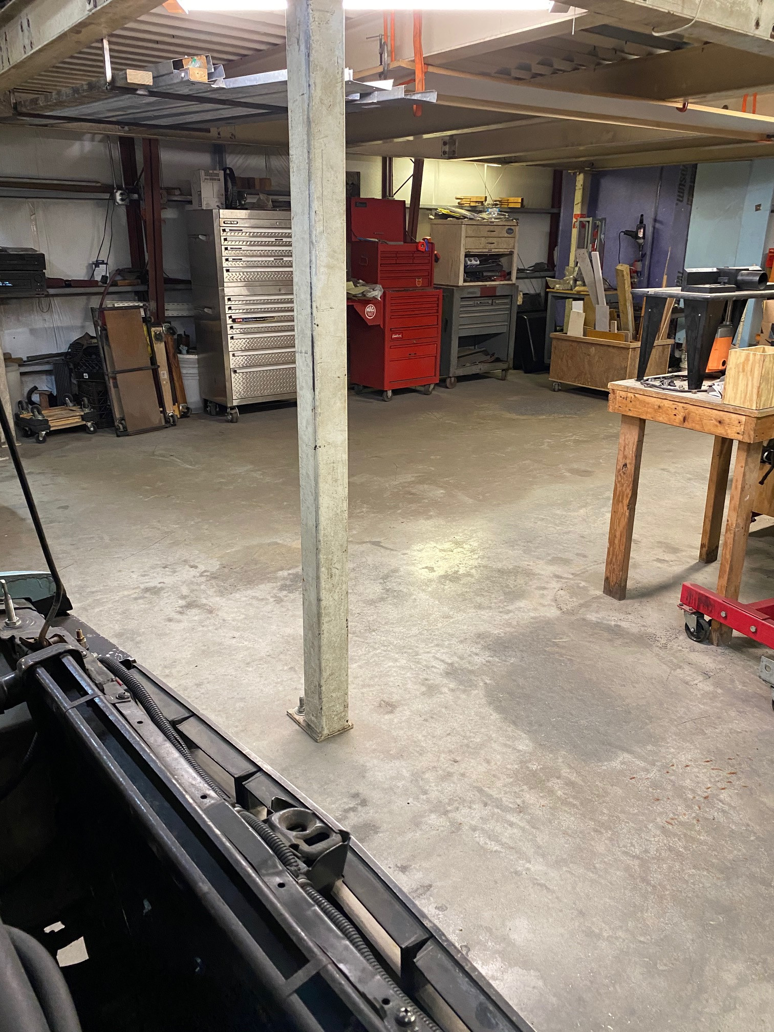

    So anyhow, the project begins. Pics of Stanger in the flat stall on his way to the hoist and of the rear area under the mezzanine with the tool boxes moved and the shop space better utilized.
    Click image for larger version  Name:	IMG_0363.jpeg Views:	0 Size:	956.2 KB ID:	1283646
    And the rear space:
    Click image for larger version  Name:	IMG_0366.jpeg Views:	0 Size:	935.1 KB ID:	1283647
    More better!

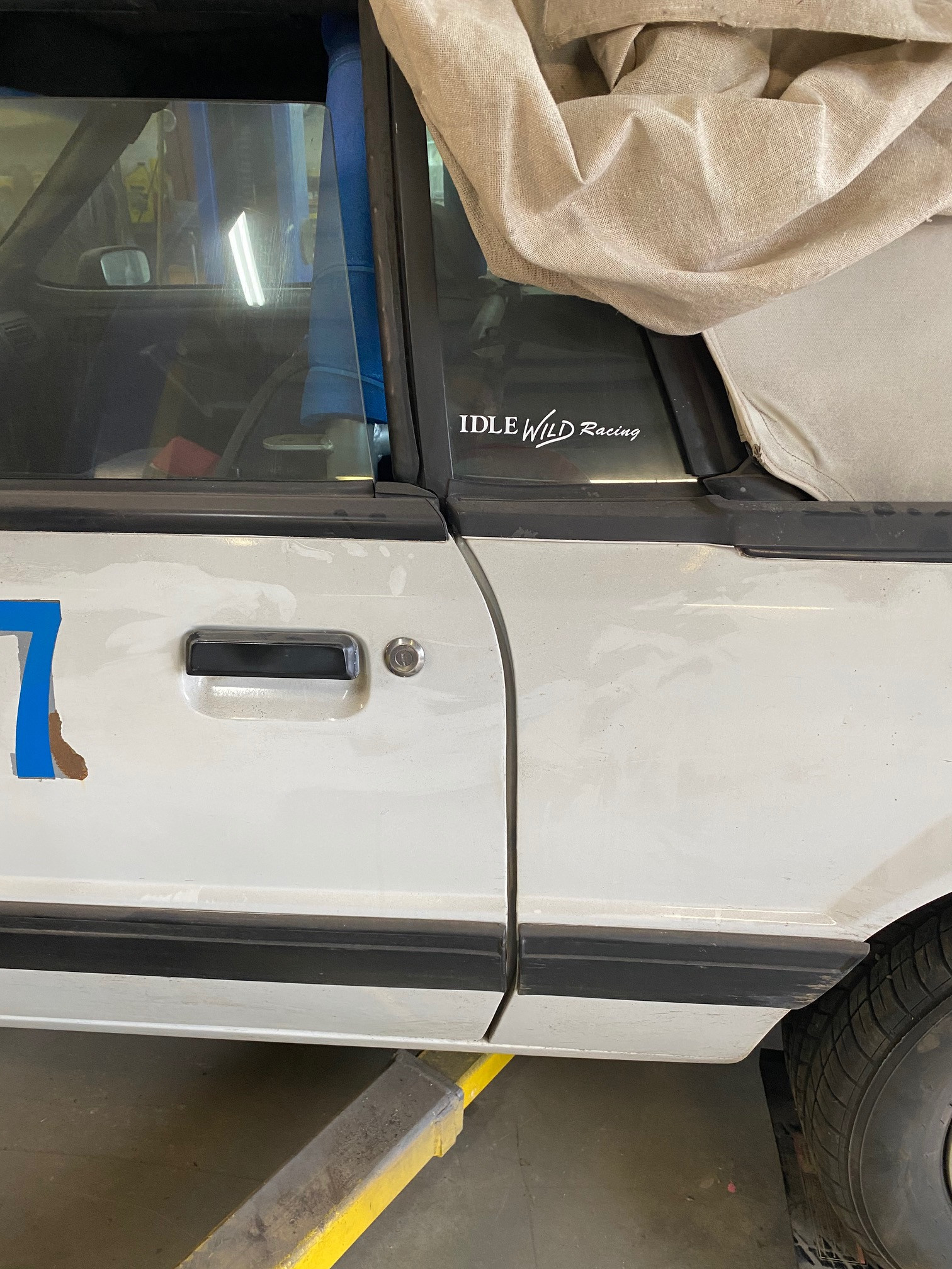

        Now for pics of the crappy door gaps. Remember, this is how Ford shipped the car back in 1988. I did change the RF fender and corrected that gap a bit but I should have fussed with it more. The plan when I put the car together was to flip it (we like him so we named him and kept him) so I didn't put as much into alignments as I should have. All these adjustments are complicated by the fact that the gap along the bottom is more or less straight!
        Passenger's rear, the worst one:
        Click image for larger version  Name:	IMG_0367.jpeg Views:	0 Size:	672.6 KB ID:	1283656
        Passenger's front which is pretty good until right after the upper body line. Not sure what to do with that - it's an aftermarket fender and that may be as good as it gets. Given the crappy factory fits maybe it isn't so bad.
        Click image for larger version  Name:	IMG_0368.jpeg Views:	0 Size:	729.4 KB ID:	1283657
        Driver's Front. Not too bad but I'm thinking the whole driver's door could slide back 1/8 or so.
        Click image for larger version  Name:	IMG_0369.jpeg Views:	0 Size:	790.1 KB ID:	1283658
        Driver's rear. Here's why I'm thinking it'll look better if I slide the door back.
        Click image for larger version  Name:	IMG_0370.jpeg Views:	0 Size:	767.8 KB ID:	1283659

          It's a racecar, the only gap to worry about is to the guy behind (hopefully) you.

            It seems to have been welded together wrong at the factory. These were built as coupes w/o top then shipped to Brighton, MI and turned into converts there. Reinforcements were added in Brighton so the car didn't fold in half but if they were added to a crooked body well, it stayed crooked. Guessing that's what happened. I tried to stress it back toward straight when I added the roll bar but didn't have much success. It aligns and drives out well (or at least it did the last time I drove him) so it must not be TOO far off. Still, it's annoying.

                Did someone jack it up wrong? Fox mustangs are pretty flimsy (especially convertibles!).

                  1) Never jumped it but I wonder if it would help. Seems like it might tighten that right side rear gap.
                  2) It's always been that way. When I installed the roll bar I tried to "jack it up wrong" to get the body to bend before I welded in the down bars, hoping to improve that right rear gap. It didn't bend even though I tried jumping up and down on it in an effort to bend things a bit. So yes they are flimsy but not THAT flimsy.
