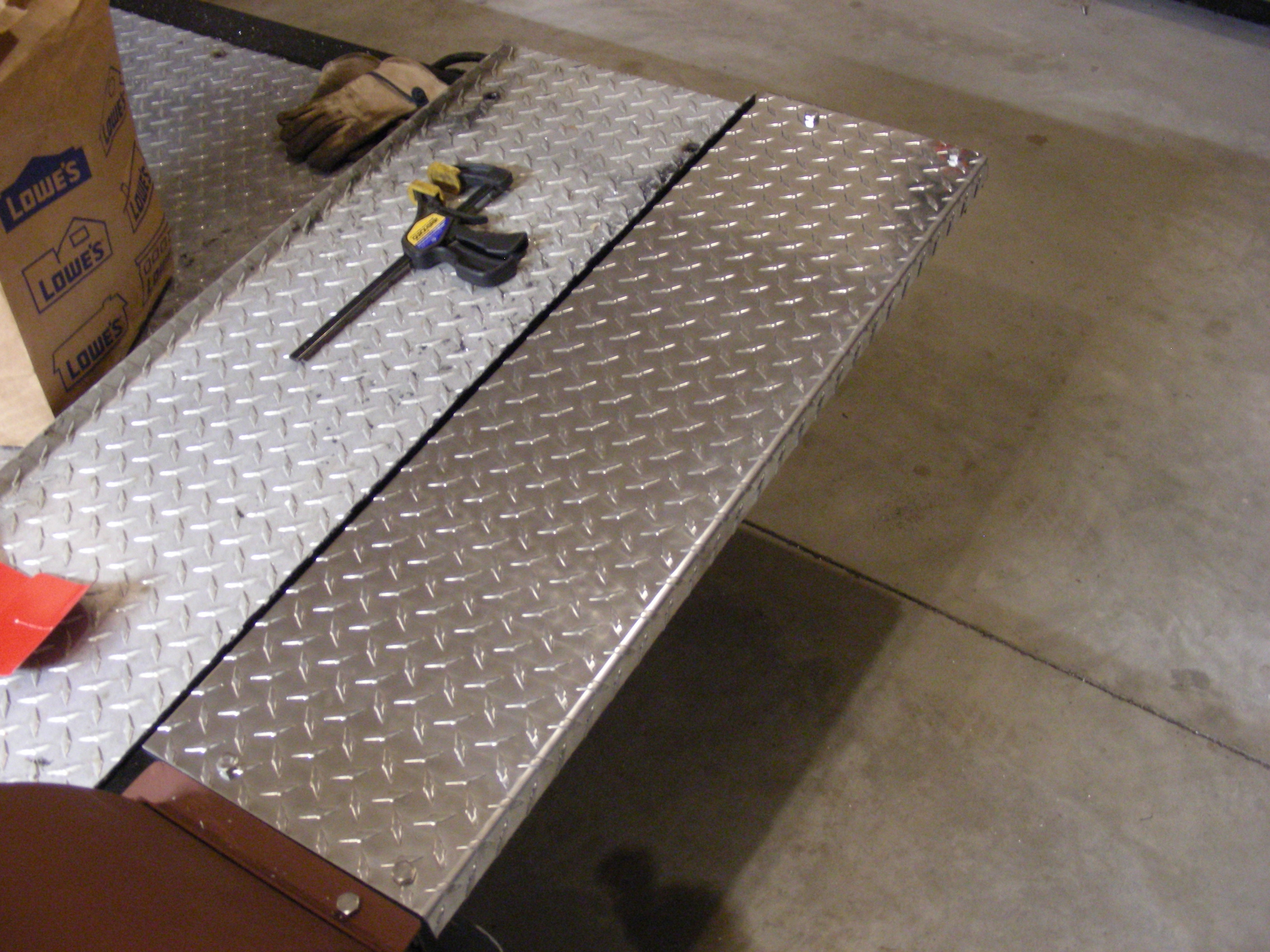

        • Trailer will be done by the end of the weekend . It'll be out of the way so I can focus on the Whatever project . I was able to get the new deck plate fitted and half bolted down.
ID:	1308529 I still have to paint it black and wire it.

          of course if you remember I welded flange nuts into the trailer to be able to bolt the plates down without any crawling around to get to nuts under the deck. However that means that I had to locate the holes in the deck plates. So I made these:
ID:	1308532 I suppose I could have bought real transfer screws, they look like setscrews with a small hex just below the point. But that takes time, planning and money. Making these 4 screws, 2 for blind or hard to get to the back side of, and 2 that can be screwed in from underneath, took about 30 minutes total on the lathe and bandsaw. The 2 short ones took a little bit more effort because I had to file flats for a wrench. Of course it ended up being metric. So now they go into the custom made tools drawer, as I know I'll be using them again.
