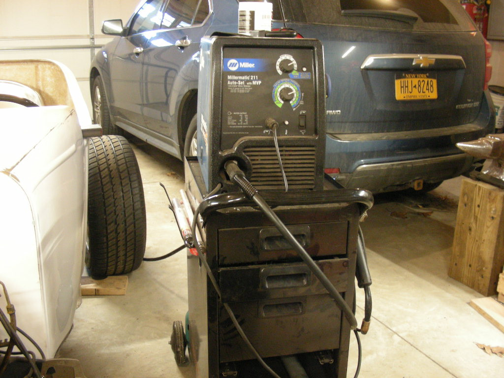

ID:	1315651 Lincoln tig/stick weler, 22 years old. Still working great. I'd love one of those fancy inverter jobs with all of the extra features but this one still works. The mig welder is a Millermatic 211, about 5 years old. Same story, does everything I know how to do, so its staying too.

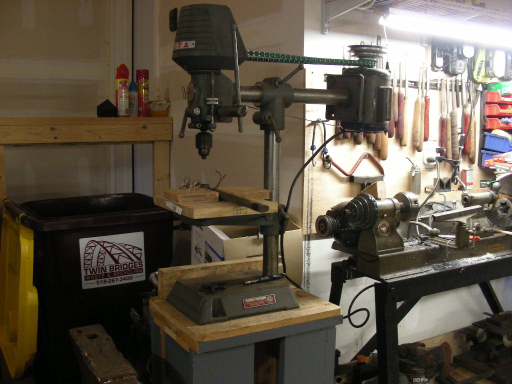

ID:	1315653 More antique tools. The lathe (if that's what you want to call it) is an old Craftsman teenie, tiny lathe from the late 40s maybe early 50s. It's not too capable, but it's okay for small stuff. I made a lot of spacers for rod ends with it, just slooooowly! The red thing is older than dirt. It's a 1928 vintage Sunnen bushing grinder, great for honing kingpin bosses and bushings. It came out of a garage in my home town. The old mechanic bought it new in 28, used it for years, and when he retired he gave it to a friend who had a Shell station in town. It was bound for the town dump when I rescued it in 75. The tooling has not changed so it will probably be around for another few decades.
        The lathe on the right is a Delta Double Duty lathe. It came out of a textile mill in Massachusetts, owned and operated by my sister-in-law's family for 3 or 4 generations, until textiles in the northeast went away. It went to my brother after his father in law moved into a retirement home a number of years ago. It was just a horizontal surface in my brother's garage, and he gave it to me in 2015. I use it for threading radius rods and other odd round things.
