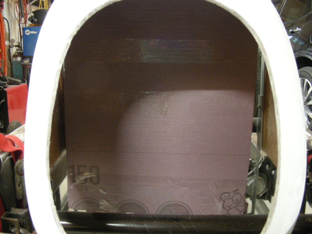

    • Cleanup mode is over. Back to making a mess. And floors! I'll start with pictures of the progress and expound upon such as needs explicitly.
ID:	1326829 Click image for larger version
ID:	1326830 Not much to discuss here. This is the shape of the opening in the nose after making a grill perimeter piece. I'm happy with the results and next is to make 1 horizontal cross bar and 8 to 10 vertical bars. That's bench work for when my back is bothering me.
