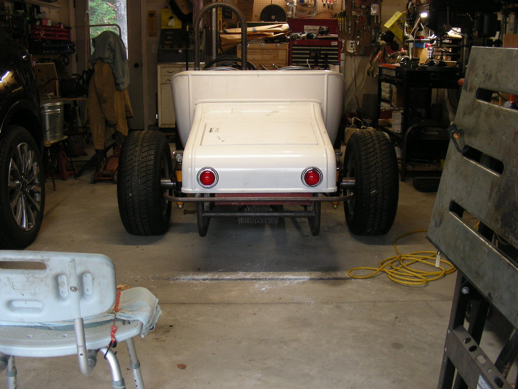

                  • Had to get into the garage today. It's in the 70s here in upstate New York, I'm wearing shorts it's so warm. Got a box of goodies yesterday from Speedway. Some hard parts that are not picture worthy, and 2 new taillights. The hard parts are stuff that will be hidden, the taillights however, well here's a picture:
ID:	1328543 I still haven't learned how to take good pictures, that's why in it, the taillights look slightly off. However it took longer to lay out the hole pattern than to drill them. Like 10 to 1 times longer.

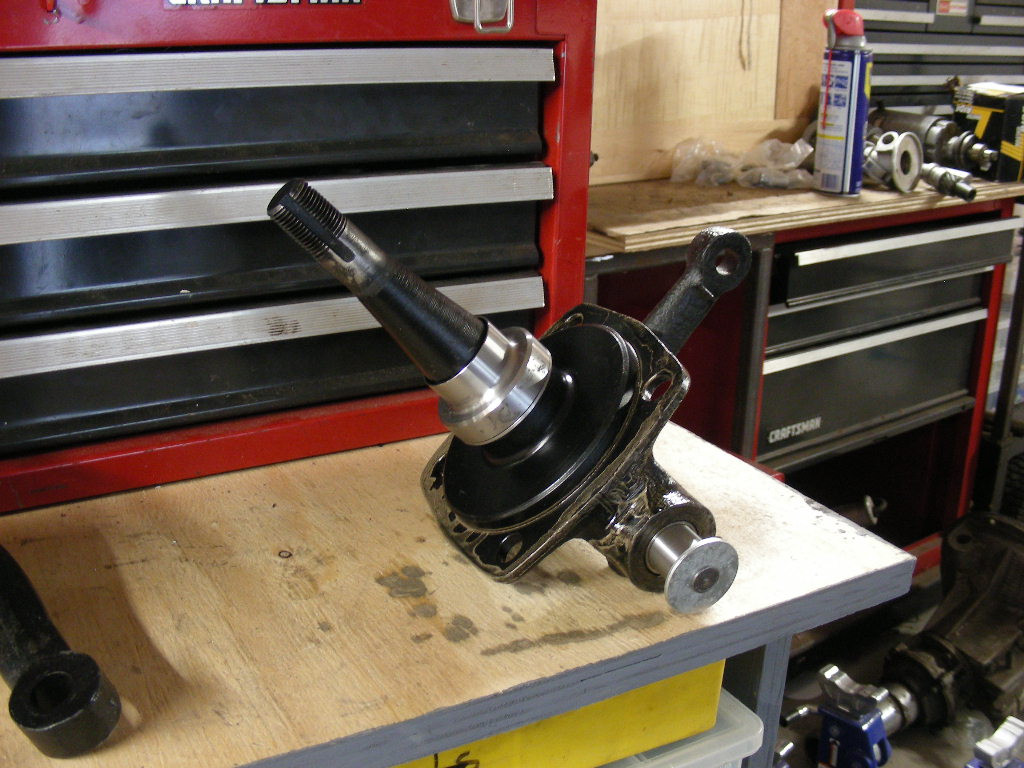

                      • Tomorrow finally got here. (See above). Pressed old bushings out, new bushings in, and honed them to a perfect fit to the new kingpins. Used my newest addition to the garage and the oldest machine on this project. The pictures start with the press (sorry I didn't think to get a picture while changing the bushings), and end with the spindles with the job done:

ID:	1328741 This is how we hone the spindle, hone the spindle, hone the spindle. This is the way we hone the spindle early in the morning! If you look closely at the thing sticking out from the upper left part of the machine, you'll see the hone truing sleeve sized for the mandrel in use. An important step, truing the stones.

ID:	1328743 Finished other than a good cleaning. I've never measured the pins and bushings when sizing them. I do it by feel. I do measurements once I get a fit that I like. I can still get them to 0.001- for a fit. That shiny thing on the spindle axle is the bearing adapter to mate mid 70's Chevelle disc rotors to these spindles. There's a really thin spacer between it and the spindle to get the location just right! I'm fussing with these spindles as the axle is significantly larger than a 40 Ford spindle. Everything else is a wash, pin size, pin inclination, backing plate bolt pattern and register, and steering arm dimensions.
