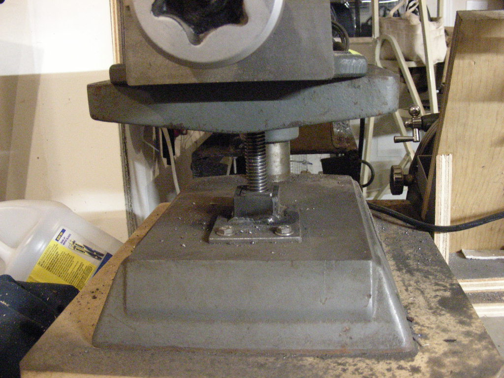

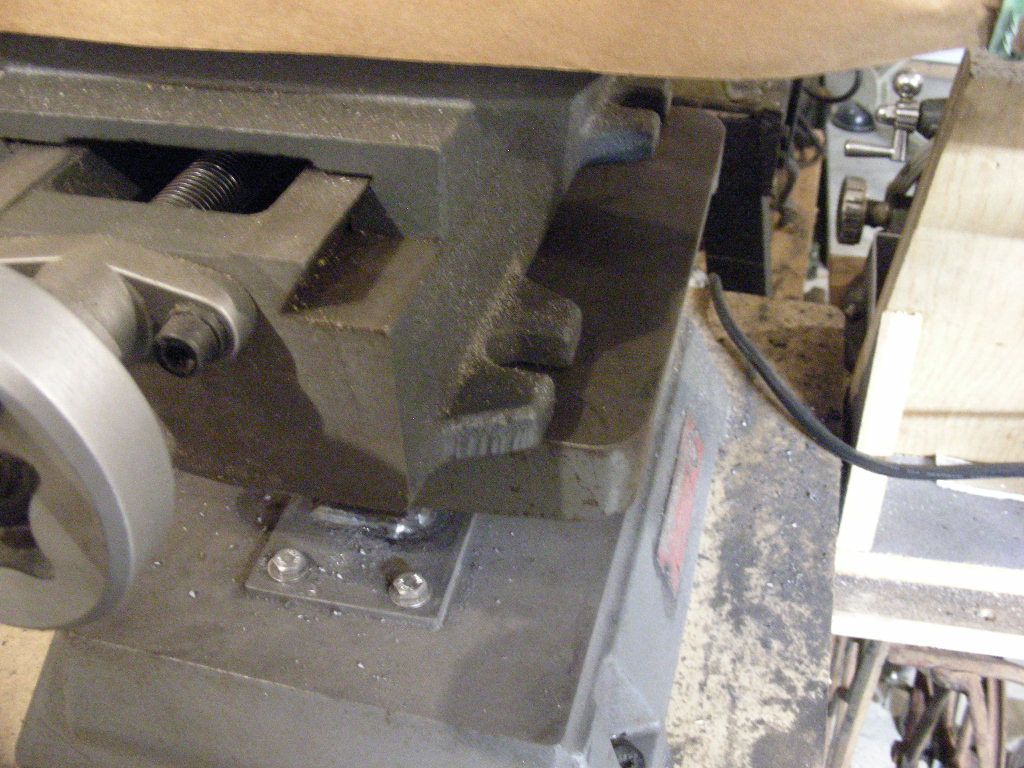

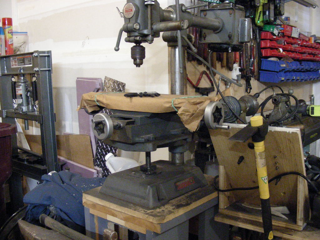

      • Took some time yesterday and finished a side project, getting a screw jack assembly on my old Delta radial drill press. Working good, but I'm going to make 1 modification to it. It needs a thrust bearing or bushing at the end of the acme screw where it lifts the table. Also modified the x-y positioning table I've had so that it nestles right up to the main column. Only thing left is to drill and tap 4 3/8-16 bolt holes to hold the table on x-y positioning table on the drill press table. That's tomorrow's task. And when done, gets another thing off of the workbench.

        • FYI for anyone interested (probably no one...), here's a few pictures of the modified drill press. I still have to bolt it down and align it, but that'll wait for another day.

          And now I have a precision positioning drill press. No it's not a substitute for a tiny milling machine. It's not rigid enough, nor will it hold an end mill correctly. But it will be nice to be able to drill holes in a pattern and be able to get them located in the right spots.

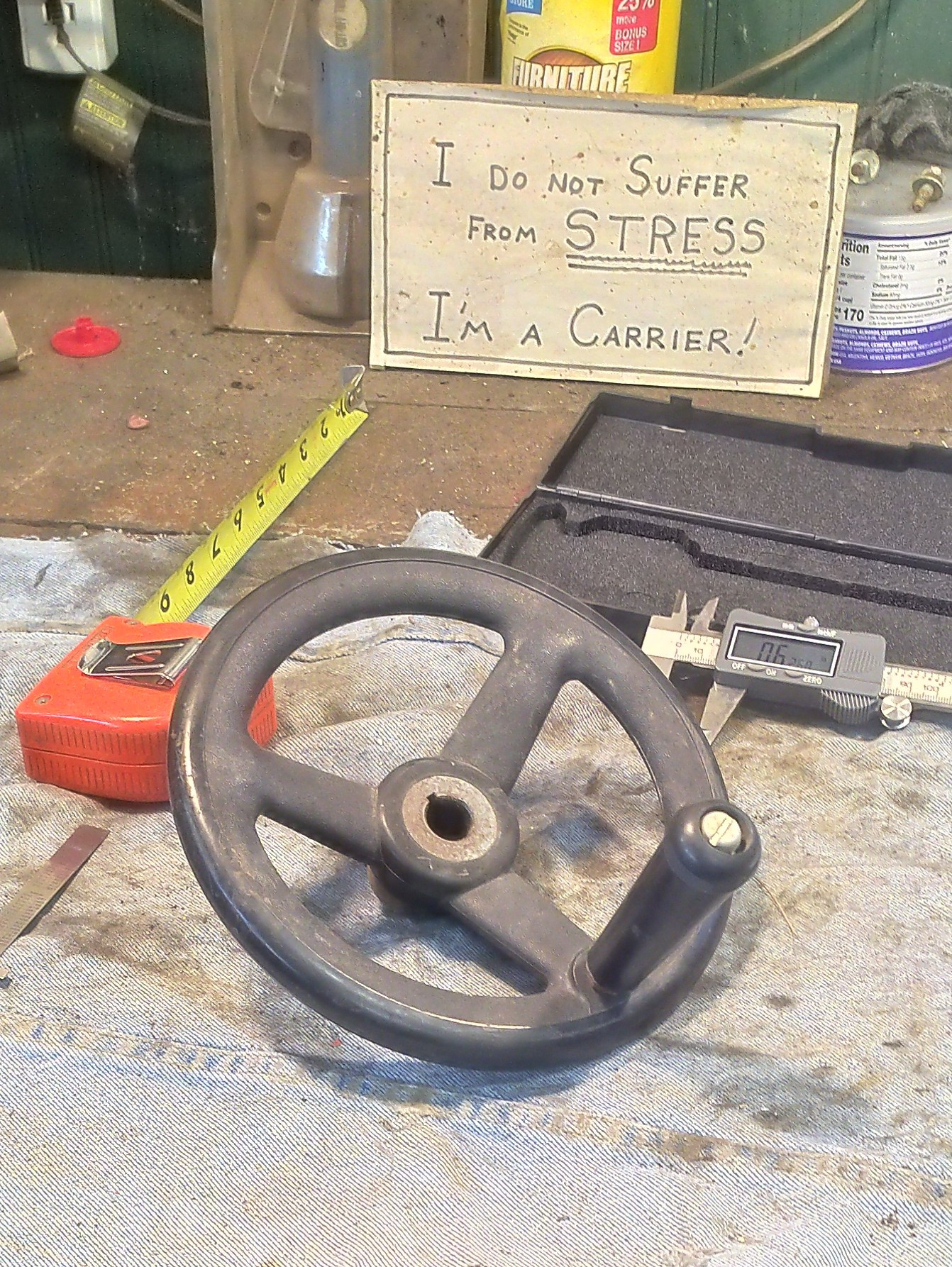

              I have some "Keyed" machine crank wheels for the modest fee of Shipping and a donation to keep the Beer Fridge Stocked....
              If interested, I will get dimensions, as they are buried in my swap meet sale totes, out in the Blue Barn.
              I believe I have 3 left

                Any idea what the overall diameters are? Of course I can only afford Red, White, and Blue these days . Like having sex in a canoe. Fornicating close to aqua pura

                      • Sorry I didn't get these posted yesterday.
                        I ran out of Day, went to a Retiree Get Together with some of the guys I worked with for 7 years.
                        I have 3 left.
                        Click image for larger version  Name:	IMG_20221208_151143~2.jpg Views:	0 Size:	952.6 KB ID:	1329868
                        Here's the dimensions
                        Click image for larger version  Name:	IMG_20221208_152156~2.jpg Views:	0 Size:	1.11 MB ID:	1329870

                          Okay so I'm in! Let me know how much and let's clean out some of your stuff and add it to my stuff! I can use all 3... someday! (Back of hand to forehead...)
                          • The bore is 5/8" with a 1/8" keyway

                            Please make a Reasonable offer to restock the beer fridge
                            and freight.
                            I don't want to Suffer Vapor Lock........

                              Shipping plus $20??? At least you can get better than RW&B.
                              • $20.00 will get get me a case of Leines Long Necks.
                                PM me your Address,
                                and weather permitting, I will ship tomorrow or Saturday.
                                (Calling for Freezing Rain)
                                I will put a return envelope in the box for your "Donation"
