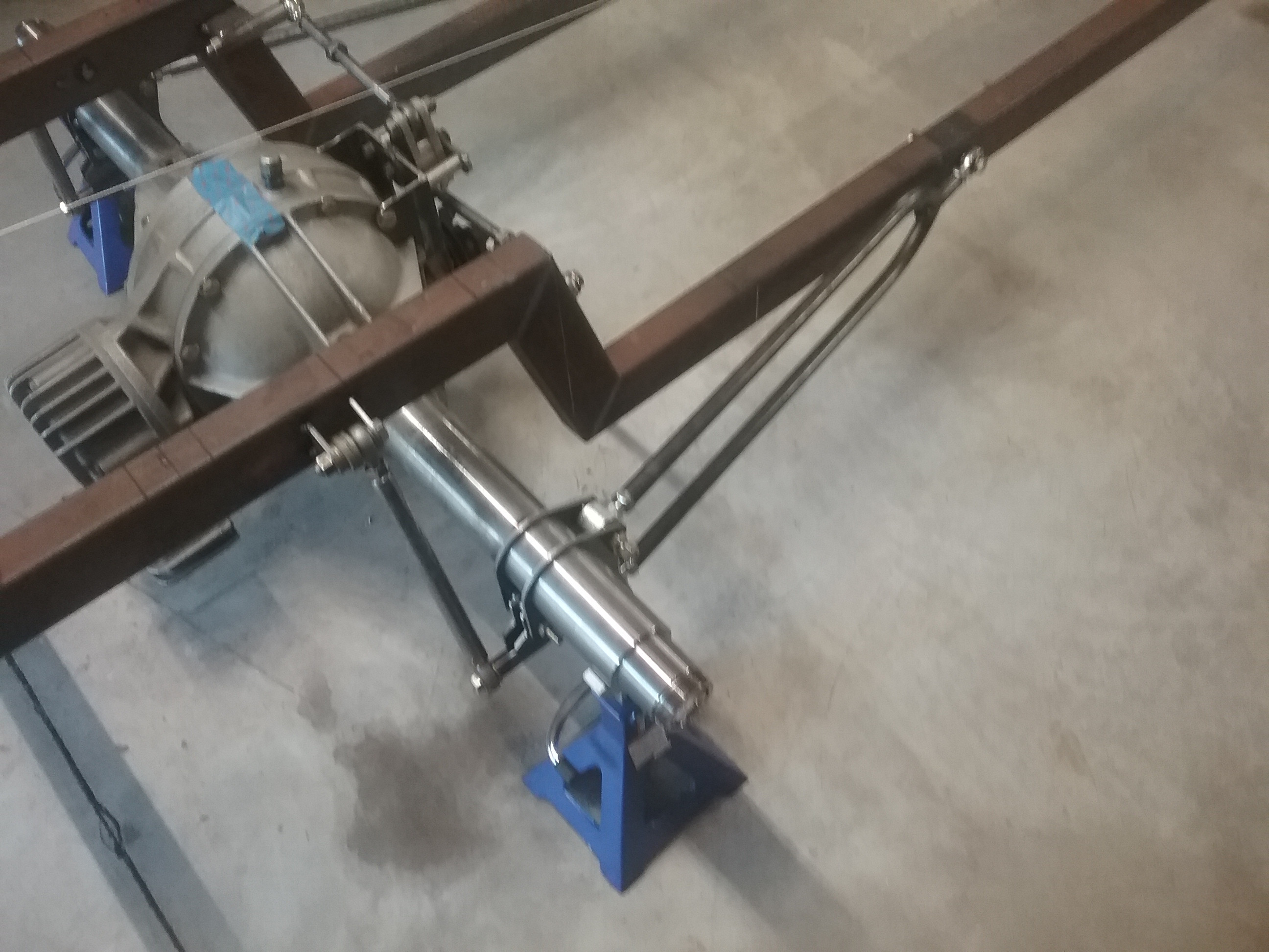

                    Ta da, its a short panhard rod.
                    I know, who cares, right? Well it replaces this:

                    Now one might say "BUT wait, a Watts link is better because it keeps the rear centered and the roll center is well defined", to which I say yes that is correct, but it's more links and bits and bobs to get in the way, and maintain. The main reason is interference with the planned t-bucket body. The back of the body curves down right there, so the panhard rod, with it's negatives became abetter choice from a packaging viewpoint. It could be longer, but then the bracketry would be heavier, and possibly in the way of something else not yet defined. So in the words of Colin Chapman, "Simplificate and make lighter".
                    In case someone noticed, the brackets on the rear axle for the radius rods were water jet cut forme by a machine shop in Glens Falls NY, to a CAD template (yes Dan strikes again, that's a cardboard aided design).

                    Click image for larger version  Name:	20200926_132007.jpg Views:	46 Size:	819.9 KB ID:	1288558
                    Here's the right side with a temporary link to set ride height. This all replaces this:
                    Click image for larger version  Name:	IMG_1112.JPG Views:	47 Size:	1.32 MB ID:	1288559
                    If you look closely at the stuff hangingoff the axle you'll see a pair of aluminum swing arms sandwiching a 3rd hunk of aluminum, which clamps around the axle tube to locate the 2 arms. The 2 rods, 1 going forward low, the other rearward high, form another Watts linkage tolocate the axle front to rear. With the since replaced side to side Watts link, I was getting way too involved for a hot rod suspension system. With this setup I still had to attach the coil overs or shocks and trailer bars (more on those in a little bit), and a torque arm of some sort to keep the axle from just spinning. Now this setup would have been well defined in terms of instant centers, but can you imagine the complexity and upkeep? Hence all the simplificating...
