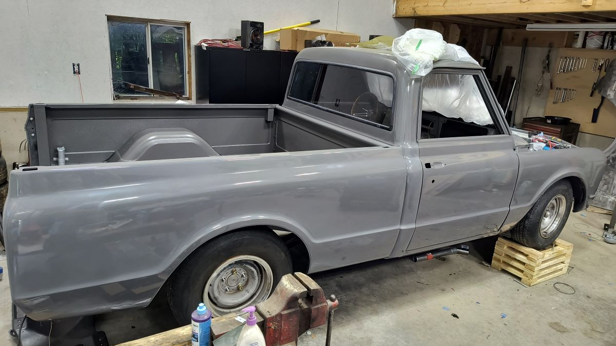

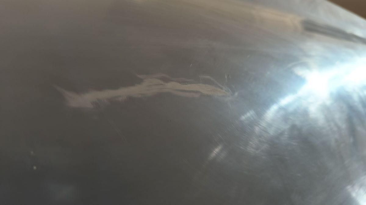

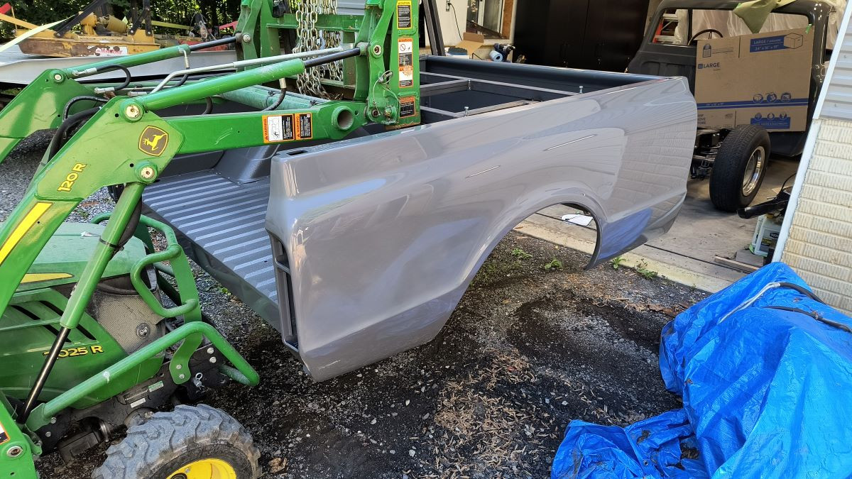

      Shiny! Looks great from my house. I bet it will buff out and everyone will think it's a mirror.
      nice
      Thanks guys.
      A little scrape, a little sand, and very little rough buff.
      I still need to spray the bedliner before slinging too much compound.
      It'll get there.

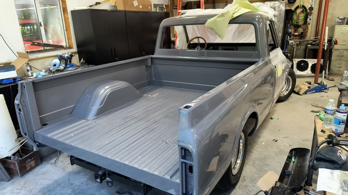

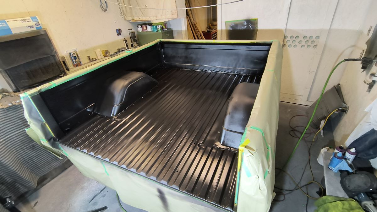

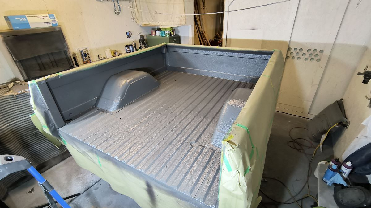

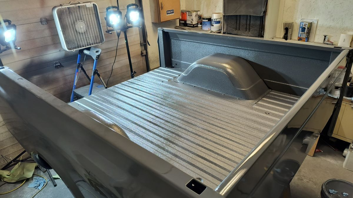

        First time doing spray in bedliner. Not a hard process, but a lot of angles to cover.
        Not to mention material refill and exit strategy. Turned out OK...good enough for my junkyard toy, next one will be better.

          I had the local LineX guys do my bed and must admit it's fantastic.
          • Captain
            • Nov 2019
            • 3126
            #200
            On the Mad Max Sammy, used it extensively.
            But used the Rattle Can method. And even as "Thick" as it looks out of the can, it will "RUN" like any another spray paint. One trick is to Spray From a further distance away and do a better job of Masking Off areas you don't want coated......
            Like your shop floor !
              • 28463
              #201

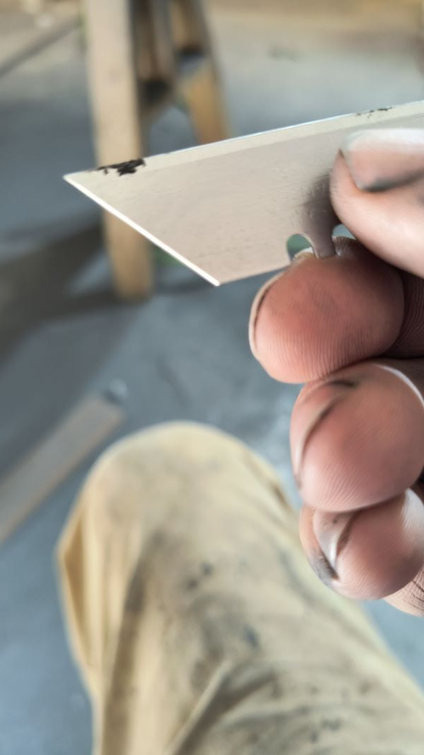

              That actually isn't bad at all! I use a razor blade holder thingie that works sort of like a plane so you can cut the tops off the runs which greatly simplifies block sanding. Wet sand carefully and always with a block then buff and it'll look great.

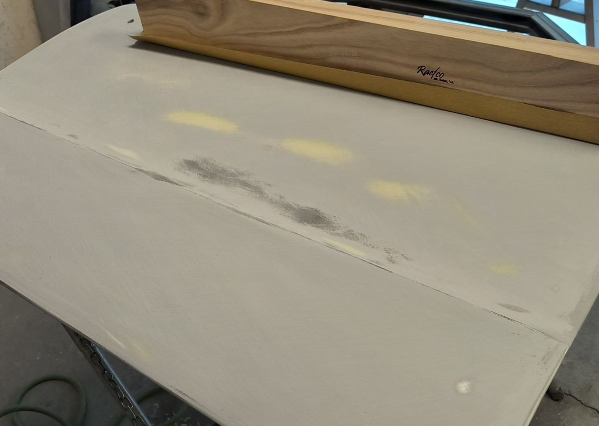

                  There's nothing like a guide coat and a "long block" to smash your hopes and dreams.
                  The tailgate is slightly worse, but I knew that. This door and the tailgate have had some serious abuse in in their 55 years of service.
                  I had to change shirts already at 0930. Ugh, I'm too old and fat for this sh**
                  Yes that block is a hunk of poplar, and yes, it is planed perfectly straight :-)

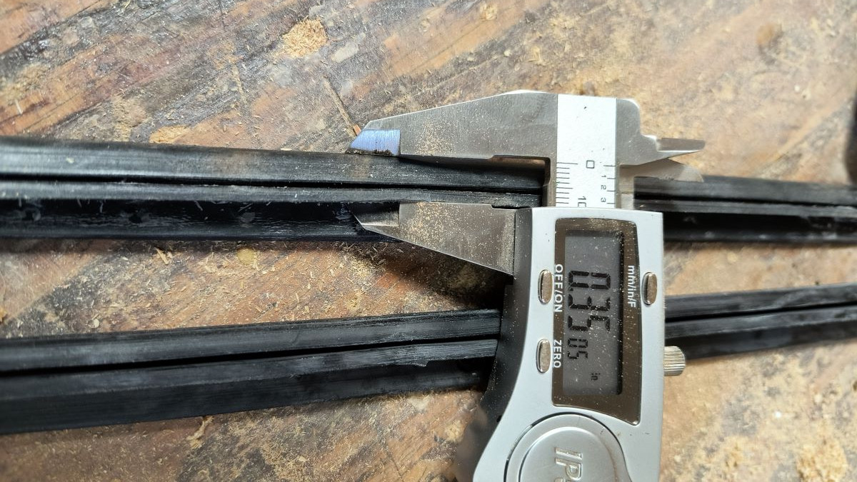

                          I rebuilt the vent windows for the second time. The rubber seals were made wrong on the first set.
                          the glass wouldn't close (latch). I broke both latch assys messing with it. I ordered another set of seals out of desperation.
                          Low and behold, the new set worked. GRRRRRR

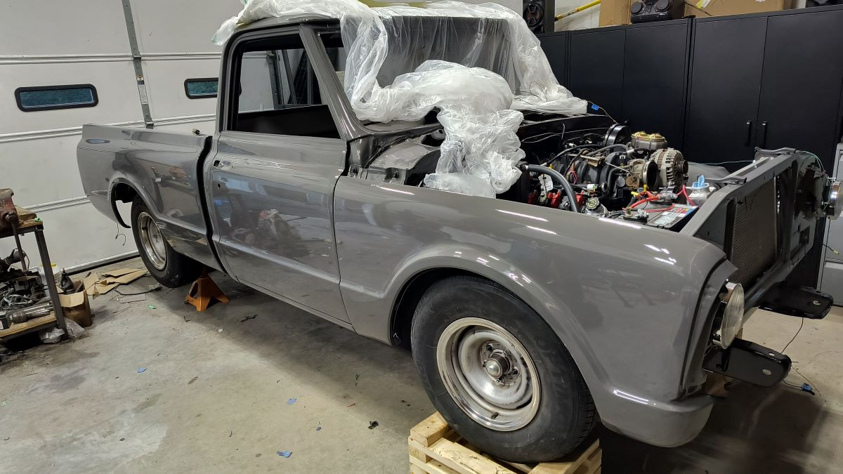

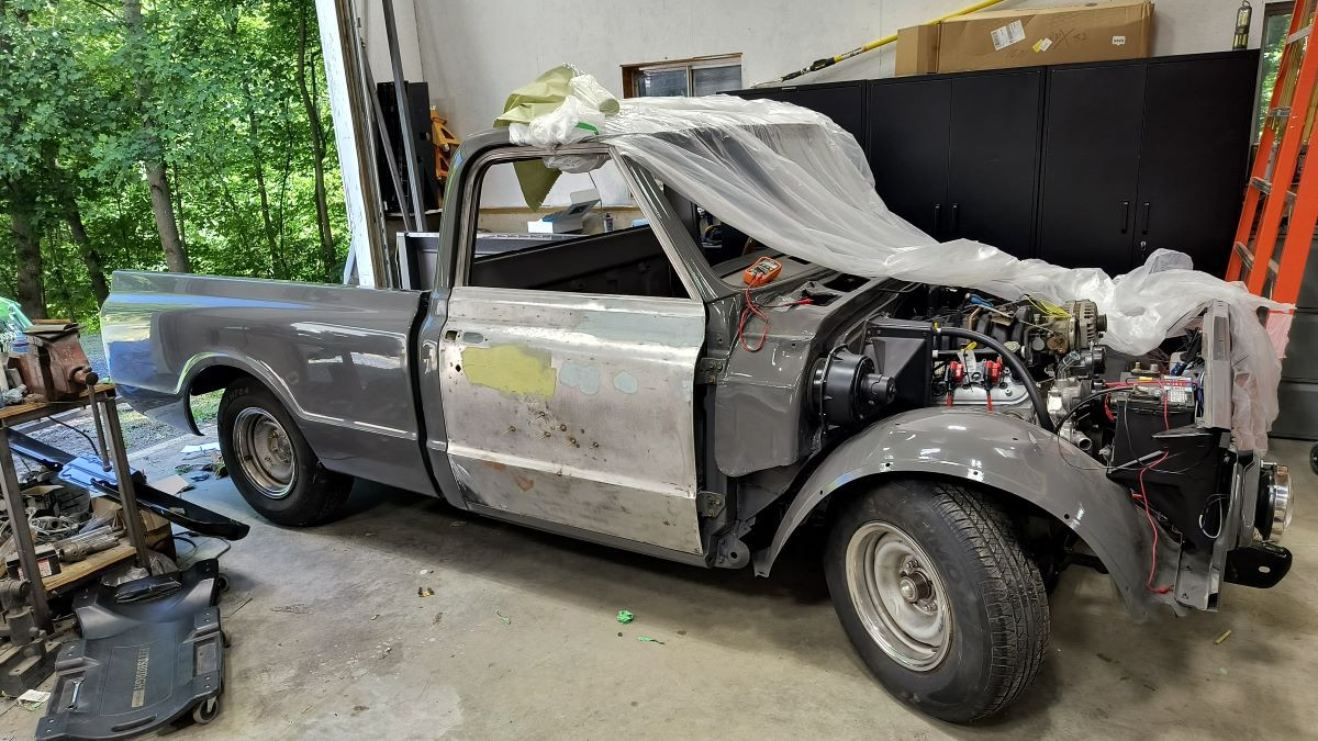

                            Finally starting to look like a truck.
                            I fired it up for the initial time. No radiator so just a quick 20 seconds or so YAY!
                            It did smell very RICH tho.

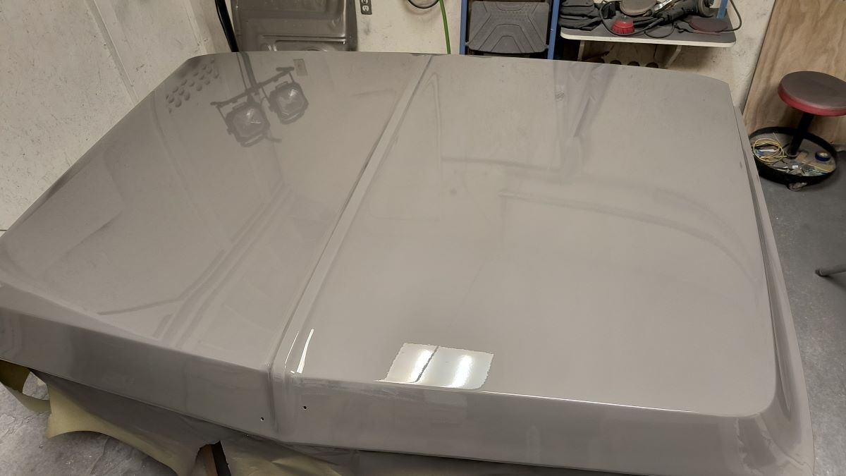

                                This hood is finally starting to look a bit better.
                                Good enough for a driver....and to make my pile of parts just a little smaller

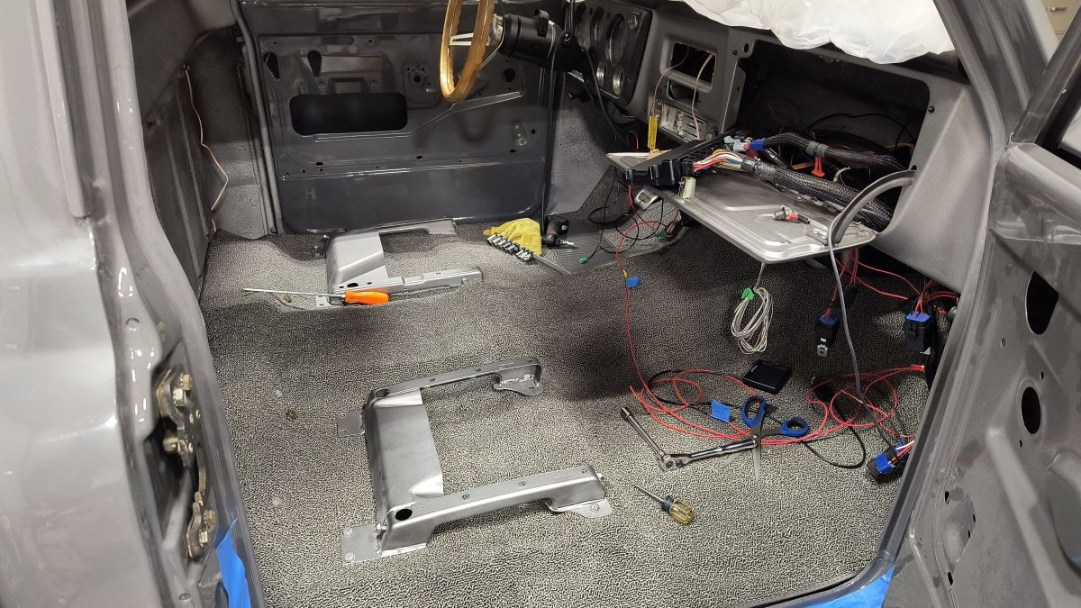

                                I'm missing some door hardware, so while waiting on paint to dry and parts to show up, time for interior sorting.
