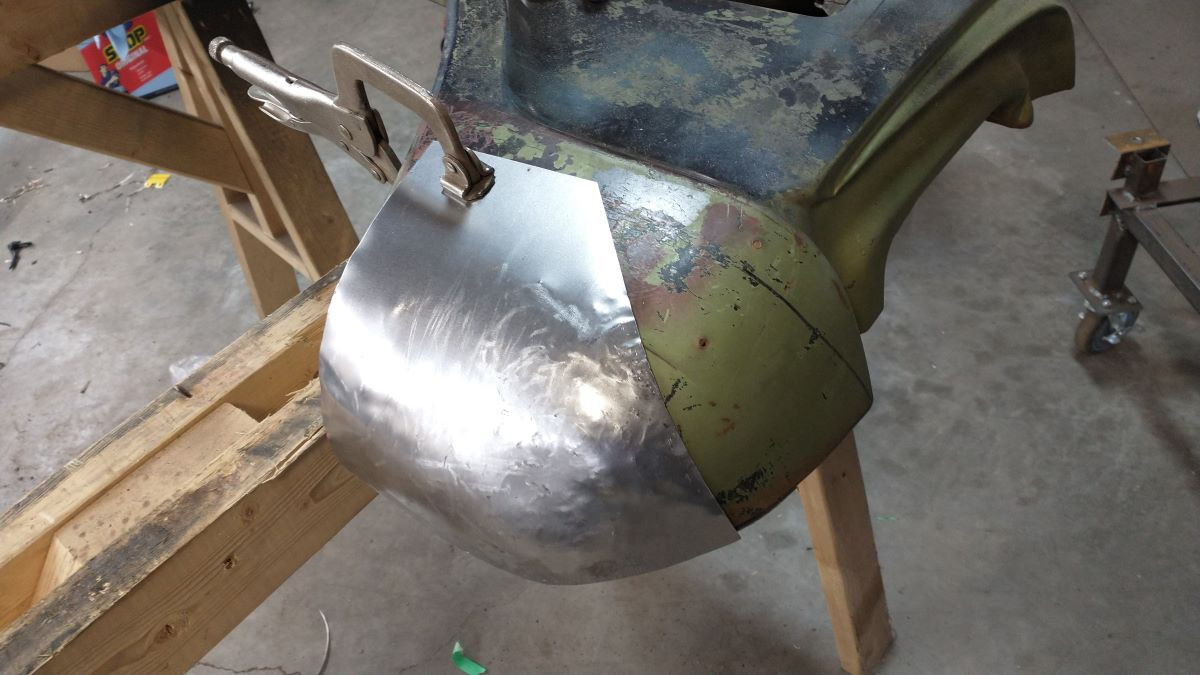

        I thought of buying those from Eastwood but the I found out that they don't come with an operator. I 'spose I could learn......
        You don't fool me Dan the body man.
        I have a cheap edge shrinker form Harbor Freight. I need something with more reach.
        I did get templates made and a couple simple parts roughed in.
        The rest will have to wait until I can make a shrinking block or stump..... next week I hope.

        This side is more of a trick.
        I'll try it in one piece.
        I'm out of practice, so I'll cheat if I need to :-)

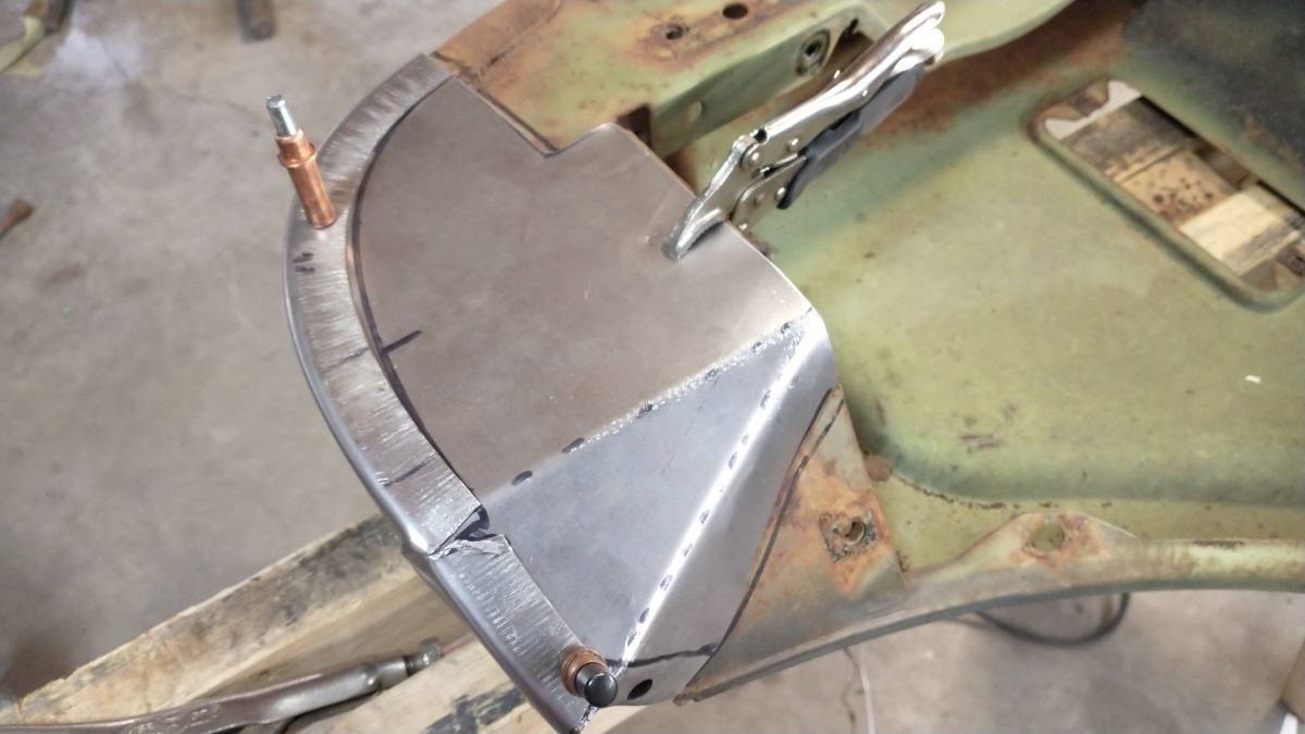

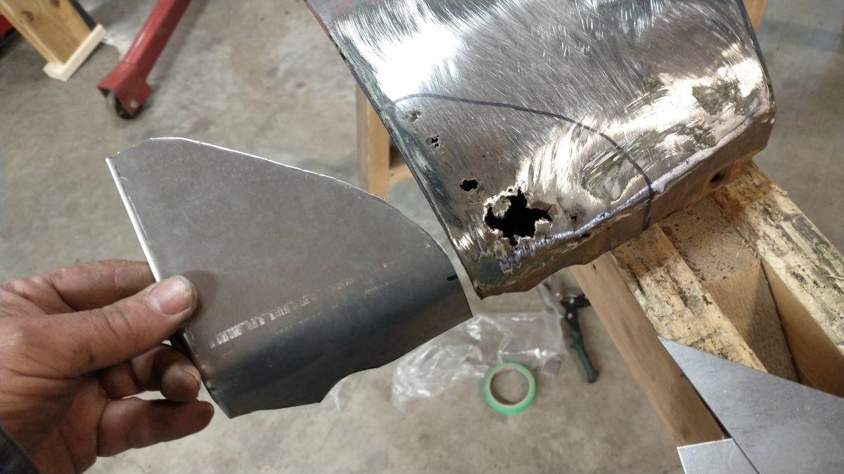

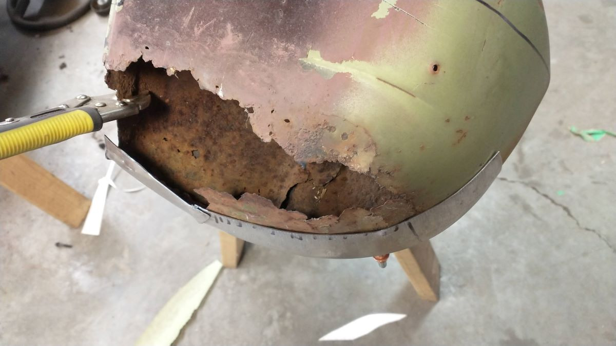

              After a few hideous fails, I decided to go ahead and make a shrinking fixture from 2x8's. Not my idea, I found it online.
              The piece for the outside front came out of the scrap pile and may be a little short, but this is only a test.
              Tonight, I will start roughing in the driver's side.
              note the fit on the "new fender". The grill fitment was even worse. So much for saving time.
              tools used on the curved part are shears, ballpeen hammer, shrinking fixture, and Harbor Freight English wheel (only to smooth the hammer blows).
              Click image for larger version  Name:	IMG_20220421_105511993.jpg Views:	0 Size:	161.0 KB ID:	1317956
              Click image for larger version  Name:	IMG_20220421_125115647.jpg Views:	0 Size:	164.8 KB ID:	1317957
              Click image for larger version  Name:	IMG_20220419_144815940.jpg Views:	0 Size:	168.2 KB ID:	1317959
              Click image for larger version  Name:	IMG_20220421_125823429.jpg Views:	0 Size:	117.1 KB ID:	1317958

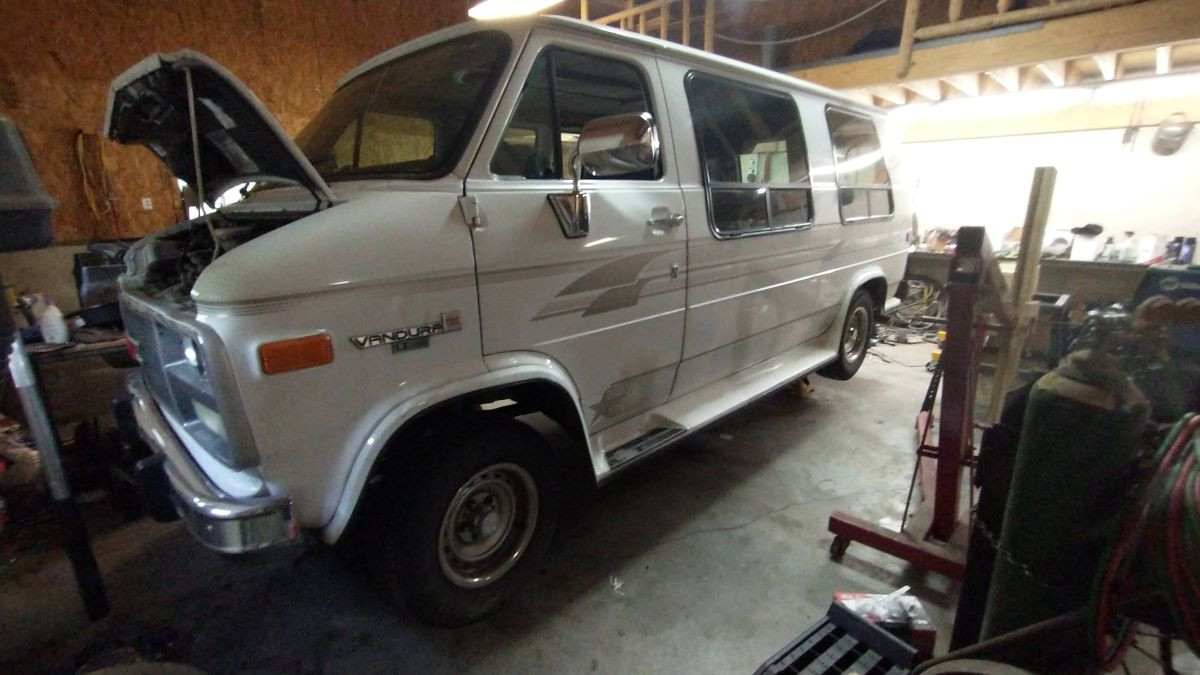

                No c-10 progress, but the road warrior GMC van failed a pre-flight inspection.
                It was bleeding antifreeze from the transmission dust cover.
                Lucky for me, it was just a $0.99 part
                I need to have it ready to for a road trip by Sunday
