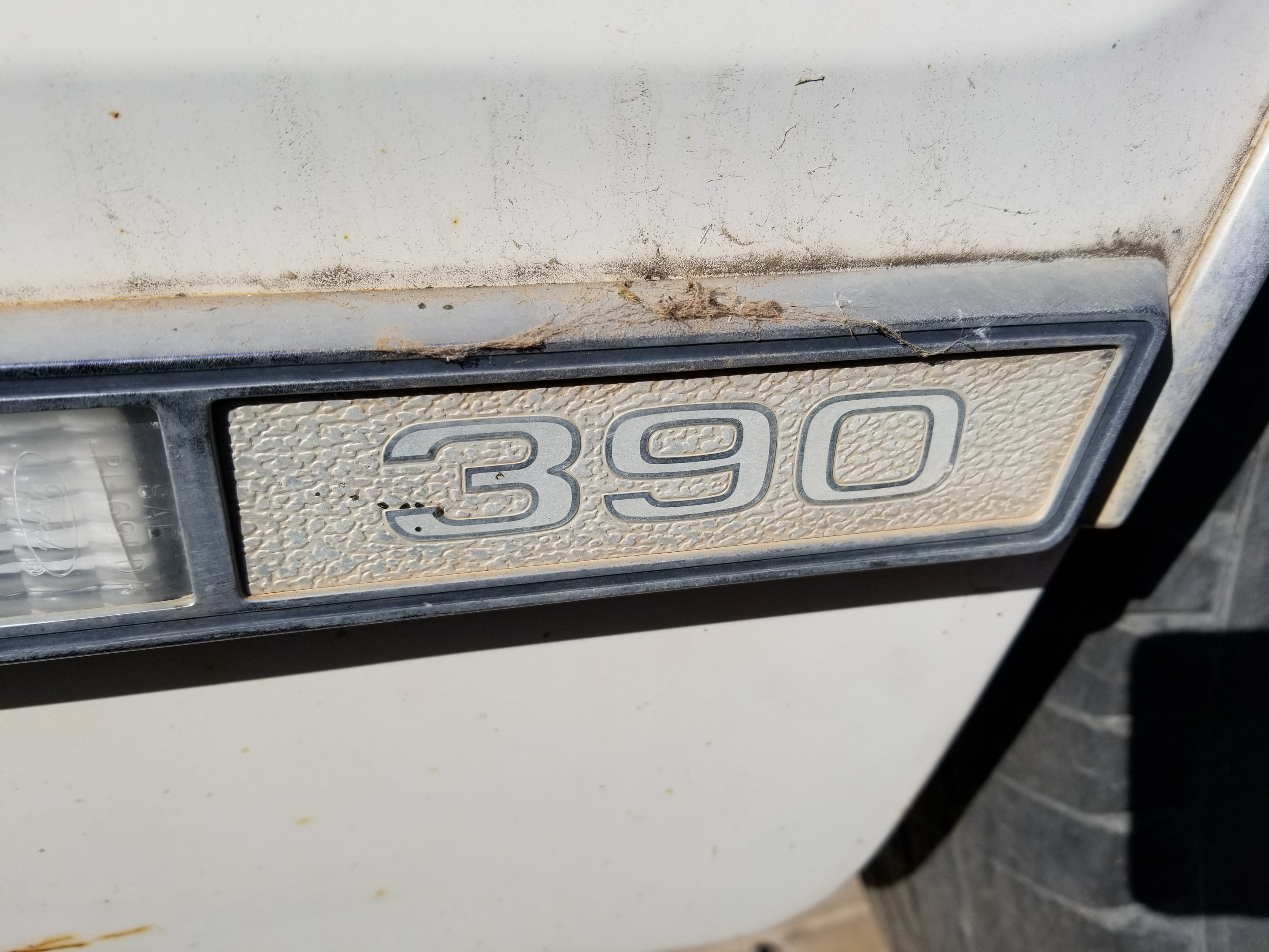

    Judd has been on the lookout for a project car he can truly call his own. Well, yesterday he found it. It's a 1969 Galaxie 500 Sportsroof. It is a 390/C6 car with power steering and power disc brakes. It doesn't run and needs work, but it was cheap. It was last on the road in 2002. These cars could be had with a 429, so a 460 swap is just a set of motor mounts away.
    These cars have never really been on my radar. The Sportsroof consists of a recessed rear window with sail panels that is very similar to a 68-70 Charger. Chassis-wise they are very simple. Body on frame with a 3-link coil-sprung 9" in back.
    Click image for larger version  Name:	20211204_170136.jpg Views:	246 Size:	1.27 MB ID:	1310188Click image for larger version  Name:	20211204_150108.jpg Views:	239 Size:	1.08 MB ID:	1310189Click image for larger version  Name:	20211204_150032.jpg Views:	237 Size:	1.50 MB ID:	1310190Click image for larger version  Name:	20211204_150003.jpg Views:	241 Size:	1.40 MB ID:	1310191Click image for larger version  Name:	20211204_144455.jpg Views:	242 Size:	1.32 MB ID:	1310192

              He paid $1300, so it was dirt cheap. It has a couple of dings and a couple of small rust spots, but it is definitely a solid car.
              It seems big, but really is only 4" longer than a B-body Dodge like a Super Bee or Charger.

                    Check frame welds. Many many were miswelded.. flux instead of filler.
                    nobody derbys these from 65-71-2 due to that

                          Heads up ......
                          The "Round Bell C6 off the FE 390"
                          WILL NOT bolt up to a 460.
                          ALSO check, that C6 uses "Type F" trans fluid.
                          • fatguyzinc
                            • Oct 2015
                            • 2543
                            Heads up ......
                            The "Round Bell C6 off the FE 390"S TRANSMISSION
                            fixed it for you.... and you are right.
                            pretty sure the 'fix' is a matching
                            460/toploader swap....

                              The real fix is the 460 and C6 that are sitting in my shop..
