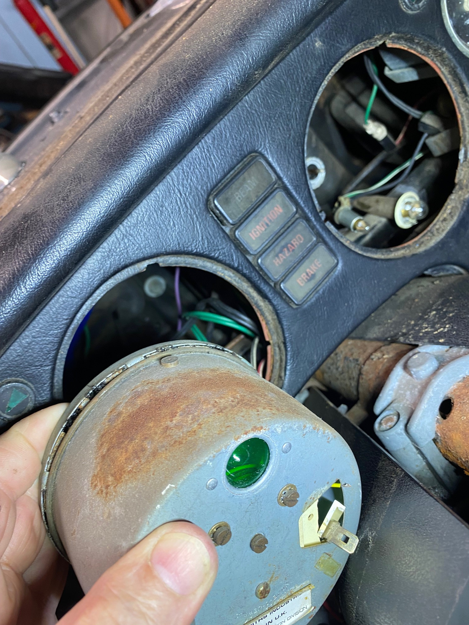

      How the tach and speedo come out on the later model MGBs. You just reach up under the dash and turn the gauge about 1/3 of a turn until you can't turn it any more and they push right out. Note the bumps on the gauge and the small notches in the dash - line 'em up and they come out. Good thing it's fairly easy as the gauges have to come out to provide access to the dash to do pretty much anything back there.

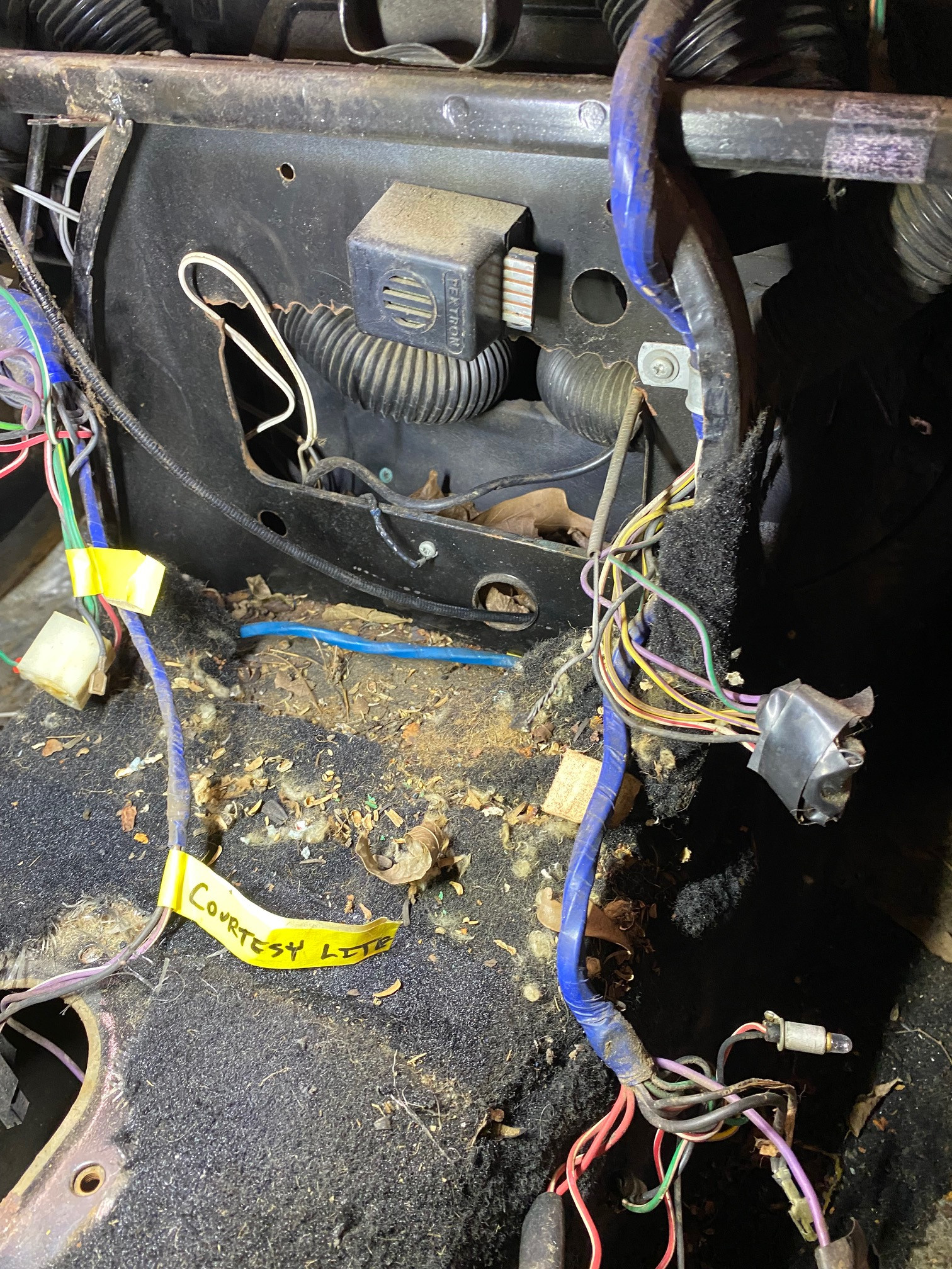

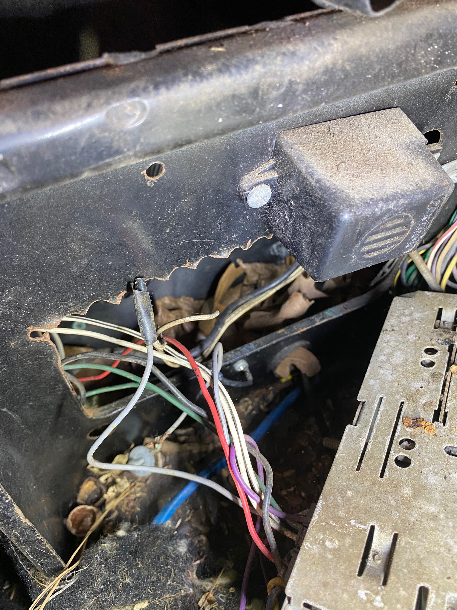

          And on to today's progress. It was a bit more stubborn than anticipated but I did get the dash and center stack out of there. Interesting that once I got back in this far it looks pretty much exactly like my '64. Evidently things at Morris Garages didn't change much.
          Proof that the wiring was a rat's nest - both literally and figuratively. This was behind the poorly-installed aftermarket radio.
          And......

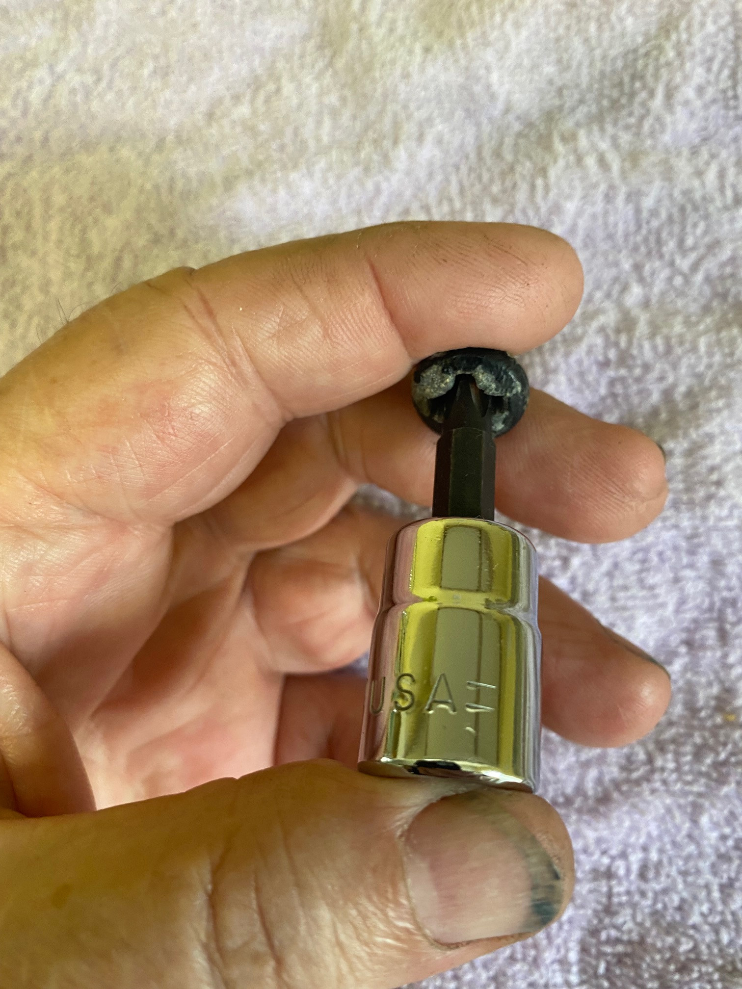

                        Turns out those screws aren't actually Phillips, they're Posidriv. Nobody in town had a number 4 Posidriv so I called the English car guy here in town and he suggested that I grind the tip off a number 4 Phillips which, while not perfect, will work. So I gave it a try and sure enough it did the deed. However, my trusty old impact driver didn't move them. In frustration I put the bit on my impact gun, leaned into it with all my weight, and hit the trigger. Worked perfectly and quickly, too! I took all 16 screws out in a couple of minutes.
                        Here's the rig:
                        Click image for larger version  Name:	IMG_1342.jpg Views:	0 Size:	812.0 KB ID:	1325313

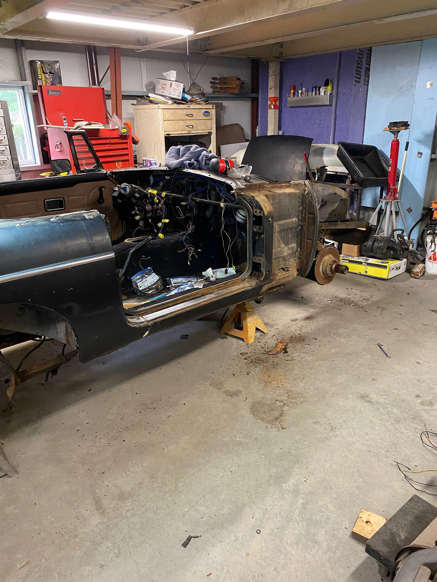

                        Pulled the door:
                        Click image for larger version  Name:	IMG_1343.jpg Views:	0 Size:	967.3 KB ID:	1325314
                        And the wing and door (I wonder why the Brits don't have some weird name for a door) on the left:
                        Click image for larger version  Name:	IMG_1344.jpg Views:	0 Size:	1.06 MB ID:	1325315

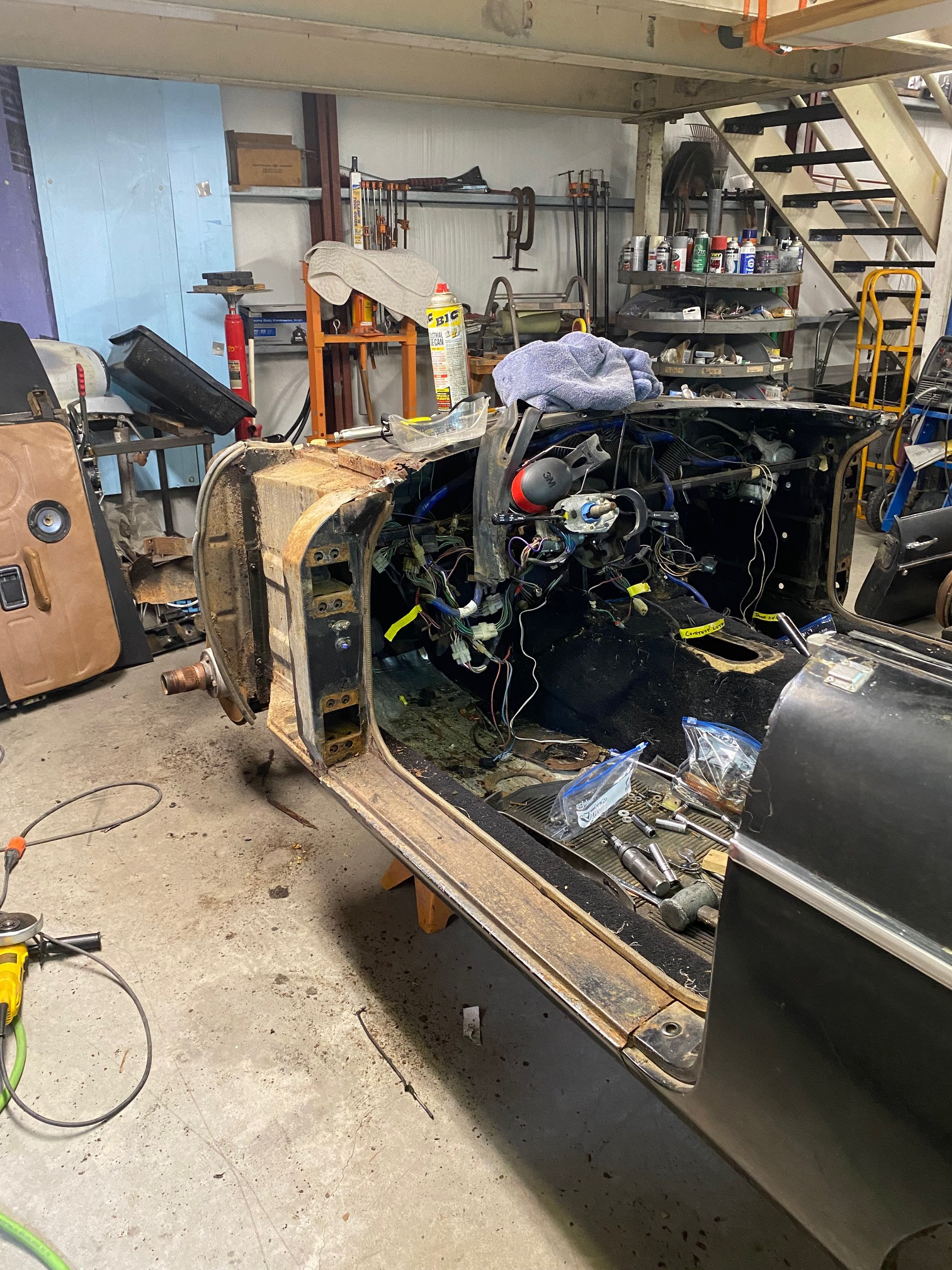

                        Then I started bracing the body so it'll be stable as I take the structure out of it. This side got the leftover bits of roll cage tubing I had lying around but I might have to buy some stock for the left side. There will be one more tube but this is where I left it tonight. Note that I made it bolt into existing boltholes rather than weld the braces in. Maybe this will rove to be a mistake?
                        Click image for larger version  Name:	IMG_1345.jpg Views:	0 Size:	995.4 KB ID:	1325316

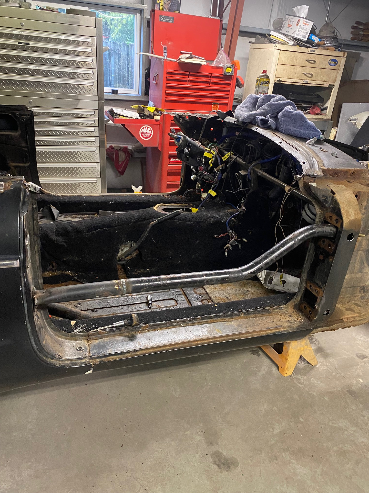

                              • Guerreri's First Law of Automotive Fabrication:
                                "Any job worth doing is worth overdoing"
                                Click image for larger version  Name:	IMG_1350.jpg Views:	0 Size:	953.6 KB ID:	1325442
                                Disclaimer: I didn't actually design this. It's what happens when you have leftover pieces of roll cage, some with bends. And then I figured "I COULD......"
