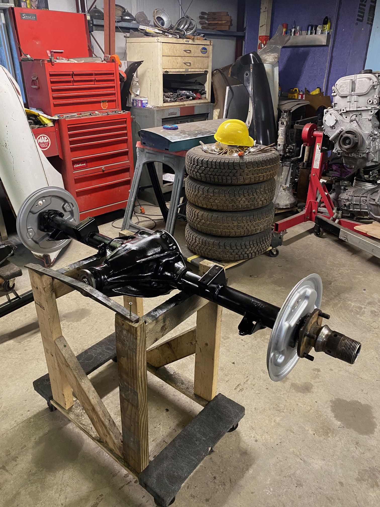

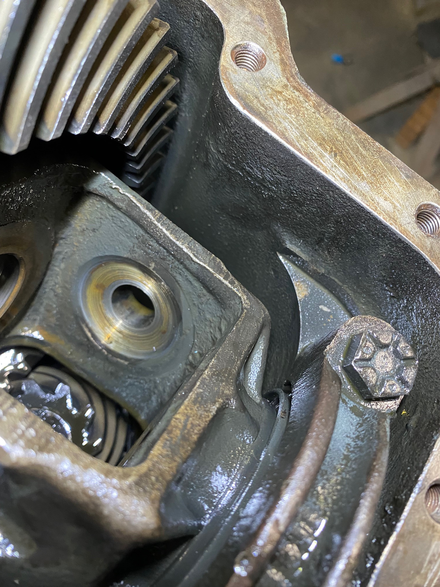

    Back on the rear end. It turns out that the first one I got had excessive backlash - should have checked it before I took it home. This turns out to be fairly common issue caused by wear in the washers that space the spider gears in the diff. The washers are available so I ordered up a set but when I went to install said washers I found that one of the spider gear seats was galled. The guy I got the rear ens from is way more than decent so he simply handed me another rear which is nice and tight. The galled spider gear seat:
    Click image for larger version  Name:	IMG_1757.jpg Views:	0 Size:	954.2 KB ID:	1334827
    So now I had a second rear to clean and paint which I did. Again, stripping wheels to the rescue then a wire wheel cup brush for the small areas that I couldn't get with the stripping wheel.
    Click image for larger version  Name:	IMG_1801.jpg Views:	0 Size:	1.02 MB ID:	1334828
    And:
    Click image for larger version  Name:	IMG_1803.jpg Views:	0 Size:	1,004.2 KB ID:	1334829
    Assemble and plumb the brakes and it's ready to install.

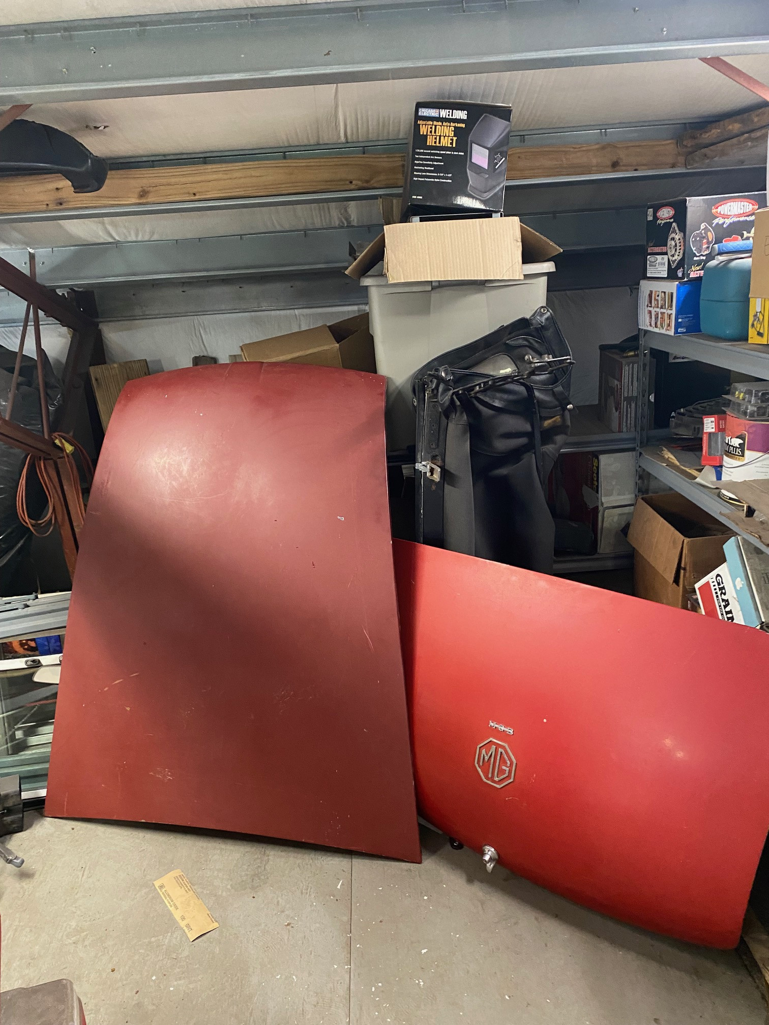

    I picked up parts near Charlotte this weekend. Same guy I got the rear end from - nice guy. So I brought home some odds and ends (he gave me two extra wire wheels so I now have a spare) and some sheet metal bits that I may or may not use but mostly I now have a rust-free hood (bonnet) and deck lid (boot lid, I think). I opted for a steel hood though he did have a couple of the early aluminum ones. He was attached to the alloy ones and had a stack of steel ones that weren't dear to him so I went that way. Note that the deck lid is the early type with the outline octagon and individual letters as opposed to the later ones that have a one-piece badge. I like the early style much better. So they're on the mezzanine waiting for me to get to them. The color match isn't good but I'll fix that.
